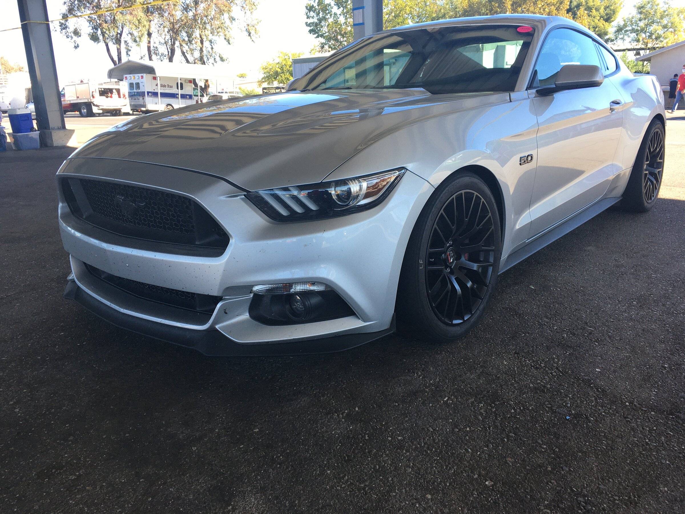

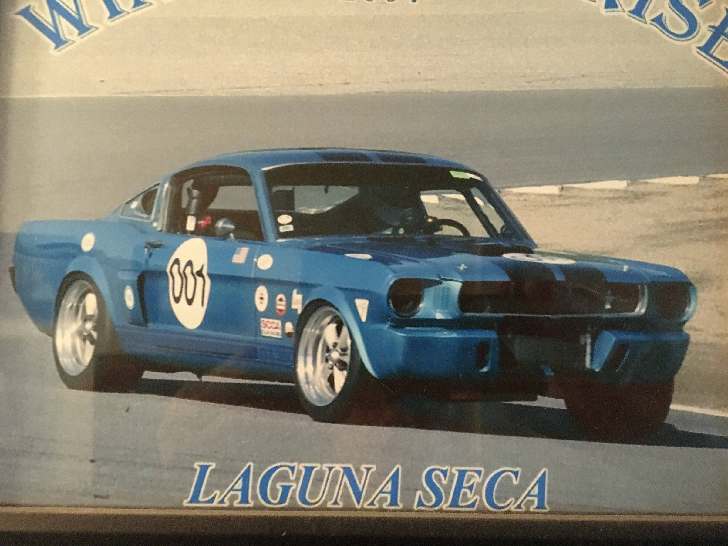

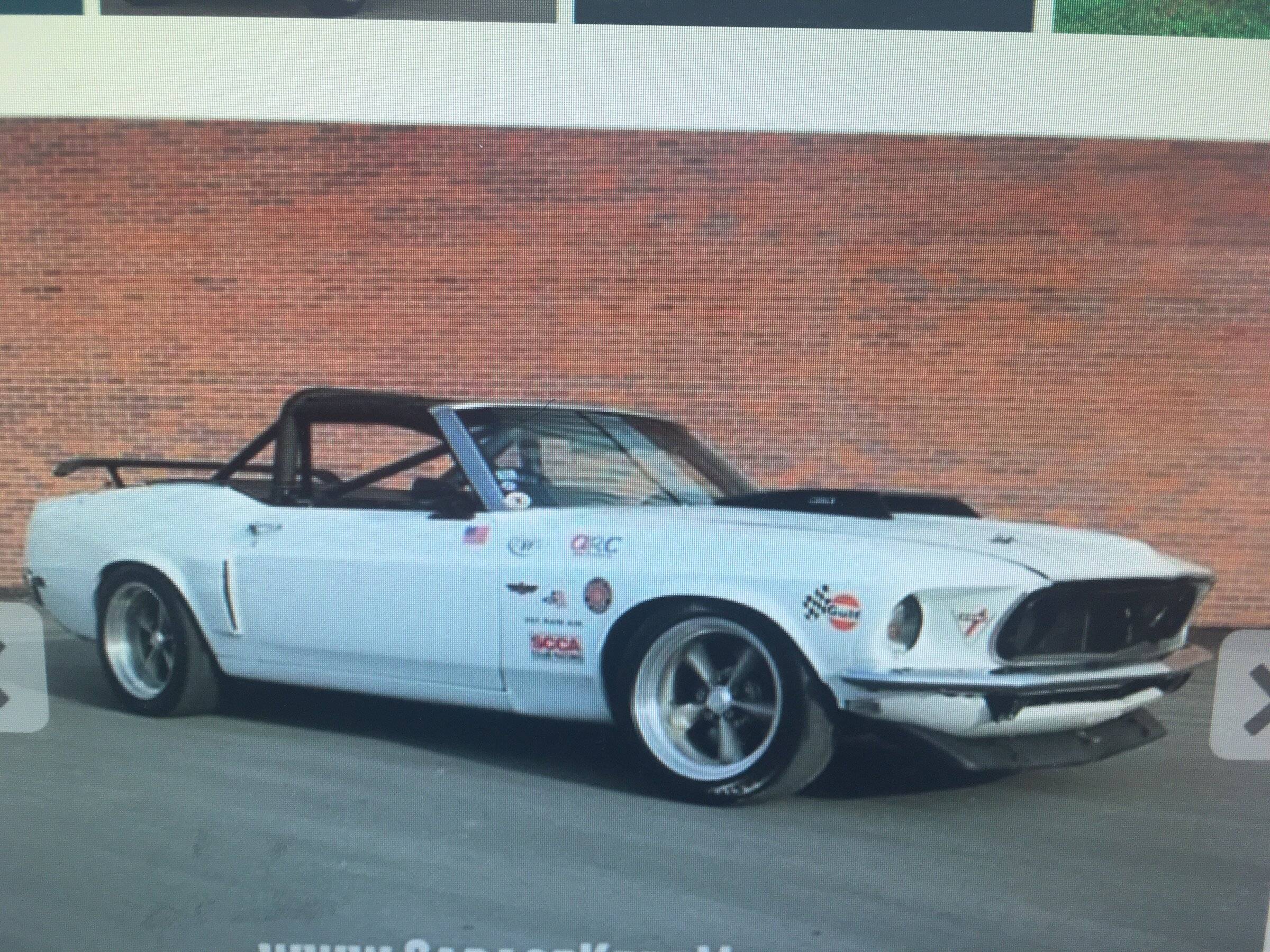

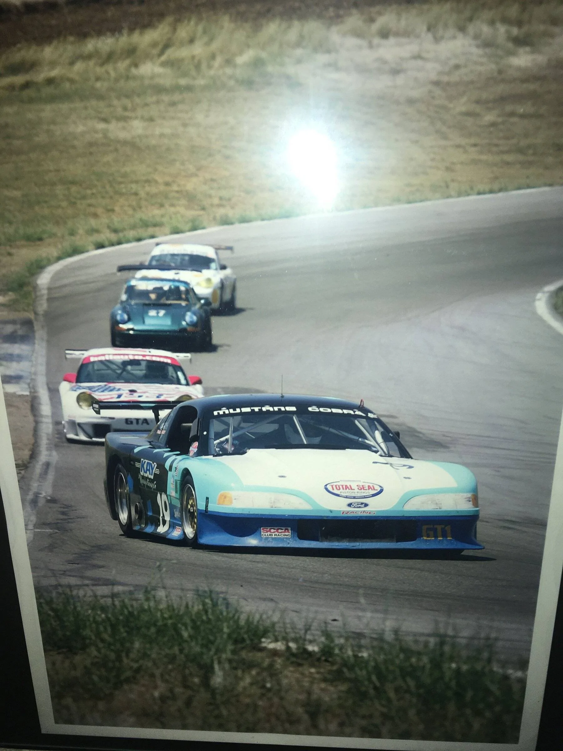

Below is a few of the Mustangs that i have raced or tracked
WCRookie99
Apr 5, 2021
56
611
1,101
Illinois
G
2021 Mach 1, 2007 FR500C, 2022 LH5
Frankly when it come to giving advices and making blankets statements regarding on track driving and track cars, background and experience matters so, why don’t you state them?
We all want new drivers to the hobby to be safe, that is a given but there is a huge difference in risks level and necessary car preparation between a novice doing track days and w2w racing
A base gt is totally fine for a beginner doing track days
As he progress and get faster, better pads, etc could be necessary, based on his speed
So, asking what your experience was didn’t seems to be out of line and in no ways did stating your qualifications was going to embarrass me
I have learned a long time ago that what get drivers in trouble the most is unchecked ego
ok
