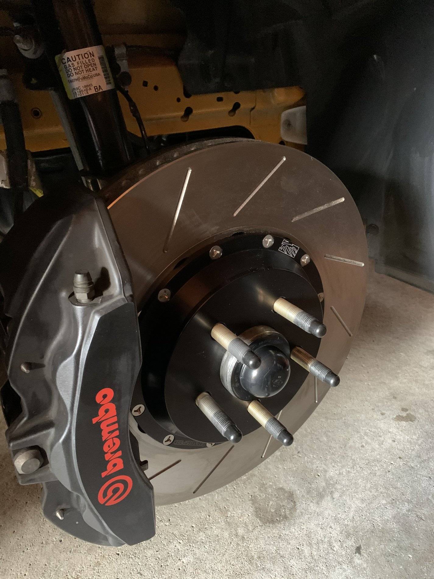

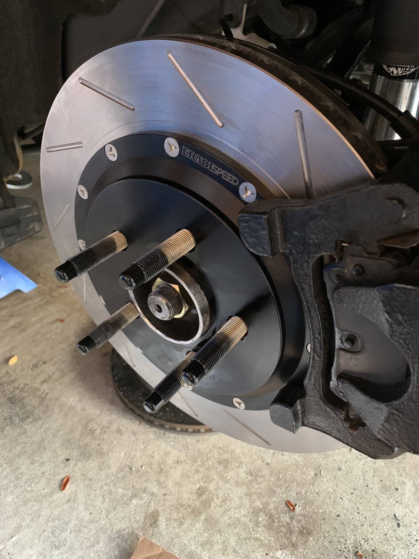

Are you still running these? I'm contemplating getting a full set of the rotors without the holes.
NastyPumpkin
Oct 13, 2018
300
259
Michigan
2018 Boosted Mustang GT
I have them, they are worth the money. The stock rotors are very heavy.
NastyPumpkin
Oct 13, 2018
300
259
Michigan
I purchased them through lethal performance. You can order them anyway you want - slotted, plain, drilled and slotted...
