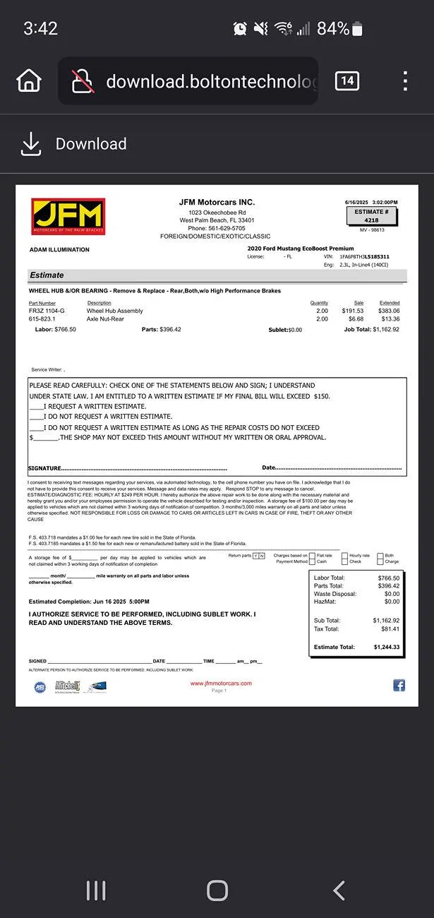

Here was what I was just Quoted for replacement of the rear bearings on my work car .
