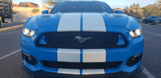

I have had my Winjet turn signals from CJ Pony Parts on for several weeks now, and they still work great. I check them every time I pull up behind somebody whose car is reflective enough to see them. They're the same price as the Opt7s but they work.
