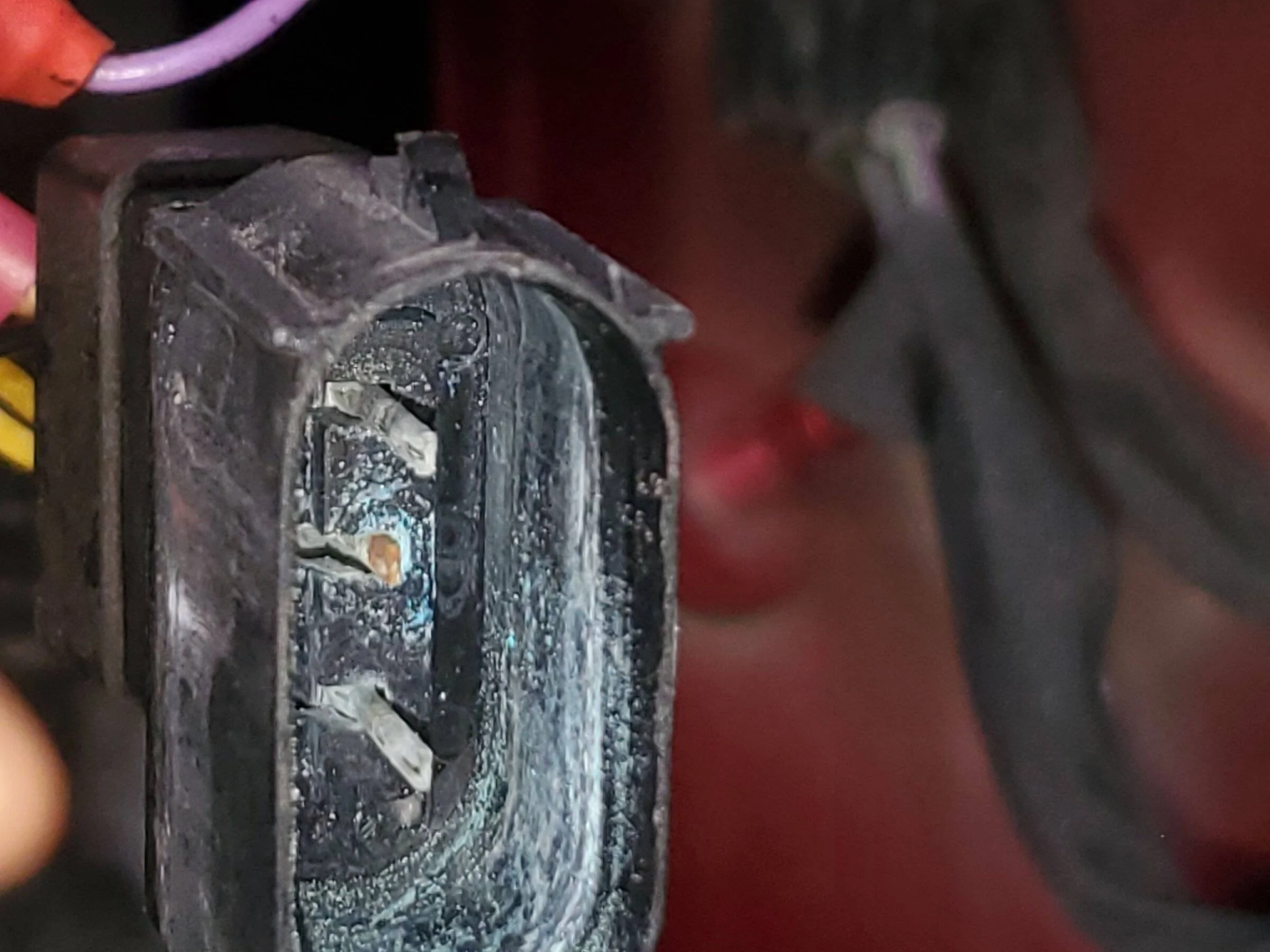

I got under the car to swap out the diode pack and found that it wasn't the diode pack but rather the connector that OPT used. It was completely corroded internally including the marker light pin being broken and missing...
Perhaps your connector is in similar condition but with a messed up turn signal or ground pin instead.

I’ll have to take another gander at the Opt7 connector and make sure all the pins look okay.
