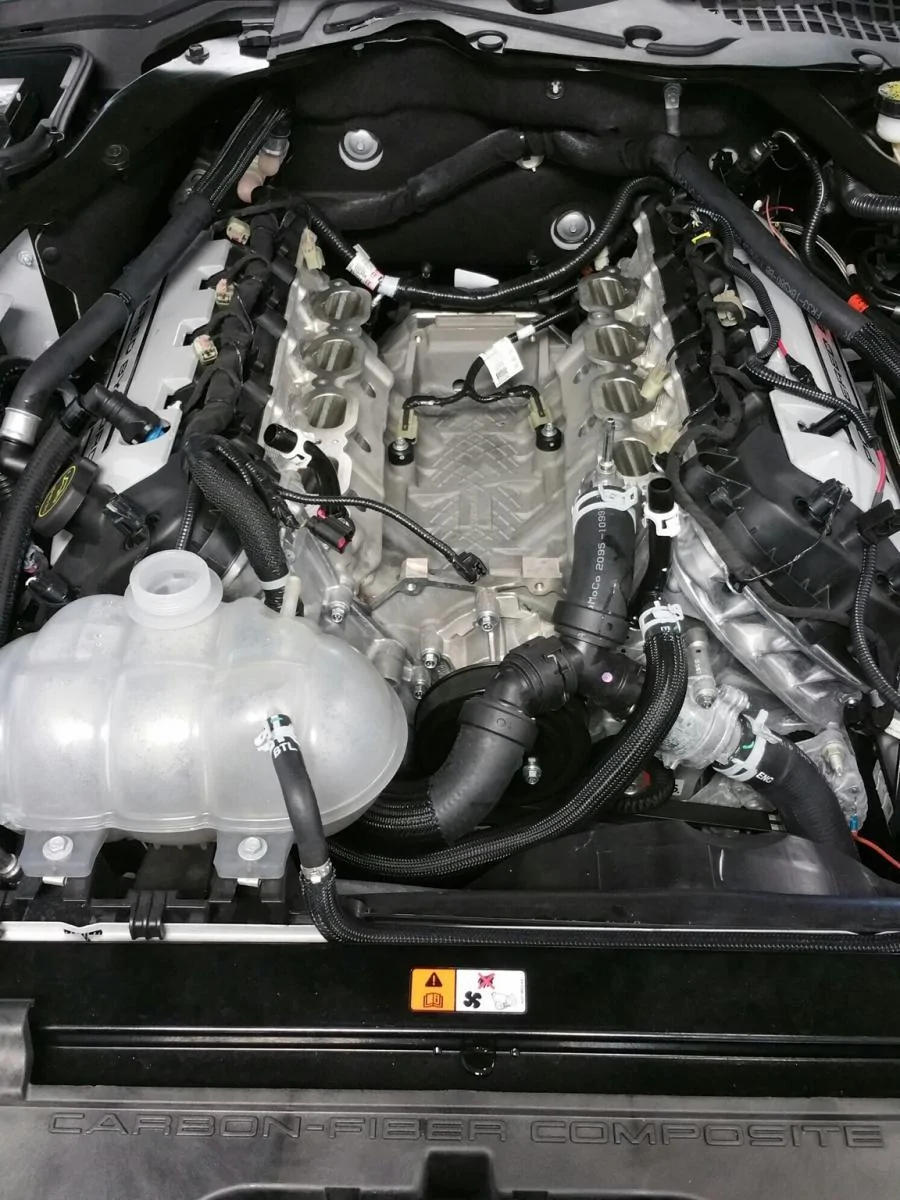

Looks like someone took a Dremel to the intake side. Is it supposed to look like that?

It's been awfully quite on the updates front. Any word on how you shoehorned that thing in with the OEM hood yet?
LethalPerformance
LethalPerformance
Sep 5, 2014
332
3,270
2,033
Fl
2020 Shelby GT500 CFTP, 2021 Whipple'd F150
This is all I've got so far. Been real busy and so has Power By the Hour who is performing the install.
