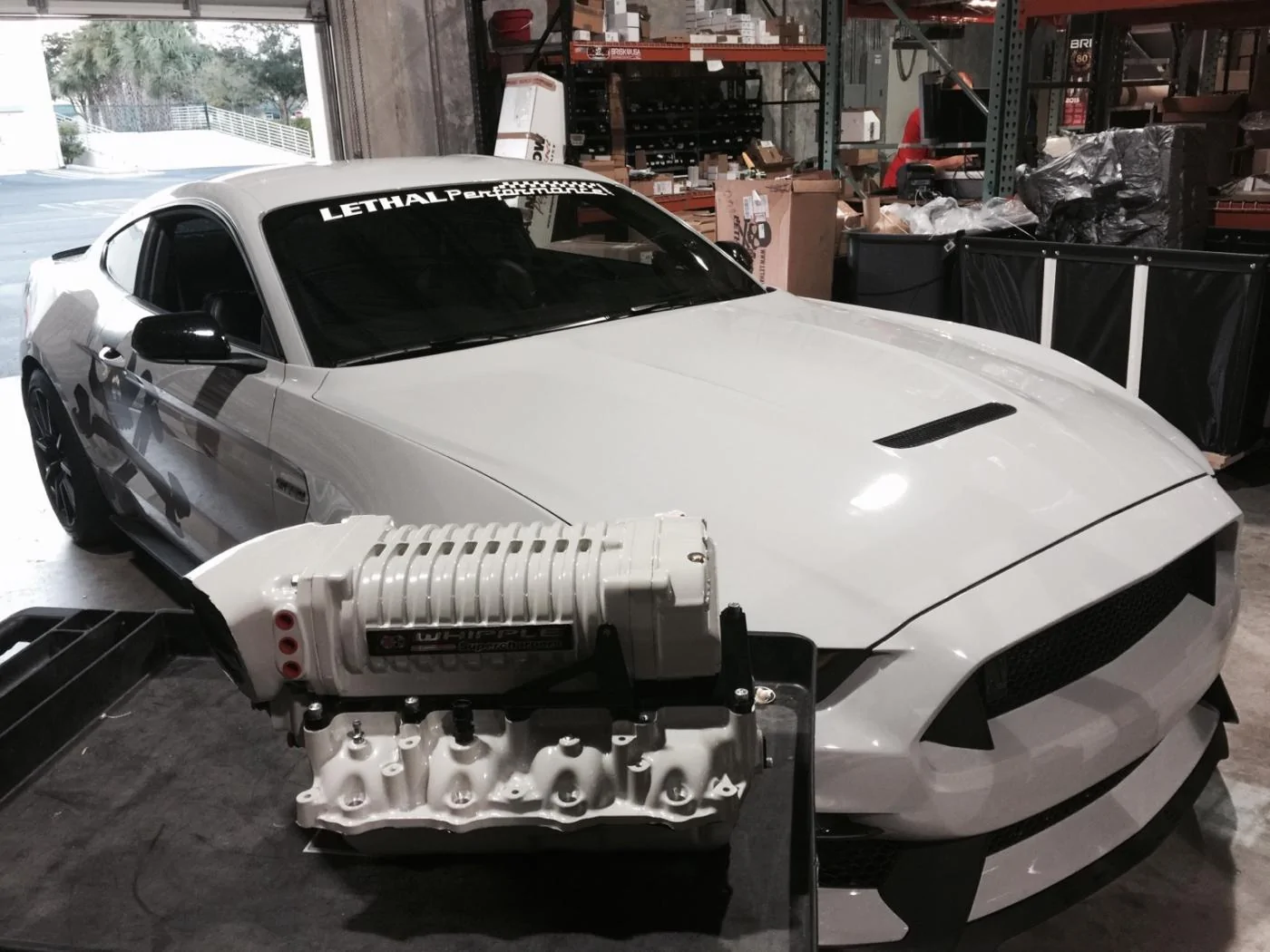

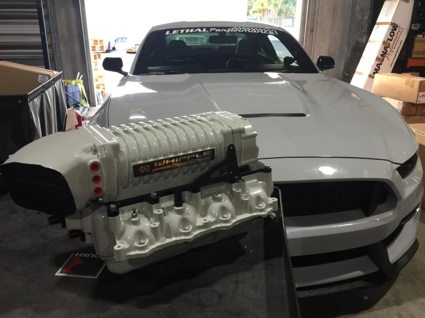

The bird has landed!!

Can't wait to see how you shoehorn that sucker in there ;) looks beautiful!!!!
