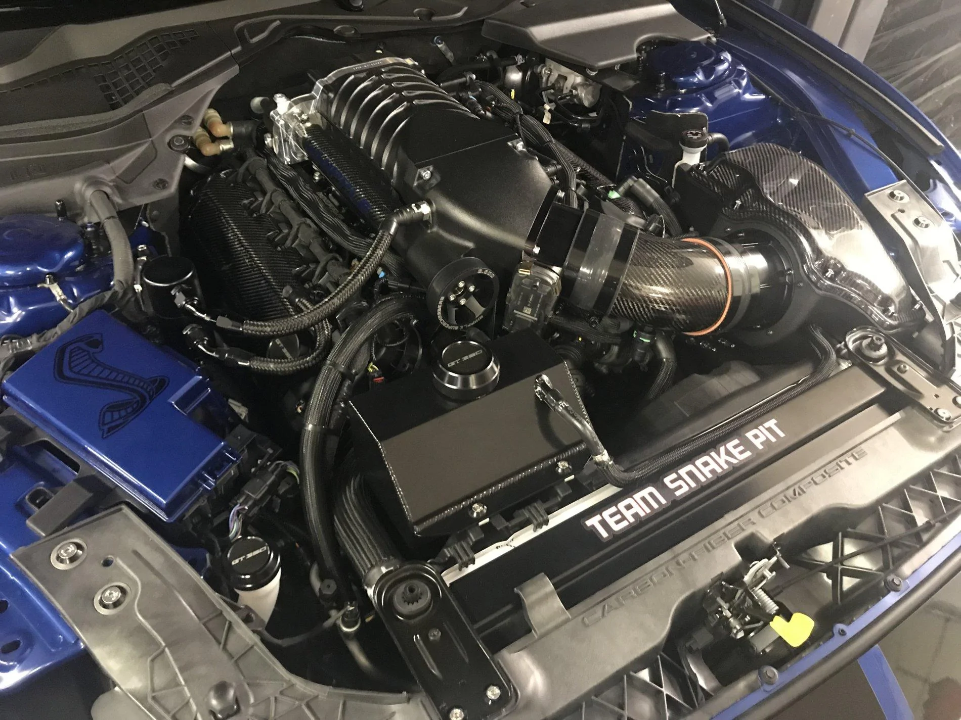

I have the Gen 3 2.9 Whipple w/3.5" upper on my 17 GT350 with E85 Lund tune and 1050 ID injectors with JMS BAP. Stock OPG/CG at the moment. Waiting on cams to become available from L&M for cams/OPG-CG install
I have the Bobs Autosport oil seperator on pass side only.
https://bobsmachine.com/product/2015-gt350-oil-separator-kit-pass-driver-side-ultimate-series/
