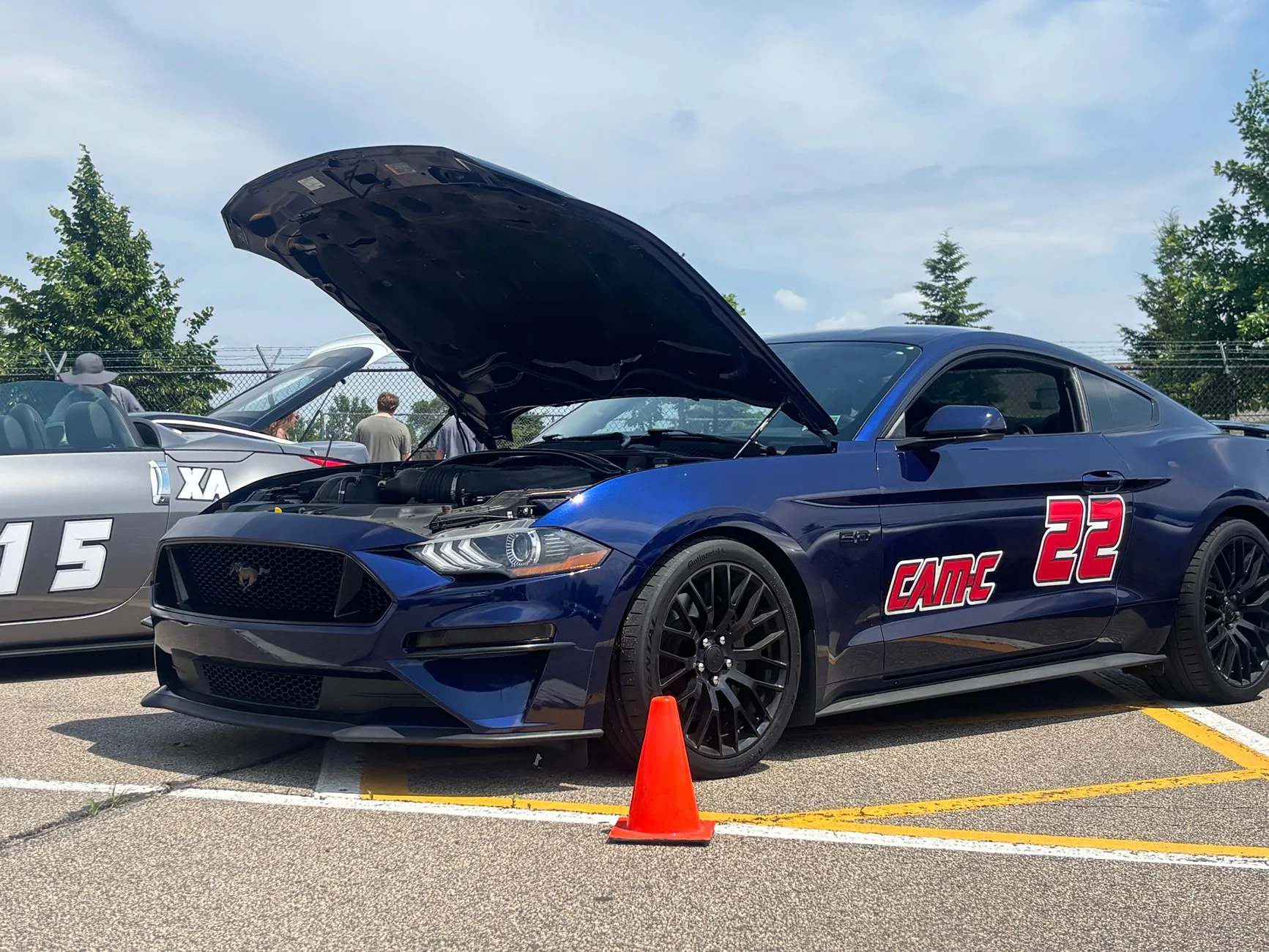

After a year of racing my '20 GT 10A in autox, I want to get more competitive. I placed 6 out of 8 in my class and 104 of 133 overall. I bought it lowered, the only other aftermarket mod seems to be an oil separator and a staggered tire setup (tires are 20" Contis with 340 treadwear). I've since added Steeda 20mm wheel spacers for the front in anticipation for a square setup. The car is my daily in the summer.
My wish list includes:
1. Square wheel setup
-19x11 wheels, 305/R35 19 tires, 200 treadware. Open to used options.
2. Adjustable camber plates
-either Steeda, MM or Vorshlag. I want the easiest to be able to make adjustments to at the track.
3. Optional: Stiffer sway bars
An instructor said I could improve my time by 4 seconds if I had dedicated track tires and camber plates. What else would help?
