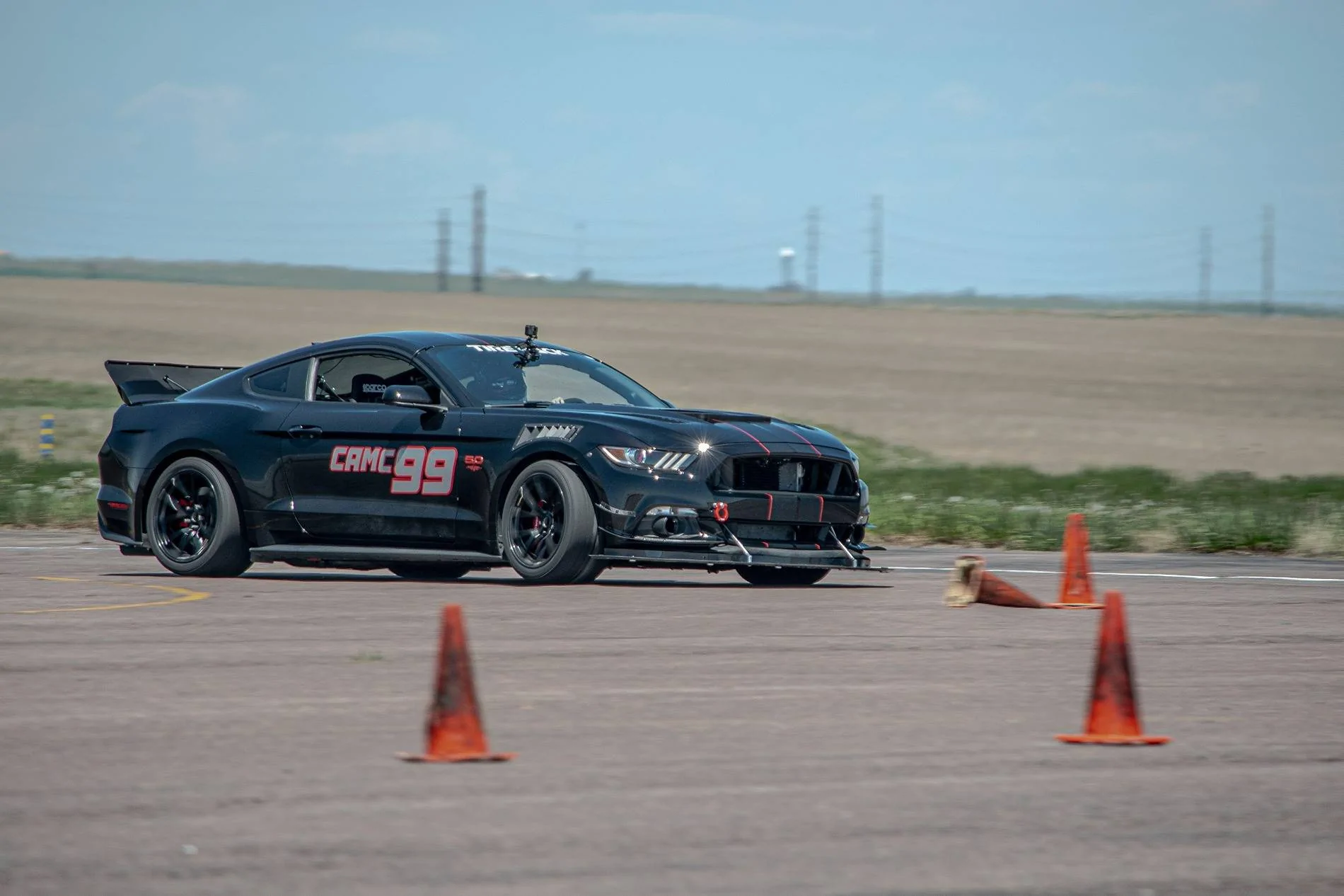

BTW, the rear spoiler is yours, but now extended to the max 10" the rules allow. And your reasoning is solid. My350R was beautiful, handled awesome, good power, and excellent gearing for auto-X. But the values kept climbing and the Gen1 voodoo's are not known for their durability so I decided to part ways with it. To be honest, I really miss it. It was without a doubt the nicest car I've ever owned, and probably ever will own. Think twice, maybe three time, before selling yours. It's beautiful.

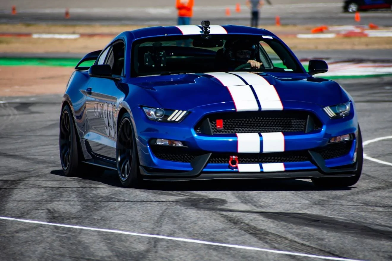

The first event of the 2025 season was a Rocky Mountain Solo Summer Event #1 at Pike Peak International Raceway. This was the 1st real event with all of the aero on it. I was running the 315 Yokes from last year with 60ish runs on them as well as some street miles. The day started out with rain and was cool in the 50's but as I was running 3rd heat I was lucky and got to run in the best conditions (mostly dry, 70ish degrees).
My friend Bob is the car/driver combo (2017 GT350) that finished 2nd in CAMC last season and is usually my closest competition. But on this day, another friend brought out a car that won the CAMC championship in 2023. Its a 2010 GT that is built very well as he is an excellent mechanic and owns his own shop. He also has a really sweet 1994 GT that he finished 2nd at Nats last year in CAMT. Bob and I knew Brandon was going to be the guy to beat.
The car felt good overall. The car had terminal understeer for most of the season last year as I had added the rear spoiler and diffuser early in the year. I had basically tuned around those components to mitigate the understeer. At least the understeer made me feel like the aero was working to some degree. Or at least that's what I told myself. Since I had added the AJ Hartman front splitter I had reversed one of the large changes I had made to reduce the understeer - setting the rear bar to full stiff. So it's now at full soft as is the front bar. Also, as per AJ's suggestion, I upped the front spring rate from 600 #'s to 700. The balance on this day was good, but it felt very slow to react in transitions. The shocks were set at my baseline of -4 front and -7 on the rear. I eventually went to -3 on the front and -5 in the rear to try to speed up the rate the car reacted to inputs. It really didn't have much impact. Like I said the car was overall very good but my abilities weren't anywhere close to Brandon's and I ended up in 2nd about 1 second back. That was also 7th overall and a 976 PAX score.

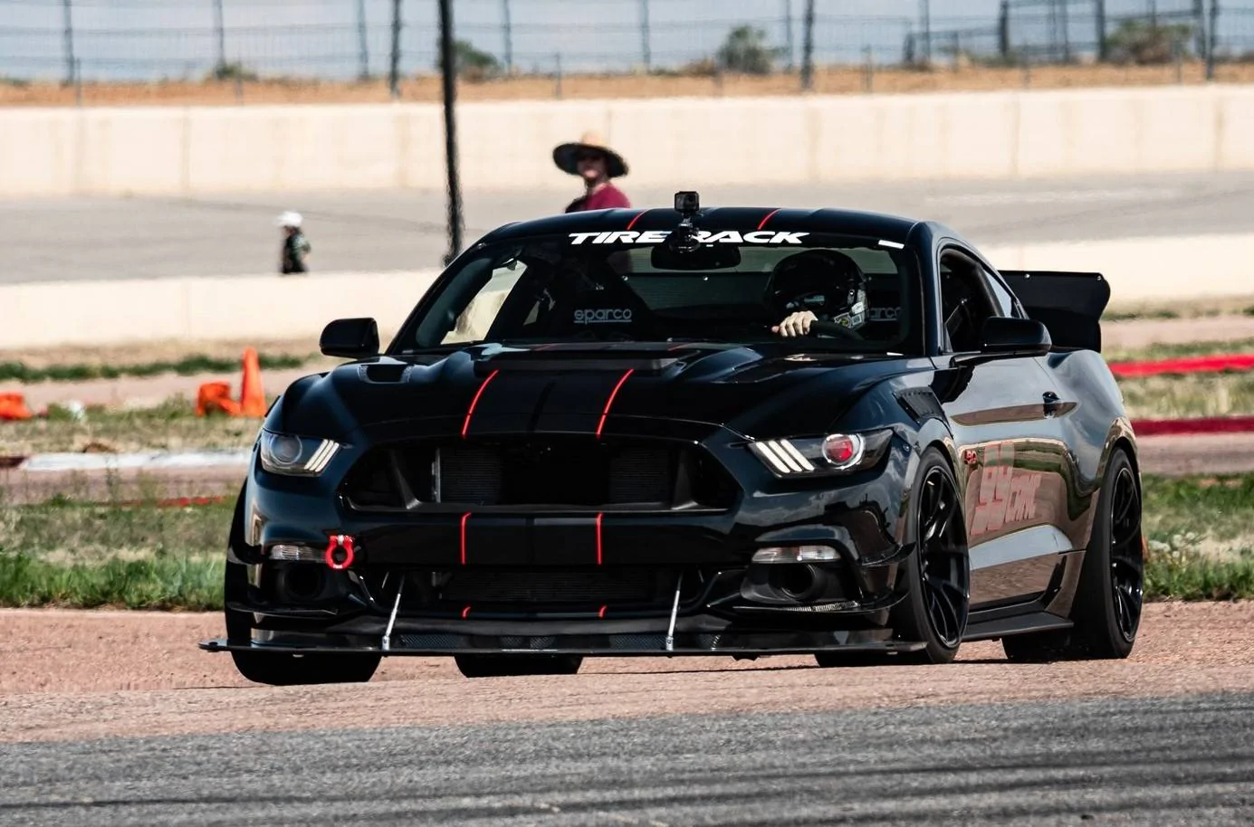

My 2nd event of the 2025 season was a Rocky Mountain BMW autocross event at the Colorado Air and Space Port. I really like these events as they split the day up into a TnT in the morning with 3 or 4 practice runs on the course, then a lunch break, and then 3, 4 or 5 competition runs on the same course in the afternoon that are scored.
The weather was perfect. Cool in the morning but mid-70's in the afternoon for the competition runs. The only change to the car was the addition of the Girodisc front rotors. They netted a 19 pound loss from the front of the car - and rotational mass at that. The course designer is a friend who also runs CAMC in his 2018 Camaro. He was running the new Vitour P1's - 345 square!. In the end while the car felt great overall, I still wish it had a quicker response in transitions and during the lunch break I tried to make a front swaybar change but the bolts on my new adjustable links wouldn't allow it as they would have rubbed the strut. Something to fix later. Dave ended up taking the class win (open class - Non-BMW) by about a second.
The next RMsolo event is in a week at the same venue. I'm travelling this week so no time to work on the car. I'd like to swap to my new Yokes but I don't think I can get that done before the event.

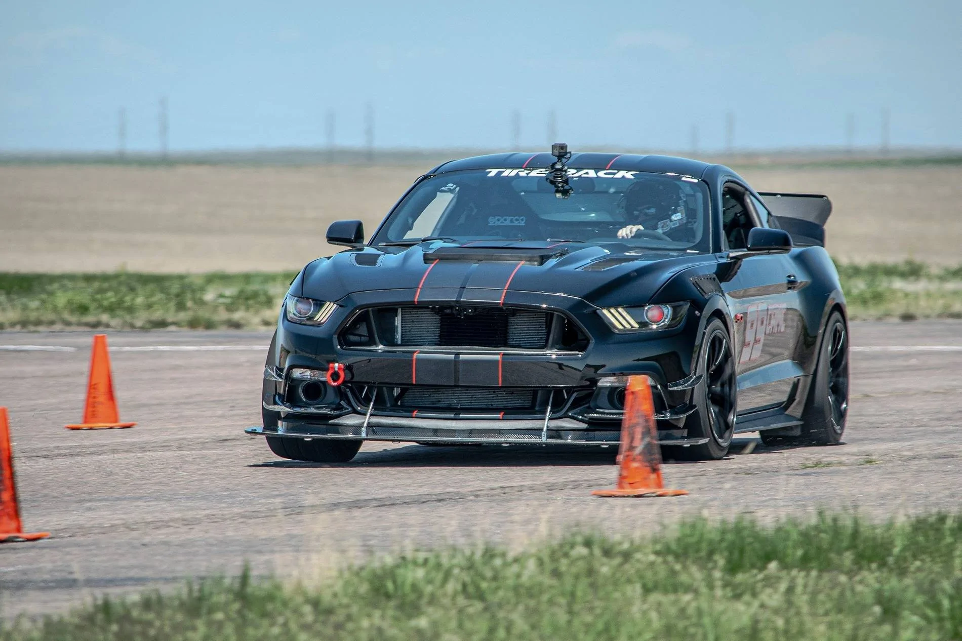

The 2nd Rocky Mountain Solo summer event of the season was last weekend. I had taken a family trip the week prior so nothing was done to the car. I really wanted to swap tires to a fresh set of AO52's prior to the event but there just wasn't time. My frenemy (he really is a friend, but is beating up on me on course so....) in the Camaro was running in X class in a different heat so time might not be completely comparable, but the trend continued. This event he was running a brand new set of Bridgestone RE71RS's on an also new set of 18" x 12" Apex rims. I think he's made of money.
Anyway he again set a time I couldn't come close to. I was .8 off. I was in the 2nd heat and the temps were well into the 80's which wasn't a helper for my old Yokes. I tried running higher pressures at this event with mixed results. I also tried a couple runs with softer shock settings (just rebound as my shocks are singles) and while it helped deal with the very bumpy north end of the course, it didn't help on the stopwatch. This video is of my last (5th) run. I had just sprayed the heck out of the tires before this run. I also used 1st gear a bit more mid-course and just before the finish. Those LS motors have a ton more torque than the Coyote and the digs out of the slow turns really emphasize that. I did win the CAMC class and 16th overall. A 964 PAX made for a poor points day.
The new Yokes went on this week in preparation for Spring Nats in Lincoln in a little over a week. On a positive note, another friend got some great pics of my car, and my new external mic for my GoPro worked awesome.
