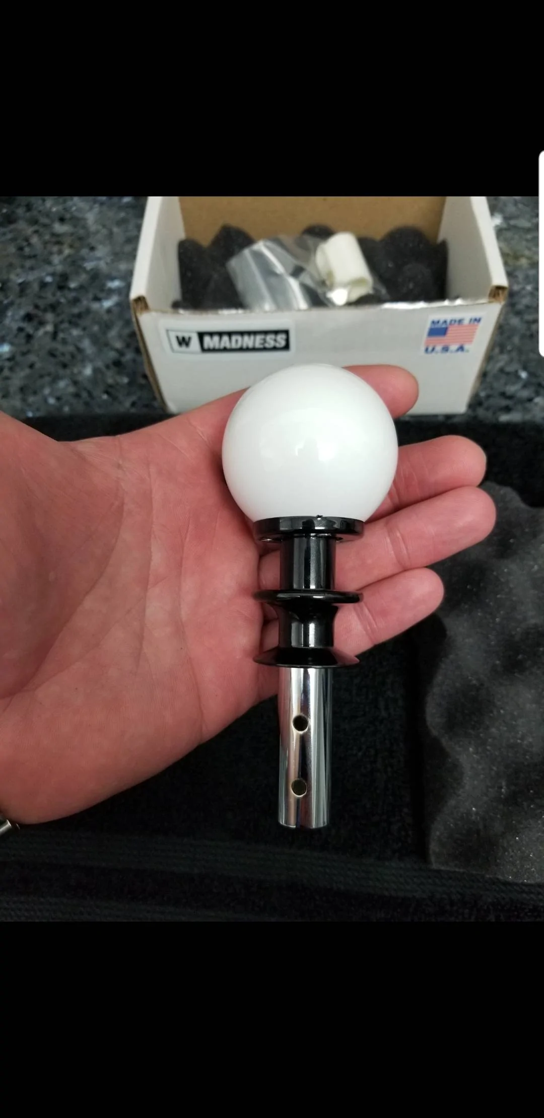

For those that have the White Madness brand for the S550 auto shifters, how does it operate?
Meaning, with the stock S550 auto shifter, the driver presses down the top mechanism to disengage the shifter to move it into position X.
Doee the entire WM ball get depressed downward to disengage the shifter shaft so it can then be moved into position X?

I wrap my index and middle finger over the ball and under the the slider sleeve. pull up on the sleeve and down on the ball. easy peasy. Oh, make sure you use blue loctite on the two screws. Mine worked loose once. After I applied the blue stuff I never had another issue
