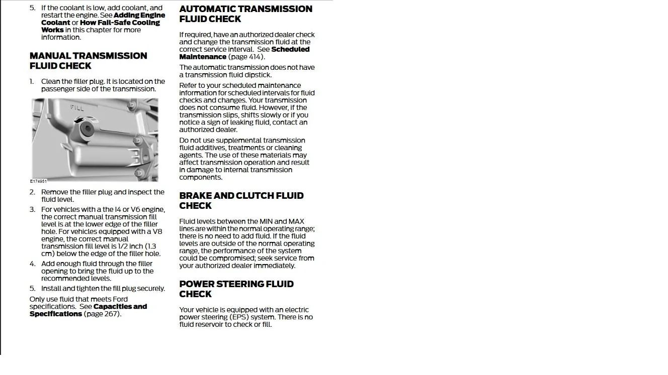

Really? Funny when I did a converter swap and changed my fluid over to Amsoil I was able to check the level with a dipstick.
You must not be looking hard enough.;)
You sure about that.....There is no dipstick to check the auto fluid levels. Its a sealed unit.

That picture is correct. I can post a real picture when I get to my computer later.
It is accessible but not easy since the exhaust is right there. After doing the converter swap the hardest part was checking the fluid level while the car was running on a lift.
You can buy an aftermarket dipstick that can run up to the engine compartment but they've been known to leak.
