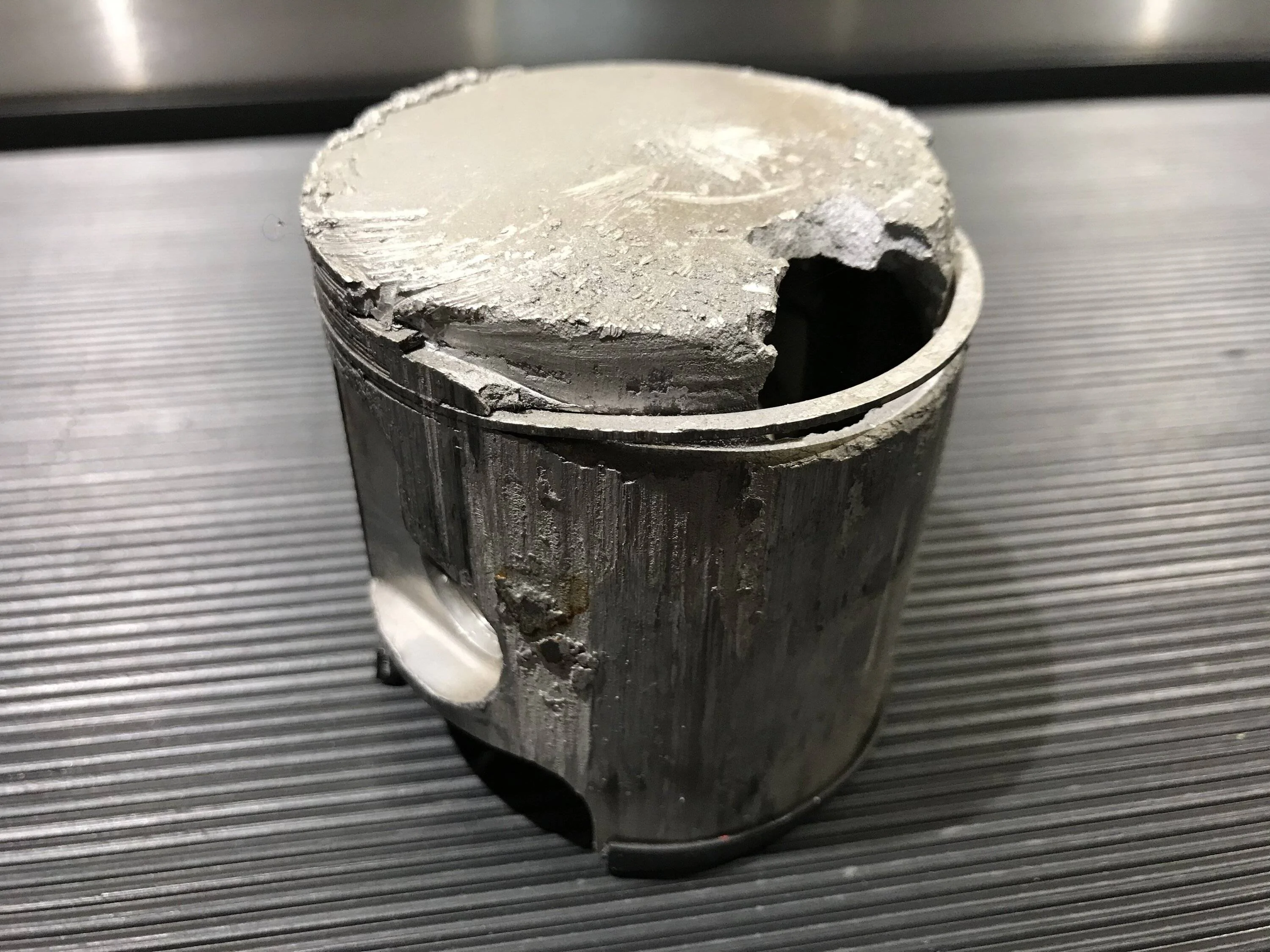

The original reason I pulled the motor was that it detonated really bad. The piston melted, the spark plug melted, and the piston rings melted to the piston. The piston was just rubbing up and down the bore so the bore is heavily scratched.
Melted like the picture below ?
Just one of 8 pistons were damaged all 7 others were unharmed ?

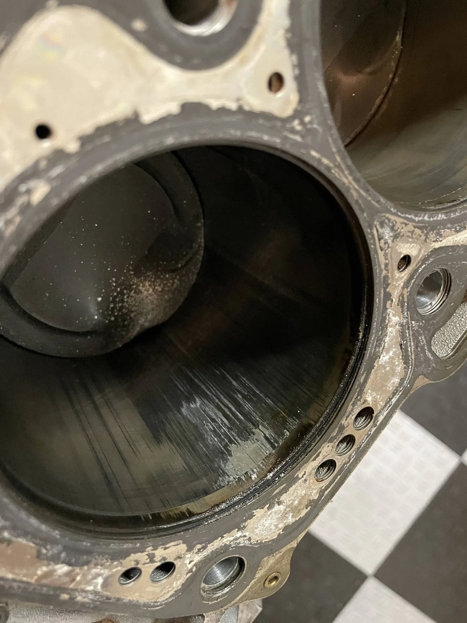

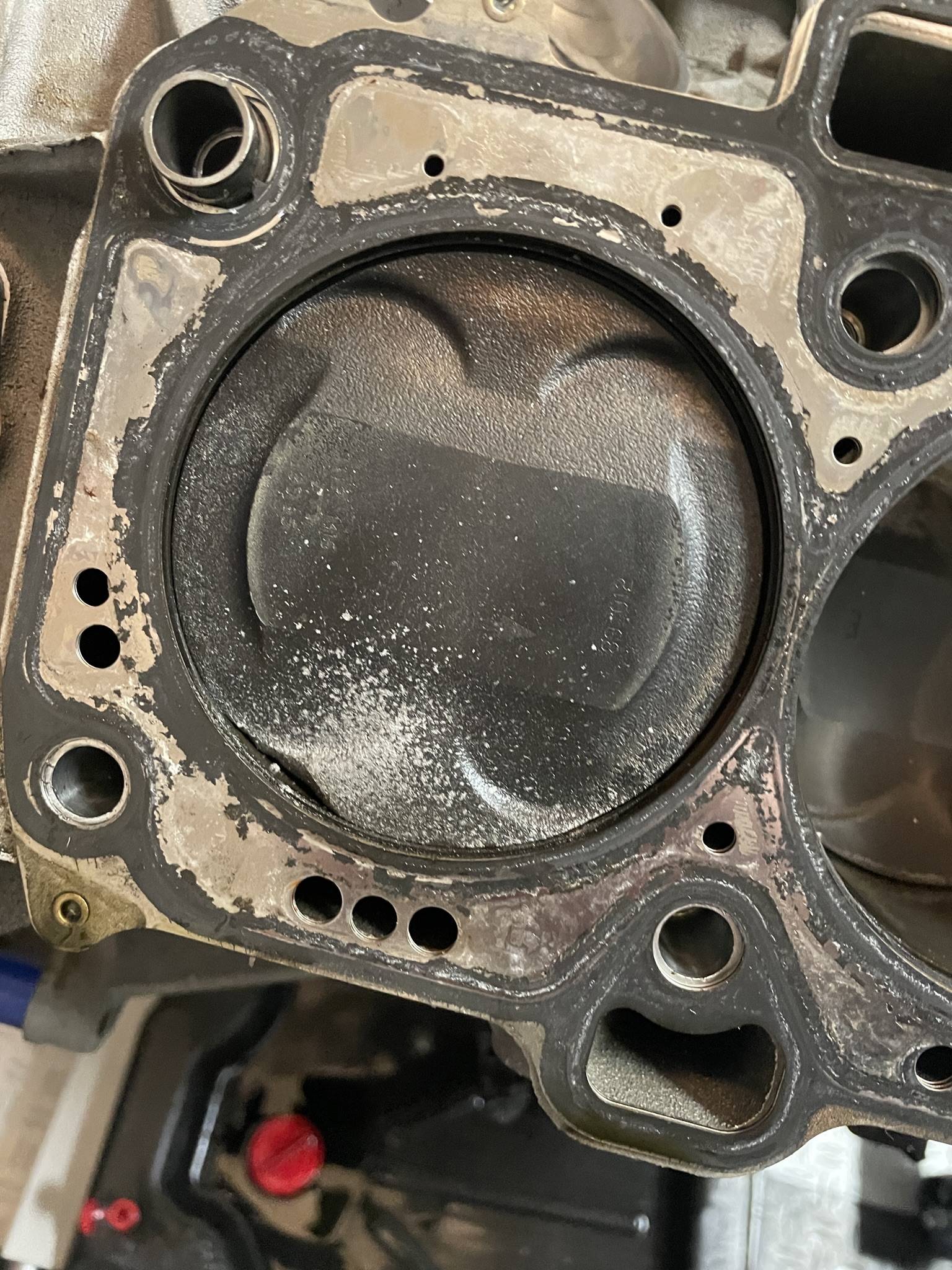

Just the one cylinder. That piston has been through it haha. Mine isn’t nearly as bad. Don’t have a photo of the rings melted to the side of the piston but here is the piston and cylinder wall.
Very interesting !
Only one piston, all the others are fine ?
You posted on another thread about your 2M header bolts loosing up.
I’m wondering, does the damaged cylinder exhaust port gasket show signs of exhaust gas leakage or soot trails ?
There’s more going on there than detonation. There’s evidence of a localized hot spot.
I’m going as far as saying that picture shows me no evidence of detonation. Especially if the other 7 holes are not damaged.
IMO what you have there is a hot spot from an extended full power run, stuff got to hot, expanded, the oil film failed from excessive heat and poof, in an instant metal to metal contact and the reciprocating parts came to a grinding halt.

The piston I posted failed due to localized coolant flow issues. I won’t bore you with how we fixed it but the jetting, EGT’s, fuel, timing curve and coolant gauge temp reading were all spot on ! So the question was how did just one of 3 cylinders fail so horrifically and the other 2 cylinders were text book perfect right down to the piston wash band.

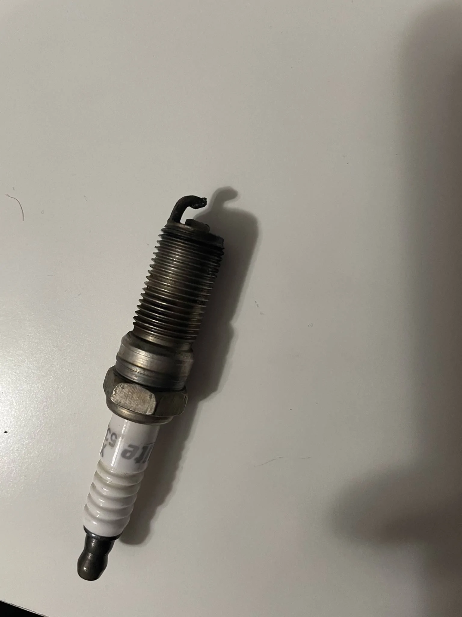

When I was driving I made a small pull. Started probably around 60-70 and got up to 110-120. Heard a small boom or “poof” and said damn that’s not good and then my check engine light came on. Car was misfiring hard due to the lack of compression and spark plug damage.
Spark plug tip was completely gone, and you saw the pictures of the piston.
Found a photo of the plug:

I’ll check the headers and see if I can see anything obvious.
To be honest, IMO this isn’t a bad tune that took out this one cylinder and piston. This is a case of header bolts backing out creating a leak and a wide band O2 sensor misreading the exhaust gas and a localized cooling system hot spot.
That piston turned molten. Detonation doesn’t melt pistons it jack hammers the head squish band and piston dome.
