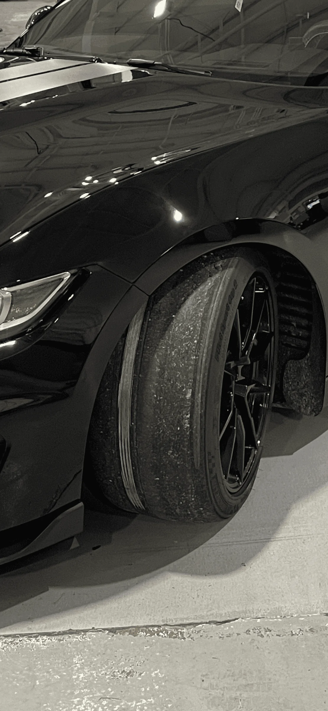

It looks like I am starting to see some delamination. Can I get one more event out of them?

How much negative camber are you running? Looks like the outside shoulder will be the first to show cord, as I don’t see any tread left. If you were showing some tread on the outer shoulder I’d say you definitely have 2 days left.
How many days/hrs are on them right now?

Camber plates are next on my list :like:
I'm relatively slow on track so these have lasted me 11 days so far lol
But I AM getting faster and most of that wear has happened in the last few events. Watkins Glen in particular was hard on the tires and the brake pads.

I haven’t laughed that hard in a while :)
Ok…. You probably have 2 days left on them. Camber plates will certainly help. My home track is very hard on tires and brakes and I only get 3-4 days out of 35 series cup 2’s, 2-3 days out of the 30 series.
If I may make a recommendation: It looks like there’s quite a bit of rubber remnants that have glued themselves to the tire (totally normal.) This usually happens during your cooldown lap when your tires are hot and they pickup anything they touch. If you’re not driving on the racing line during cooldown (which a lot of people don’t) then the tires pickup all the spare rubber that is sitting off the line. Staying on line during the cooldown lap will greatly minimize the hot tire pickup.
Damn! Guess I'll just stay slow :giggle:
And that makes sense about the rubber build up. I was wondering where it was coming from. It's also possible that my line is so bad that I am always off line :sunglasses::crackup:

11 track days they’re likely heat cycled out but they’ll more than likely survive another day before cording.

Going a bit against the grain here - if those are your only tires (i.e. you're driving them to/from the track), I'd toss them. If trailered, sure you have more time. Definitely a day, likely more. But this is not a chance I'd take if they were my only tires. Not worth losing the track time. And the drive there could easily cause an issue with nails, excessive water, etc.
Also, WGI is not a track I'd mess around with bad tires on (assuming that's your next event).
Hmmmm you've given me something to think about. The event is at Summit Point Main (which is a relatively sedate track) but I was planning on driving there and back. I have a second set of wheels with the PSS mounted on them. I suppose I can bring the two front wheels with PSS just in case.
