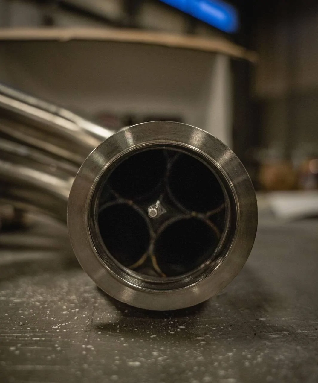

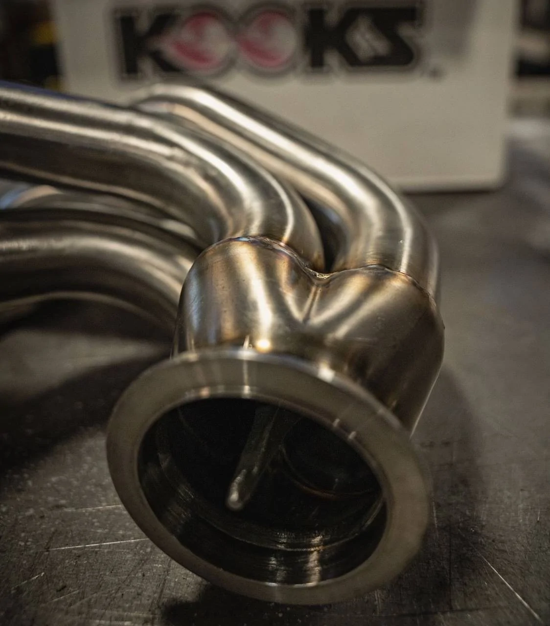

I believe even the most mechanically challenged could look at these photos and see a choke designed into the collector. What might one believe the choke is for? Care to take a guess who made these headers? See the hint in the bottom photo....

Thats a horse shit collector.

Of course it is, because it doesn't fit your narrative....kinda like wheel material effects the torque rating of lug nuts (which wasn't your narrative, but your back pressure narrative is similar). How many headers, exhaust systems, or anything requiring knowledge of fluid dynamics, flow characteristic analysis, etc., have you actually designed?
It's made from the bullshit dreams of some rank amateur. Spikes are made for slowing supersonic air to subsonic speeds, on the inlet side. Maybe he thought this would do the reverse. I dunno. That collector is also complete garbage.

Ah, I see. It’s interesting there’s so much conviction about spikes and speed of the pulses, followed by “I dunno.” So, how many sets of $2000 headers are you selling?
I believe the next time I’m checking out at the grocery store I’ll ask the cashier how to design a better cash register.
