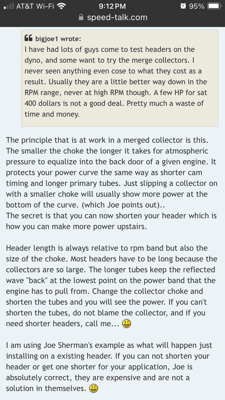

The question; are collector chokes still effective with full length exhaust systems ?
3.5-4" collector to a 2.5-3" exhaust. There's your choke.
