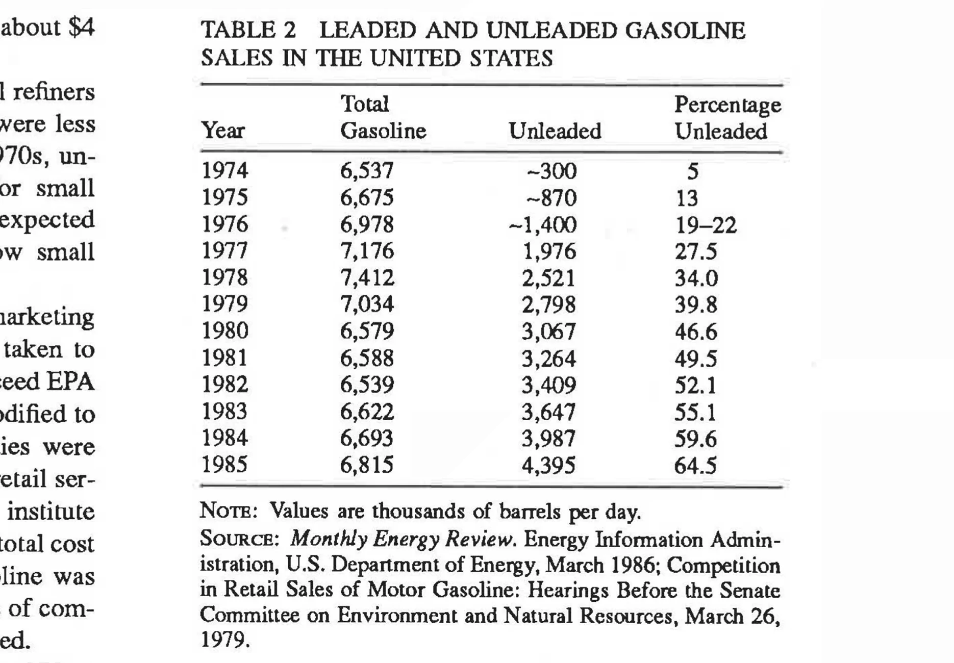

Early 70’s yes, by 1975 unleaded was at nearly every fuel station in the USA. All gasoline on road vehicles from 1975+ where manufactured with a catalytic converter thus requiring unleaded fuel.

well sure it was…but not everyone could afford a new vehicle in 1975, plenty of us in the Midwest ran leaded fuel well into the 80s šŸ˜‰
