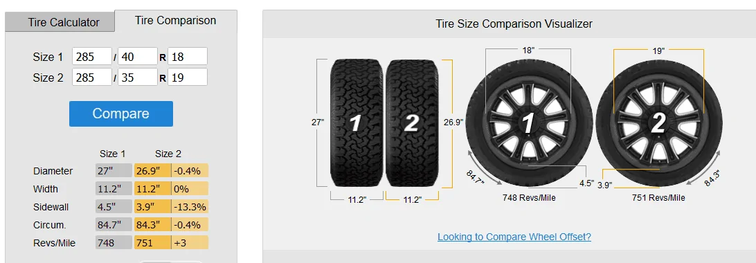

As long as you get the same tire height for both the 18 or 19 wheels, the the car won't be sitting any lower or higher with either choice.
You'll just have more tire wall with the 18s vs the 19s, but overall the tire size should be the same thus the same ride height and the same fender gap between it and the top of the tire.
Look at the comparison between a 285/40/18 and a 285/35/19. They are basically the same exact size overall, but 18s have more tirewall that makeup the 1" less wheel diameter.

OP mentioned 275/40/18 which is a far more common tire size than 285/40/18.
Right, and vs. the common 275/35 or 285/35 19 inch tires, the difference is once again minimal in overall height.
Both of those are 26.6 or 26.9 vs the 26.7 of the 275/40/18 mentioned.

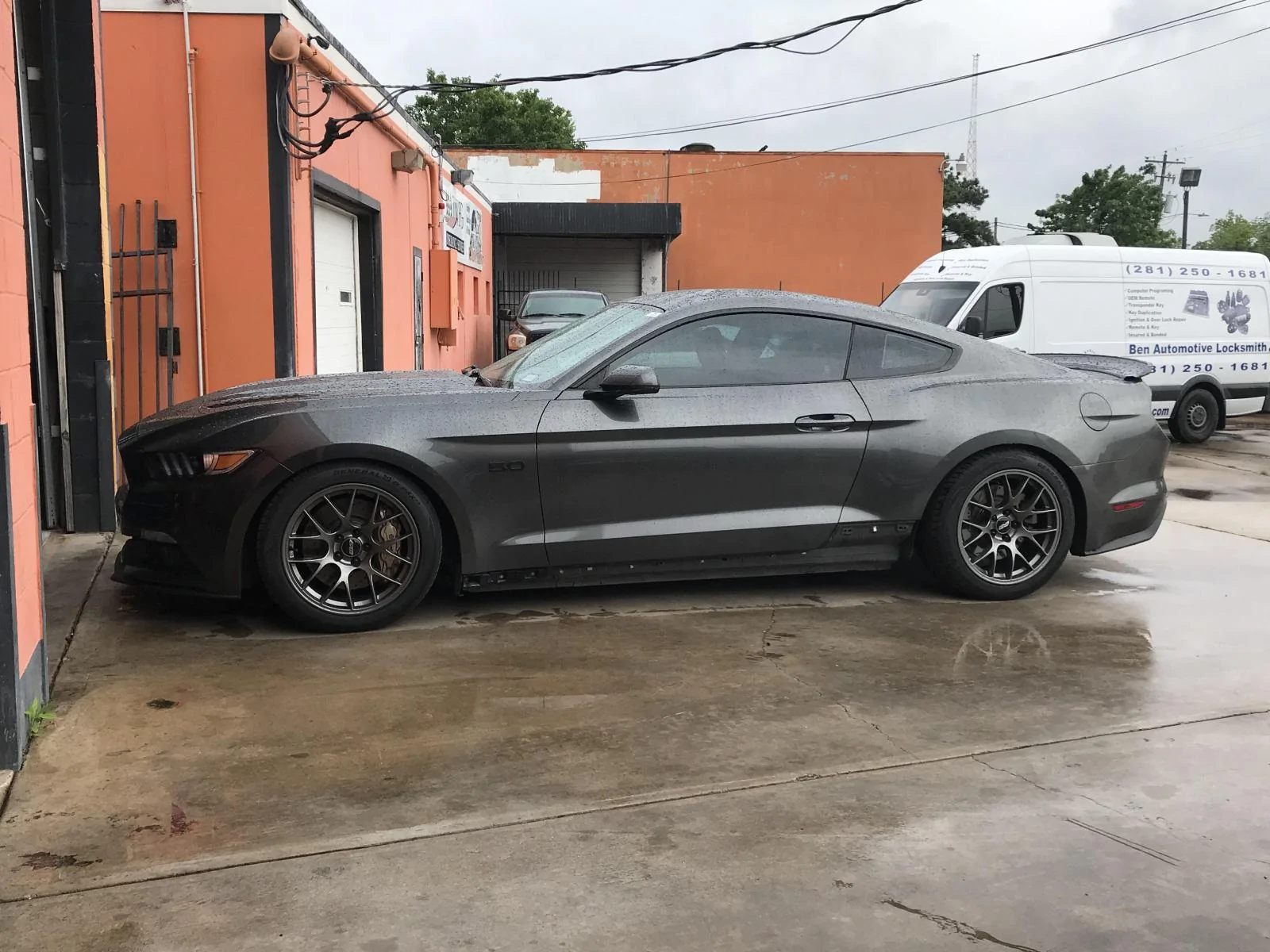

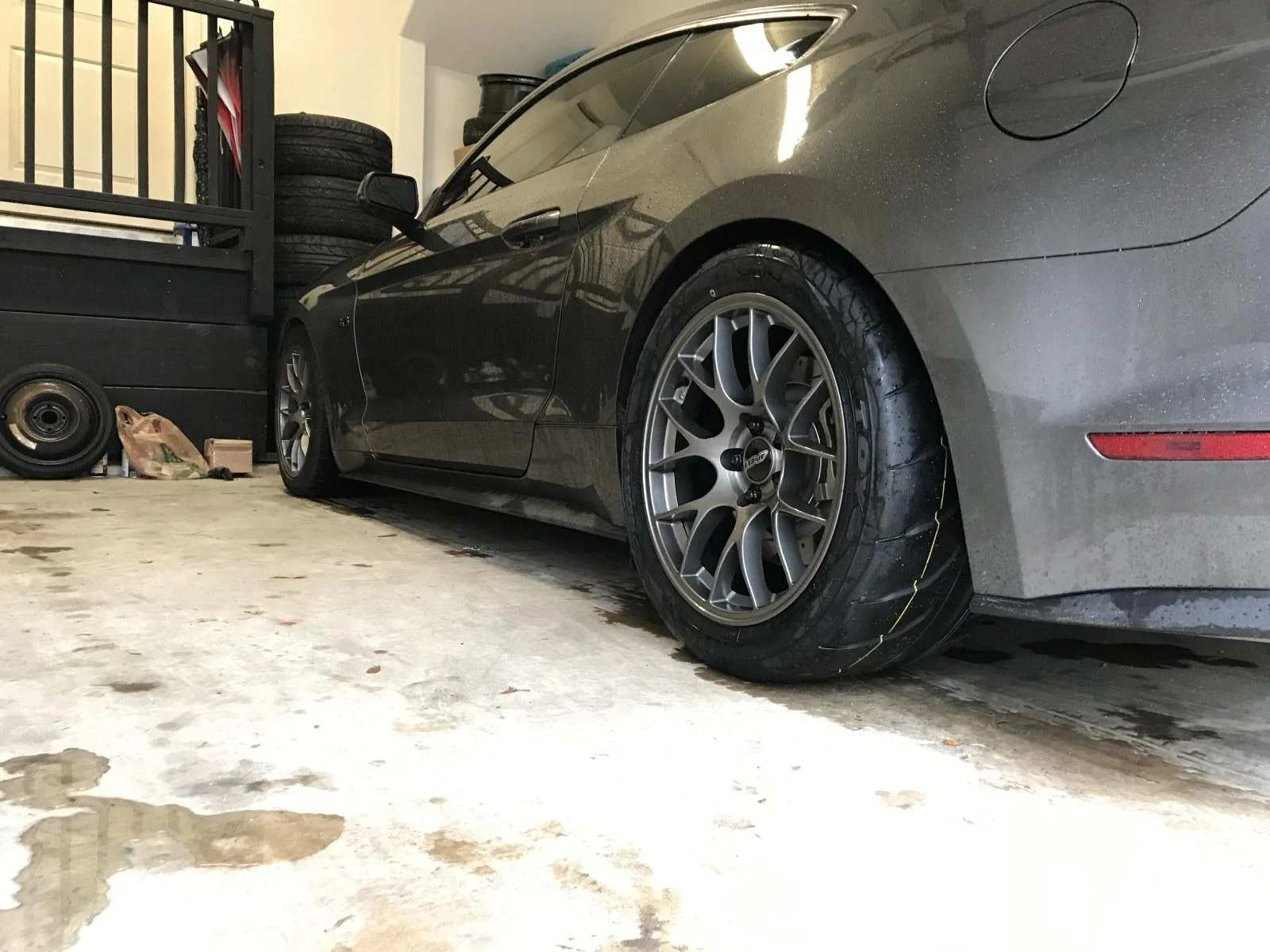

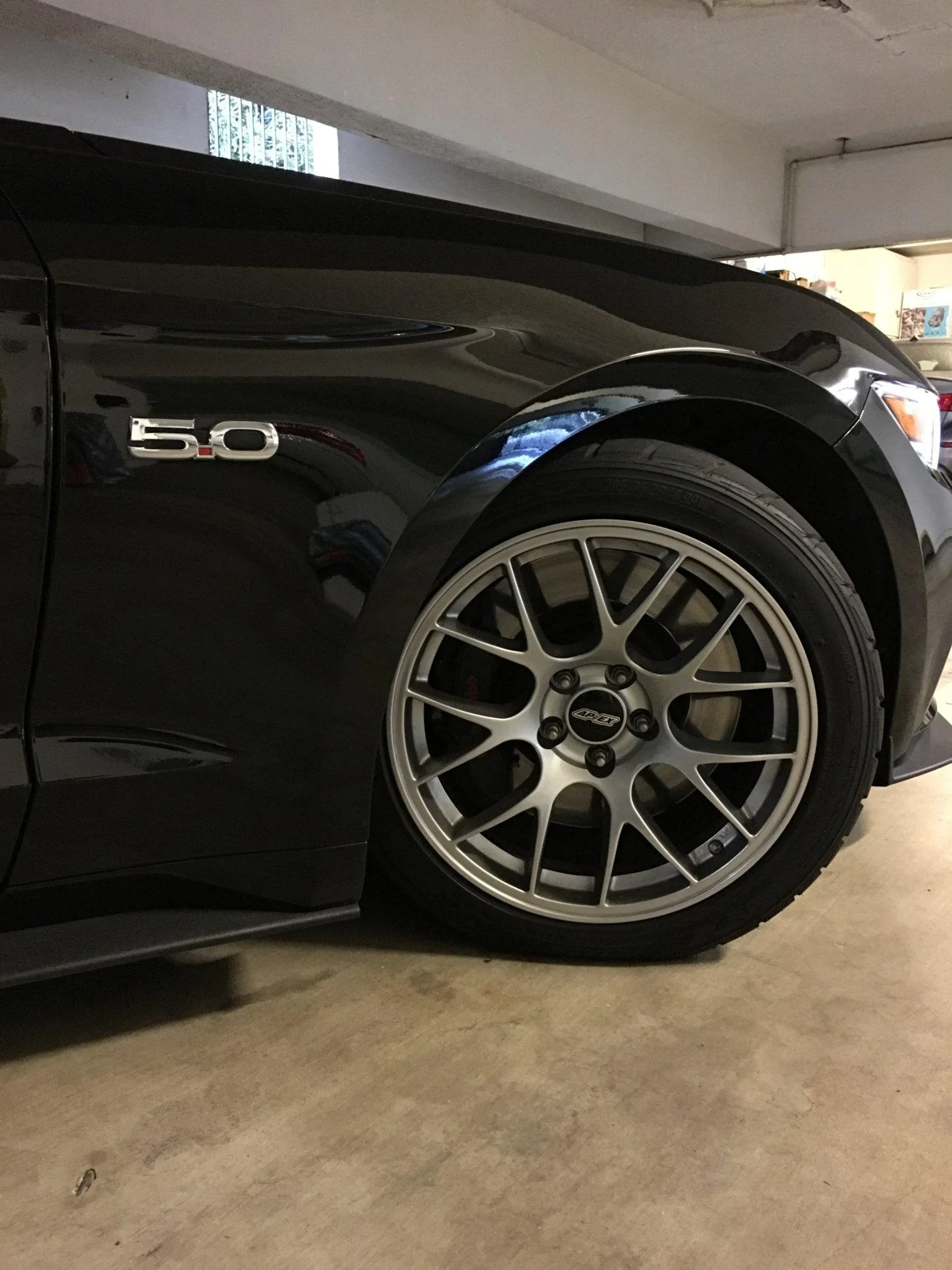

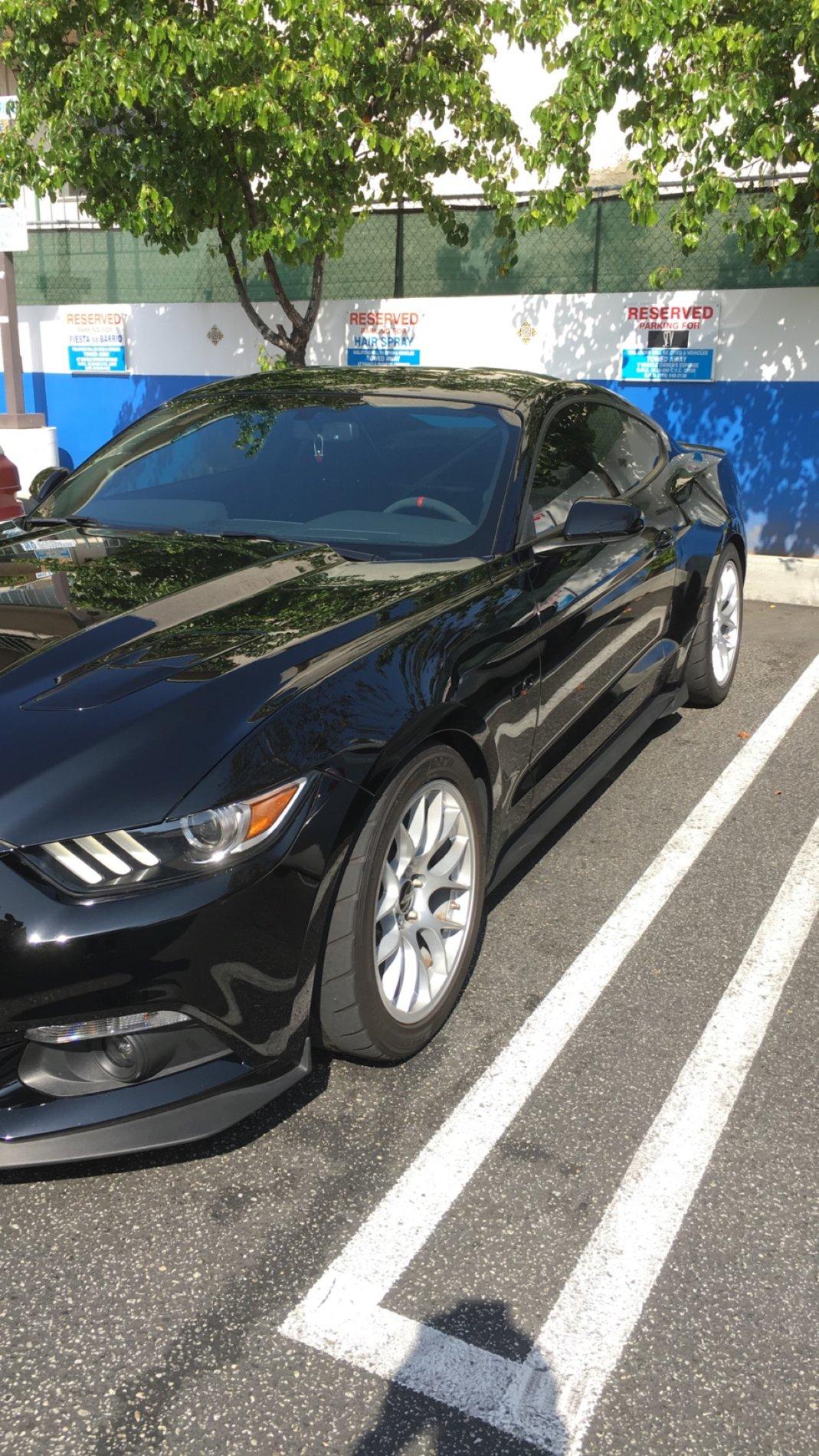

Check out my profile for pictures of my car i have ec7 18x10 all around. Love the setup so far.

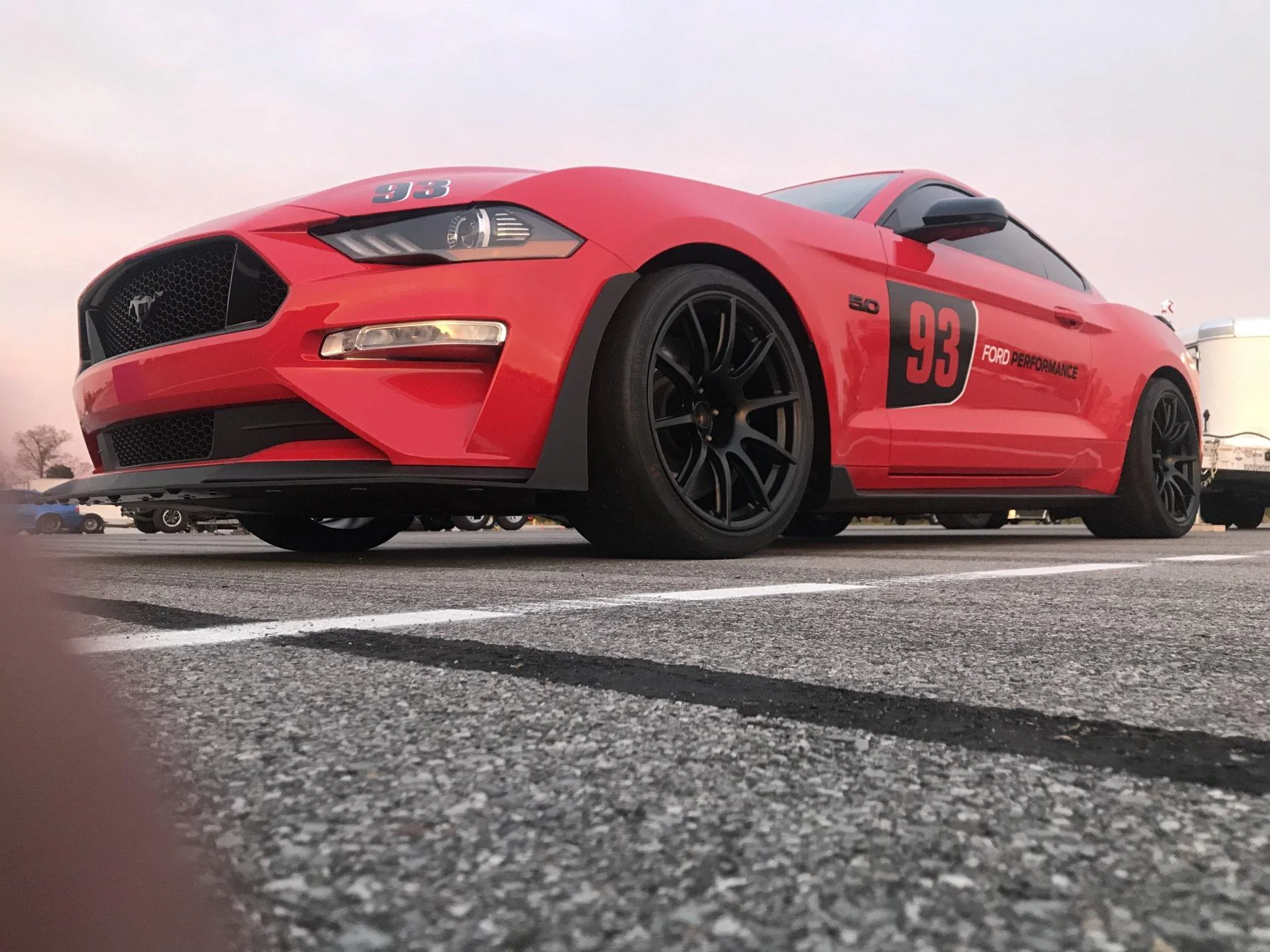

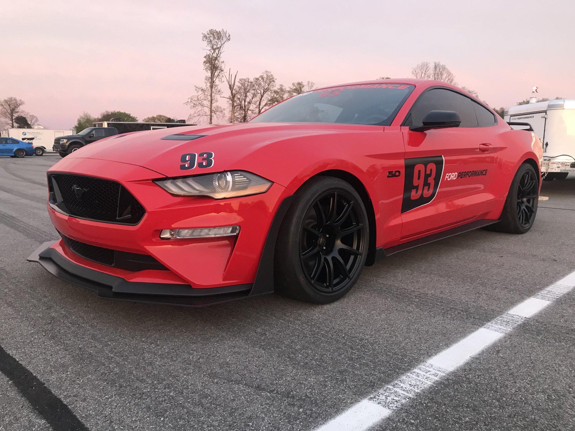

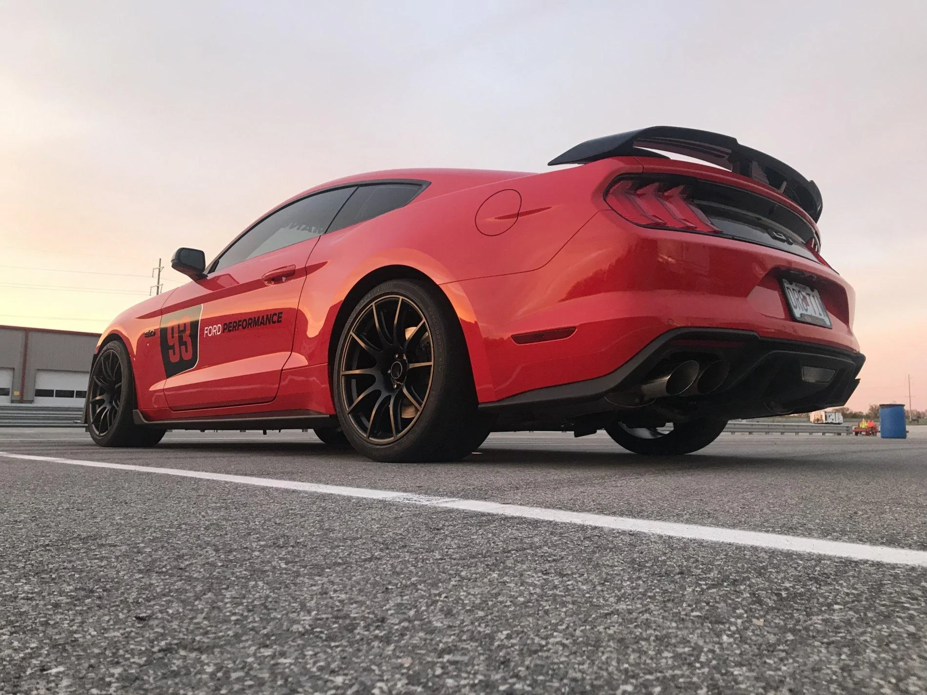

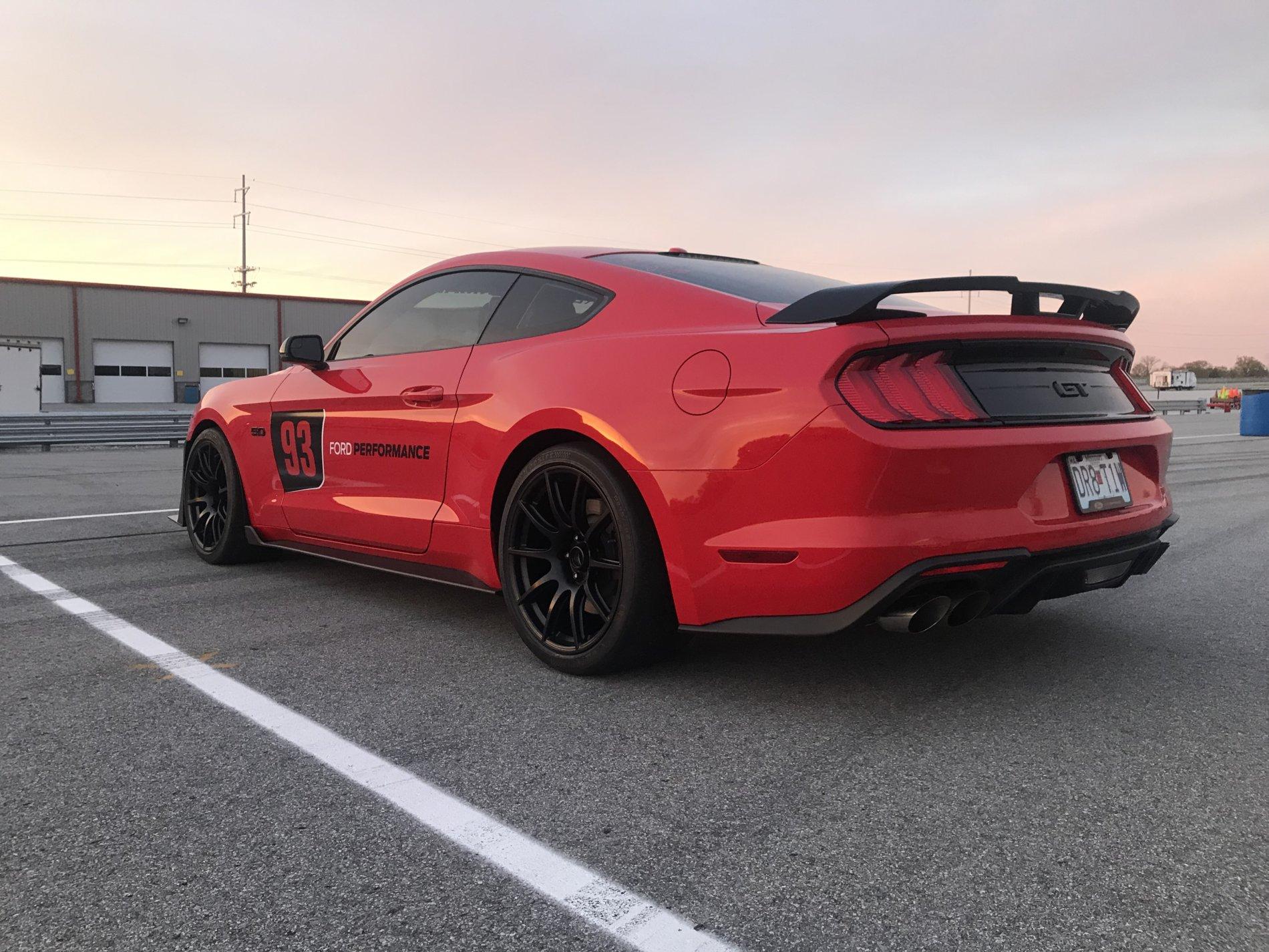

I know they aren’t EC7’s but I’m running 19x11 SM10’s for track use and really like them. The tire is a bit shorter than I’d like but I got a deal on them. I’ll run a little taller next time around.
NightmareMoon
Nov 22, 2015
7,213
6,510
Austin
2016 Mustang GT PP w/ Voodoo
Yeah, I like the newer Apex SM-10 more than the EC7. Plenty of tire selection in 19” sizes to work with.
