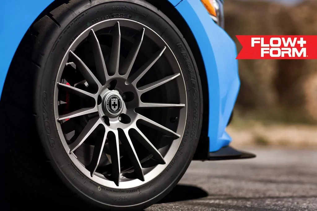

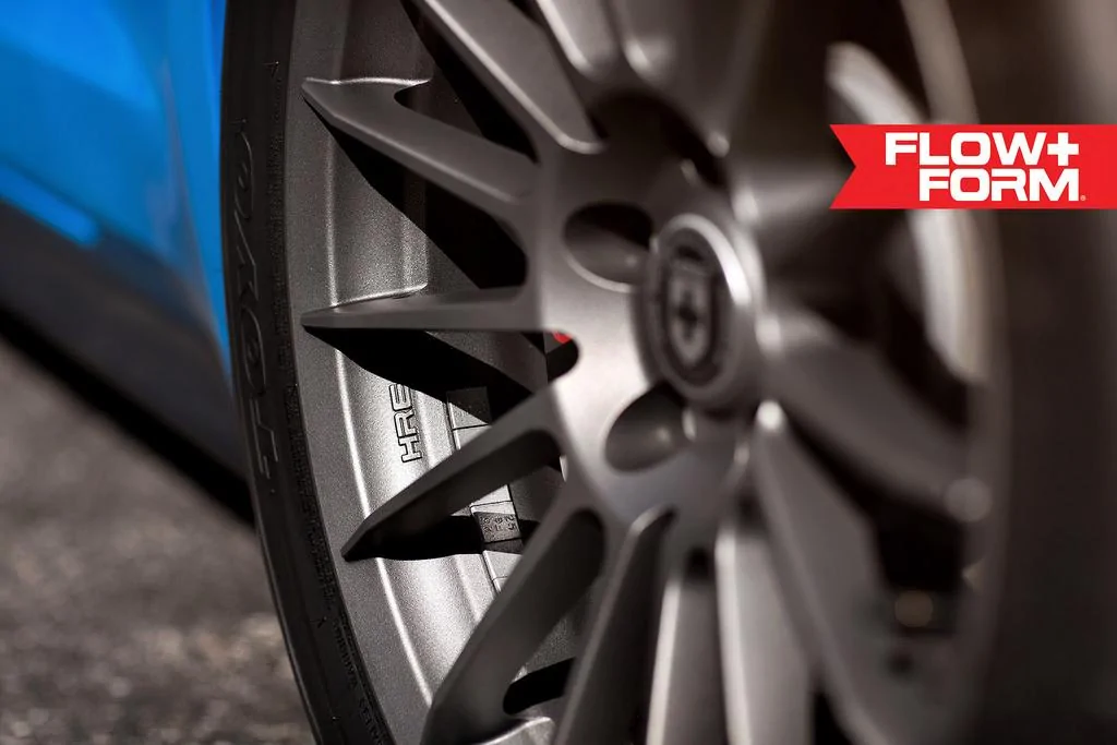

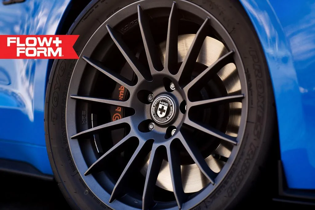

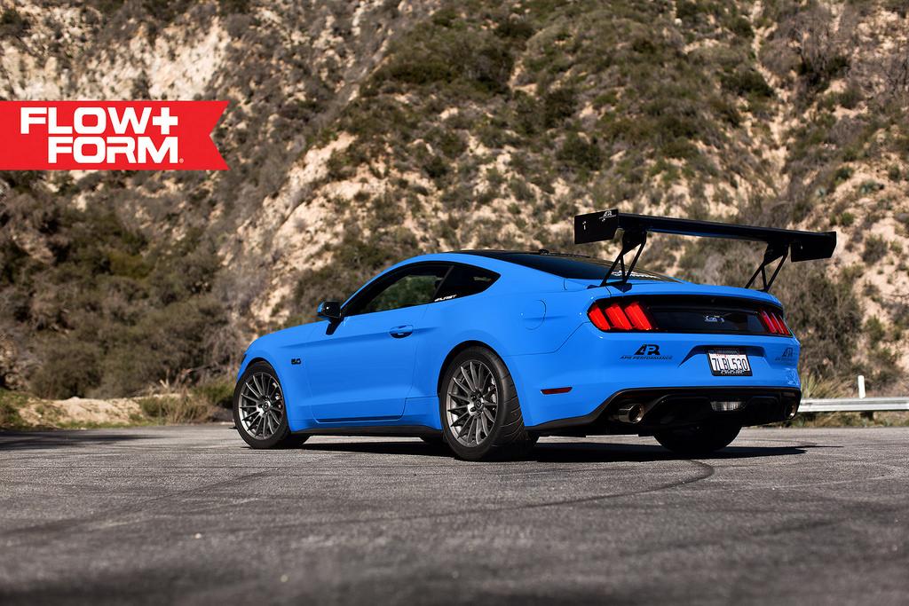

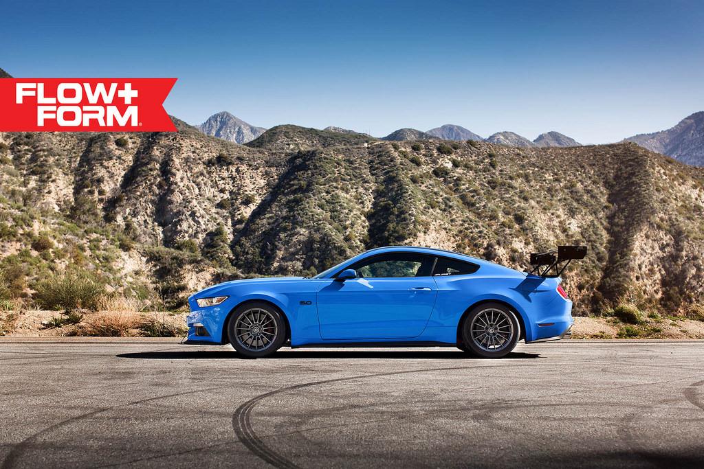

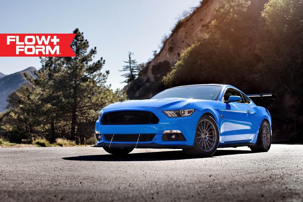

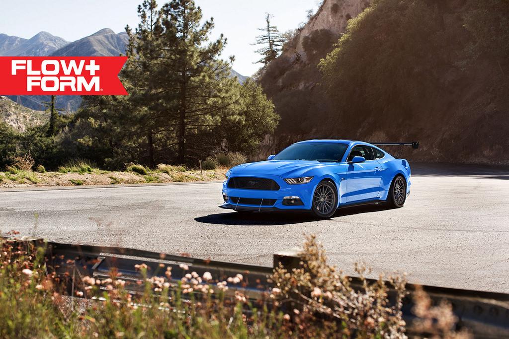

Installed are a set of FlowForm FF15 wheels powdercoated in Fog. 18x10.5 square with 305/35/18 Toyo R888's which turn this car into a real track monster. Wheels weighing in at 21.4lbs we're looking at a very significant drop in un-sprung weight compared to the factory wheels which weigh 32.6lbs front and 33.3lbs rear - for just the wheel alone that's 11lbs less for the fronts and a 12lbs less for the rears!
Personally for me I think if you can go all out, this would be the set to get for the track. Running maximum square tire sizes that are able to be rotated when needed is a huge benefit, plus all the weight savings will certainly help out along with the massive rubber.
