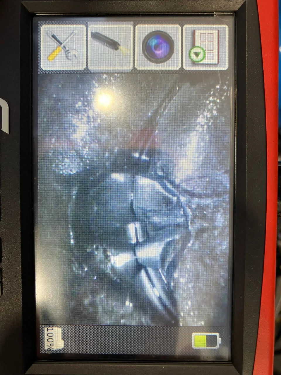

...It appears from the data log that the failure actually occurred after he let off the throttle. Couple that with the pic in post 87 that shows a similarly failed piston in a nearly-stock NA Coyote along with reports of other stock engines failing in the same way, and it starts painting the picture that this could have been more a random failure than being caused by high loads and boost (thank you Waloddi Weibull).
Another data point popped up. The attached pic is courtesy Jeff Evans Evans Performance Academy — Evans Tuning and it shows a cracked piston, with the crack oriented similar to the two examples already shown in this thread. The car was almost completely stock and NA with very low miles. In my view, this strengthens the case that these pistons fail randomly and there really isn't much we can do to prevent it.
If I remember correctly, in your previous posts you mentioned production flaw or flaw's and could be issues under certain Boosted conditions , just off a Full Throttle run (when this one occurred ) , when the failure occurred .
But with this evidence of failure in low mile NA engine . I have a question to you , does it matter how the engine was used prior and up to the failure?

..., does it matter how the engine was used prior and up to the failure?
It would be hard to argue that stress applied isn't a factor, as I'm sure it is. But with a number of piston failures on stock NA engines while others live a long life over 1000 hp tells me there's a broad distribution of piston strength from the factory.
