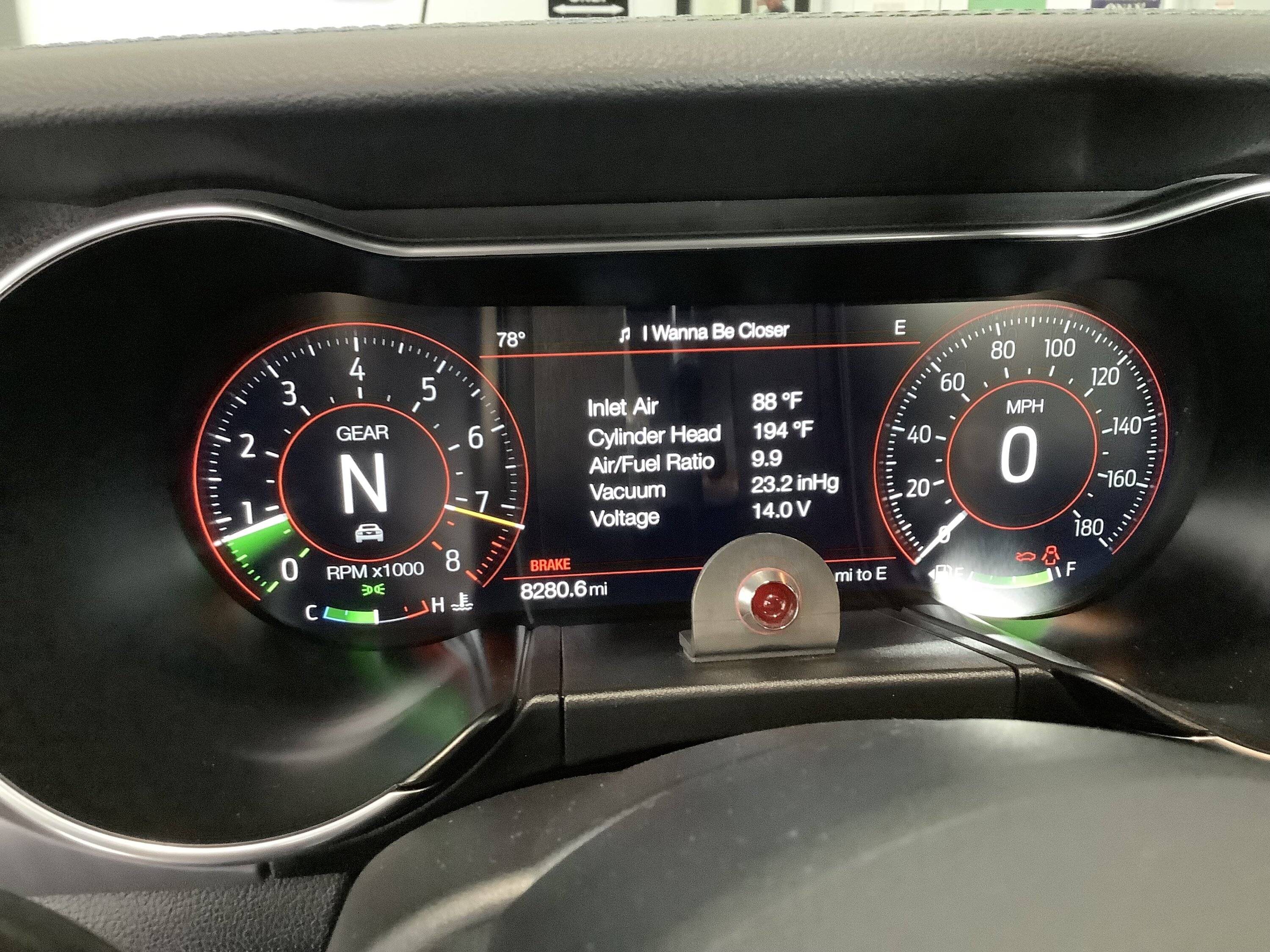

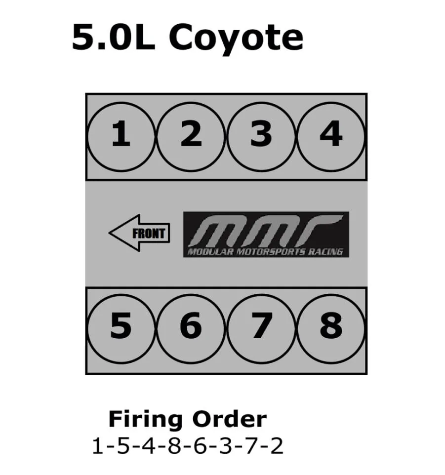

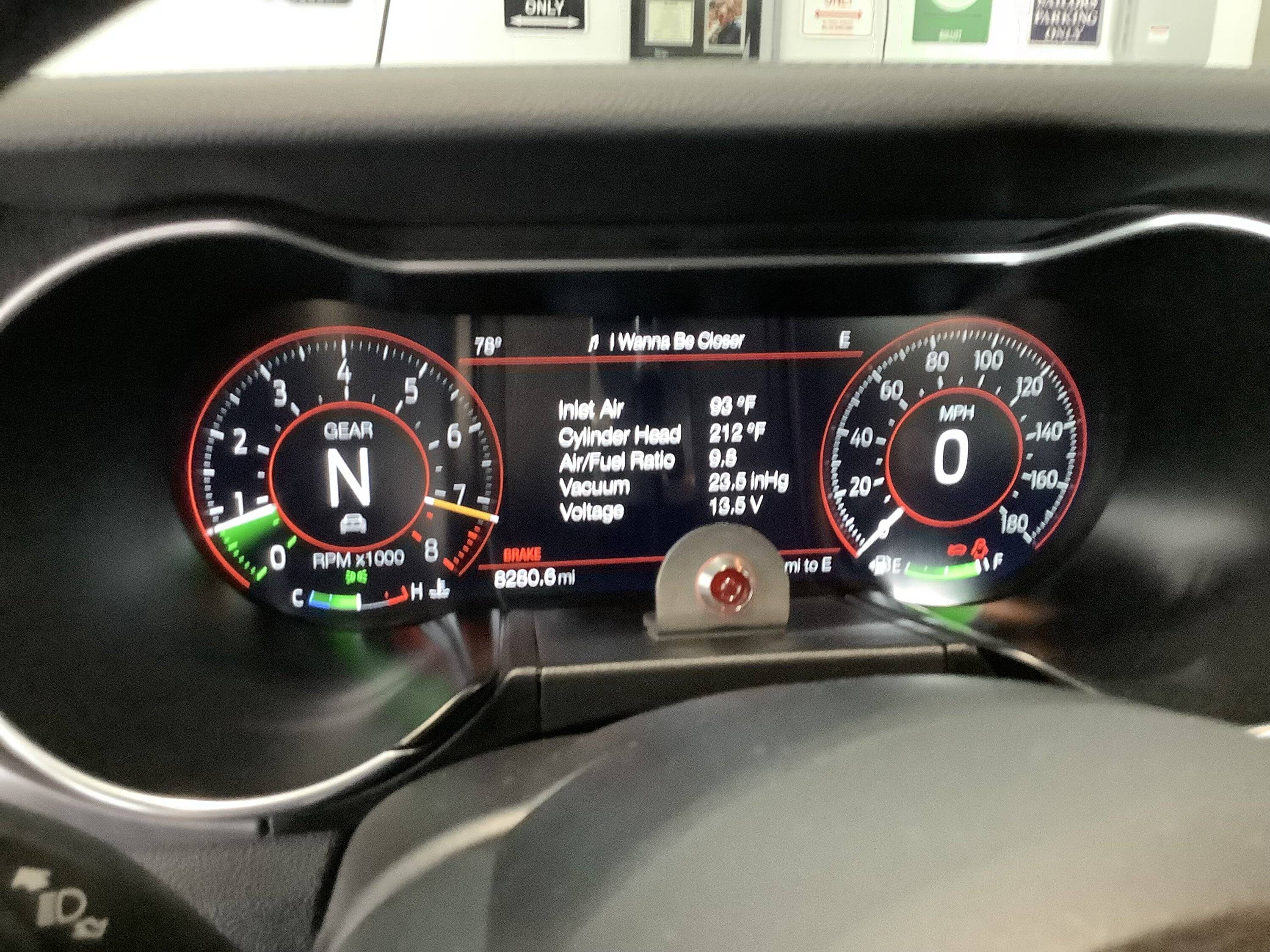

Okay guys, I put my car on the lift, so that I could gain access to all exhaust ports and shoot the infrared beam at them for temperature readings.
I also took readings from the front of the left and right cylinder heads and the MMR Head Cooling Mod standoffs that are pressed into the engine. See diagrams, photos and test results below.
Front of driver’s side head (area directly below #5 cyl.) = 113.5
Driver’s side MMR Head Cooling Mod standoff = 119.1
Front of pass. side head (area directly below #1 cyl.) = 135.8
Pass. side MMR Head Cooling Mod standoff = 177.6
Exhaust port flange area
#5 Cyl. = 231.2
#6 Cyl. = 295.7
#7 Cyl. = 278.7
#8 Cyl. = 239.0
#1 Cyl. = 263.8
#2 Cyl. = 210.9
#3 Cyl. = 246.2
#4 Cyl. = 319.2
Dash gauge readings (immediately prior to temp checks)
Dash gauge readings (Immediately after temp checks)

Shit.... I think we are going to need a thermal image scanner. These numbers are all over the place.
