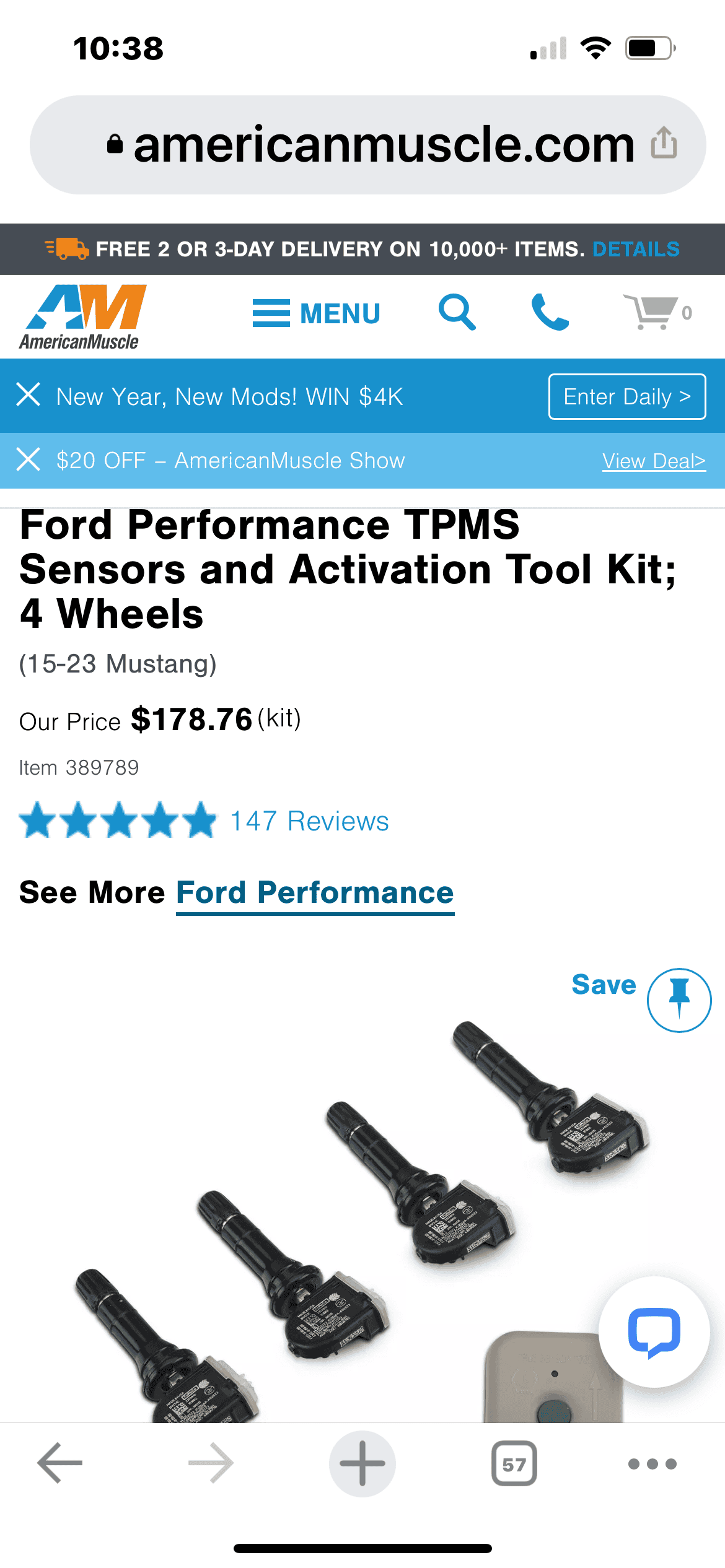

I went through the same thing as the OP. The tpms sensors I bought and put in were supposed to be for a 22' but the frequency must have been different. I carried it to my local Ford dealer where they informed me I need a different number. They want like $500 to install the correct sensors. I said no thanks, bought them off of ebay for $60 and then had Discount tire install them. They did it for free because that's where I bought my tires and had them installed previously. In short, I think Ford changed the frequency somewhere between 19' and 22' so you probably need new sensors. I believe you need F2GZ-1A189-A

I’m wondering if maybe you were just provided the incorrect sensors. Where did you buy the sensors that were not correct?
Appears sensors are the same 2015-2023
Looks like the first set I ordered were F2GT-1A180-AB. These said they were for a Mustang but would not work no matter what I did.
