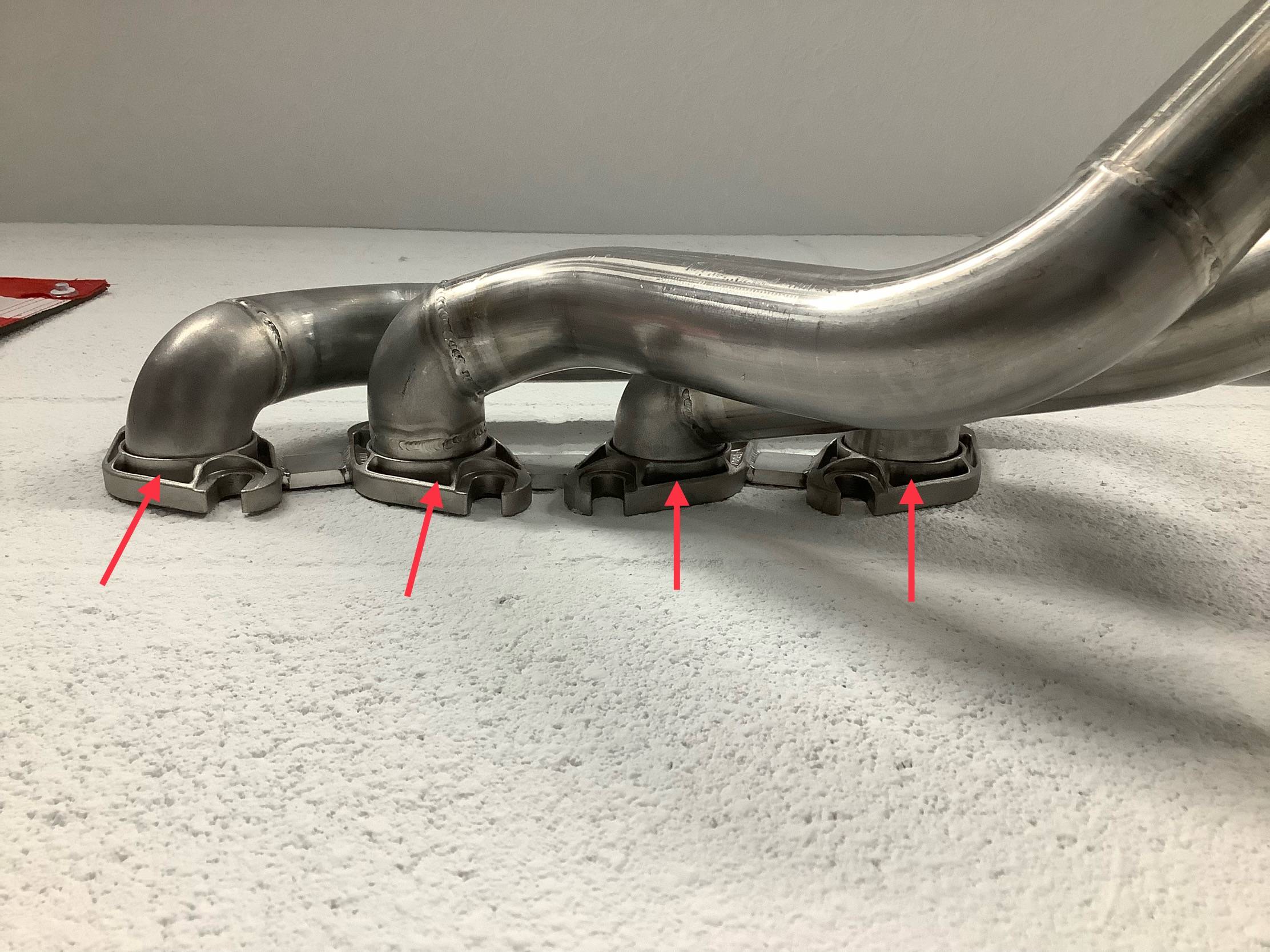

Shit.... I think we are going to need a thermal image scanner. These numbers are all over the place.
It would be nice if someone else can perform the same test to gather temp readings, so that we can at least compare notes to see if there is a wide variation in the numbers.
FYI, all of my readings were taken at the exhaust flanges, right off the head as shown by the red arrows in this pic.
