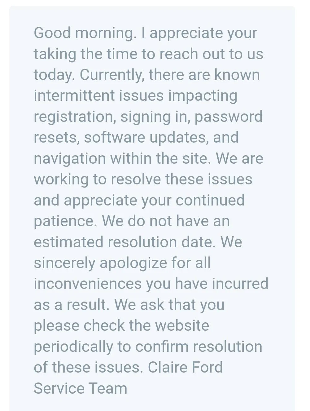

I talked to Ford tech support today and they essentially eluded to the fact their updates are F****D right now and "being worked on". What a disgrace. I work in the software industry and these problems simply should not exist in 2020.
That’s what I was told a week ago. I just to not know why they do not put the files online and let us grab them.

Phone got me nowhere, but Twitter gave me the same response.
Its clearly a hot mess. Glad they know it, but common, as said it's 2020.
