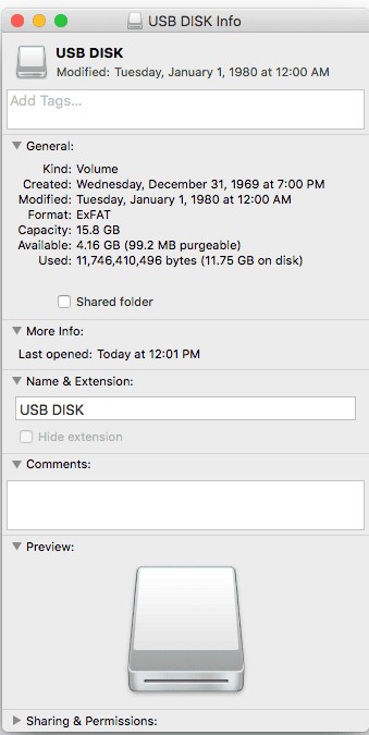

By the though you might get a kick out of this. I ordered the maps drive from $40.00. Then when Ford told me my maps updated OK and I didn't need it i cancelled. Well I got the drive and was told today that I didn't need to send it back. Checkout the dates. Maybe this is why we constantly have issues with Ford on updates.

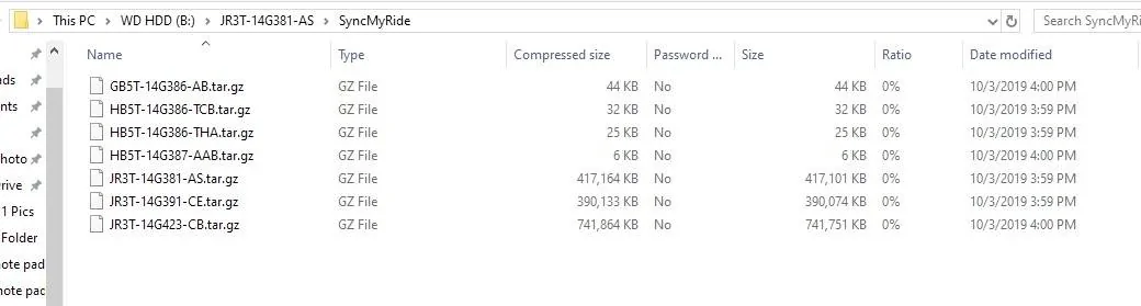

Yes from ford. this is the folder contents i DL. Unlike NFG i dont know what im doing lol, i had no issues updating maps on the 10th of Jan though.

OK, so all the files are correct (checked against to 19205 file I had for my wife's Escape. So I presume that you have these three files/folders, right? From your hard drive you then unzipped the file using Stuffit. And this is where you ran into this problem? Have you tried downloading the files form Ford again?
no sir, only time i tried. i guess i could try a few times. i work from home at a computer so literally could keep trying all day between calls lol
