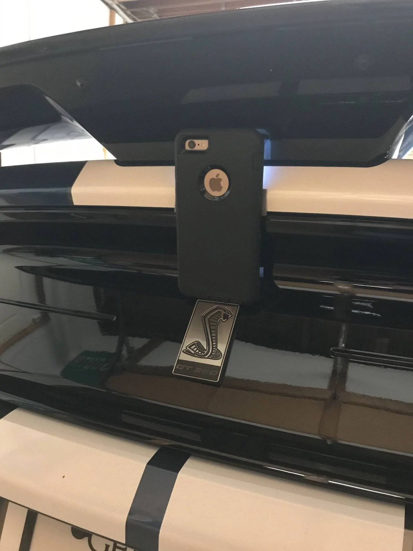

I had the recall done today... it didn't take long either.
You may want to reconsider getting it done... I'm not impressed with their fix!
Actually, I think that would be more reliable than the original camera, and the image quality would be incomparably higher. :giggle:
