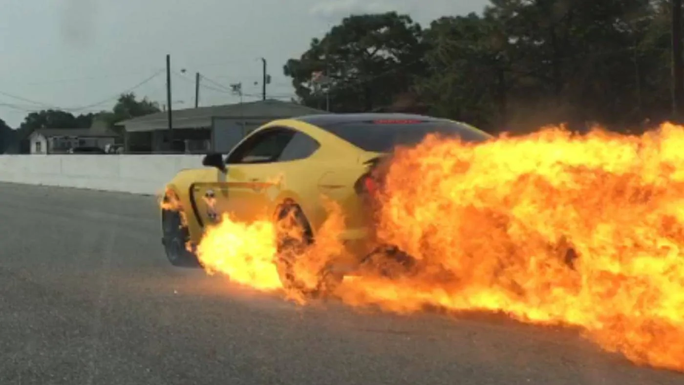

Here's a picture of a GT350 with an oil leak:
It's kinda hard to miss.
This particular car had an oilway plug blow out on track and the oil went straight onto the headers and caught fire. The point I'm making is that if there's a gap anywhere in the oiling system, the high-volume oil pump and the 100psi+ pressure it produces will move a lot of oil out of the engine very quickly. If the spin-on filter gets loose, the gasket won't leak, instead it'll blow out and there will be a lot of oil coming out of the engine bay onto the underside of the car and the road.

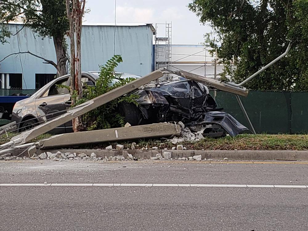

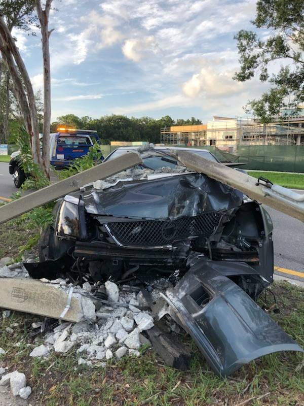

I hit a pole going 45 mph in my 09 cts-v in 2018. Got lucky, 0 injuries other than an airbag burn and slightly sore wrist. I braced for impact with arms and legs and it worked for me. Kind of crazy what an extra 15-20 mph does. Also, trees have like 0 give. but this pole didnt give much either.
Driver side headlight was 70+ feet away in a ditch.
