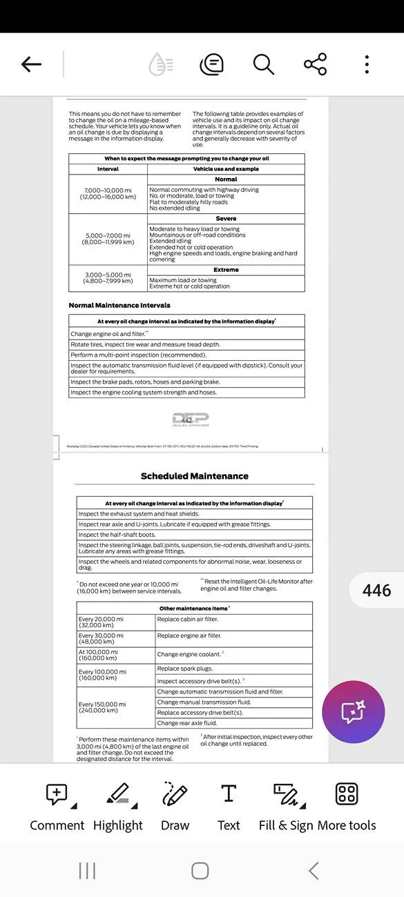

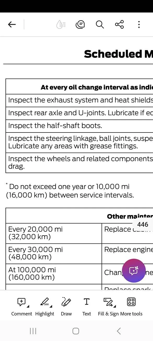

I'm not sure why Ford said yearly oil changes are too much? The owners manual clearly says not to exceed 10k miles or 1 year between service intervals.

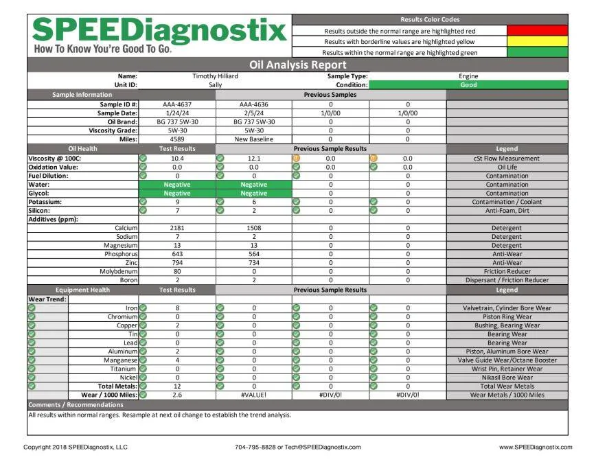

I'm averaging 1700 miles a season, change the oil once a year and perform oil analysis at each change. All results show good-to-great.

I have a 2021 mustang gt convertble, it has 5800 miles I have changed the oil every year 4 times so far , last season i drove about 800 miles! I live in Michigan so she snuggle under her car cover last spring when I went to the dealer they said that I really didn’t need to change oil so frequently. I do run the car once a month to keep fluid moving ,I run it for at least for 30 minutes the oil life says that I have 38 percent of oil life left , do I need to change it in the spring? I believe in good maintenance , and having the dealer do it for my records am ,I wasting my money ? Thank you for your time and help in advance!.
This oil was in the engine for 5 years. Still good. Oil Monitor was on ( Change Oil - 0% life left ) for about 2 years.
I'll point out this sample has BG engine flush in it, so that is the Viscosity reduction....
