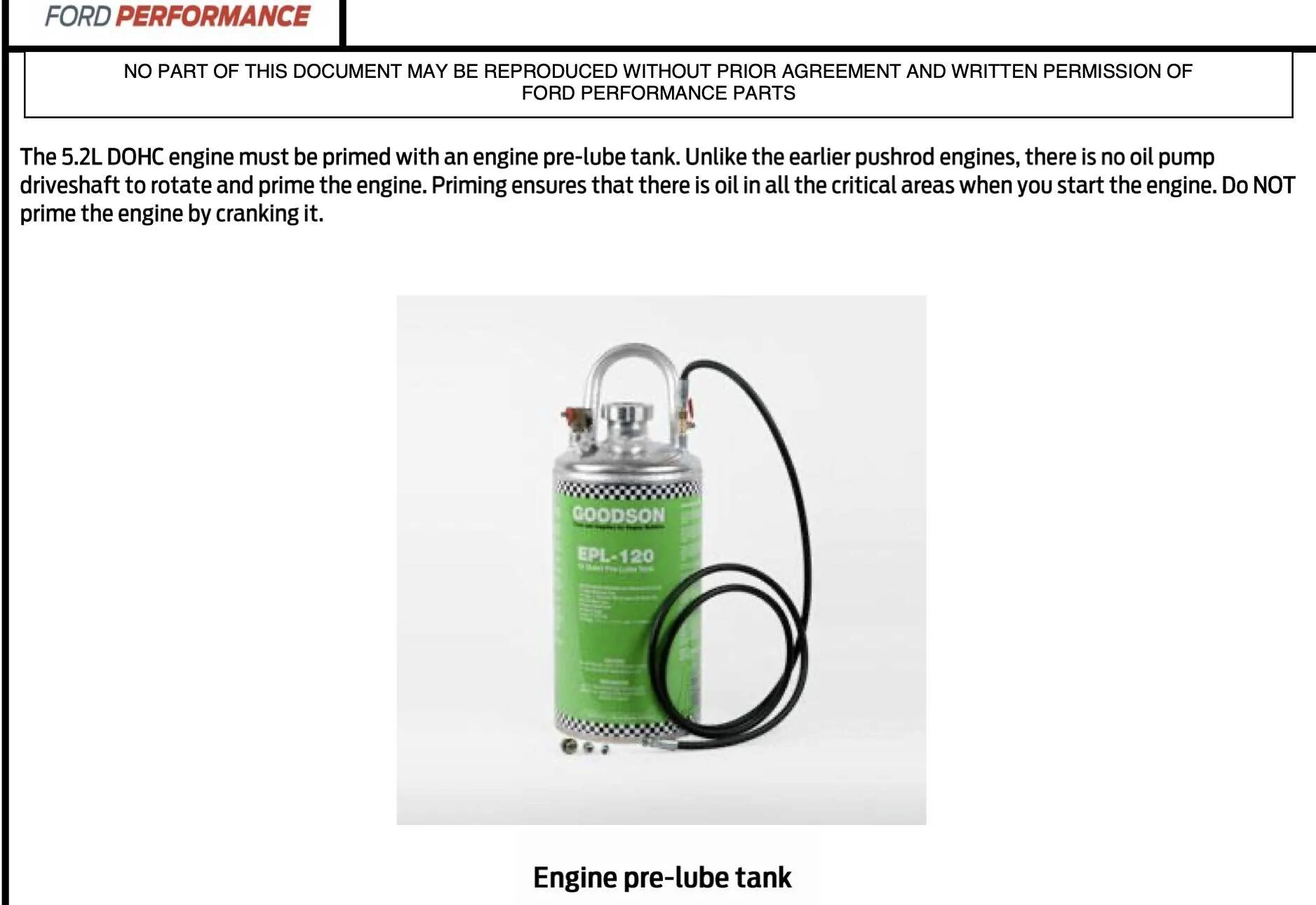

It does build pressure. The pump is turning. The oil is cold and thick. And the final proof...if you own a PP1 there is an electrical oil pressure gauge. After 15 to 30 seconds of cranking the pressure reads 20psi. This is enough to pressurize the lifters and get oil on the bearings.
Per Ford's engine documentation:
WARNING: Before installation, prime the engine by removing the oil pressure switch from the filter adapter. Install appropriate fitting and using a pre-lube tank to prime oiling system. Verify that the oil reaches the valve train, valve cover removal may be necessary. Oil at the valve train confirms the engine is primed.
Check oil level and fill as necessary.
Hello; This is a method used on new engines or rebuilt engines which have never been run has been my take. The new engines do not have a distributor so the old school methods do not work. I have looked at engine building videos during which such a device was used just prior to a start up.
During assembly of a new or rebuilt engine I imagine all use some form of assembly lube. I also assume most soak hydraulic lifters in a container of oil for a n hour or few during assembly.
For the sake of this discussion I suppose such a pressure vessel could be attached to an engine which has merely been sitting a few months. Likely would be a serious pain to do but the obvious benefit would be oil on all internal moving surfaces. Such a thing might be impractical on every single car but not a wrong thing to do.
The crux of this particular topic is we have two practical alternatives we can easily use. Any of us can pull a fuse. Those with the "food clear" programing built into the engine control can use that feature.
The back and forth with you (robvas) appears to me to be more that the notion is something you do not like. Let me lump in prefilling an oil filter before instillation which you have also rejected.
I get the point you are trying to make in that the last line in the above link is do not prime the engine by cranking it. Again this is for new or rebuilt engines is my take. The flaw in the argument is you contend we should just crank and start up an engine which has sat for four months without any pre oiling. How is this any different than pulling a fuse and cranking the engine over for a few seconds? The same oil pump spins and pushes oil in both cases.
Those reading this and the other thread can think about it and decide for themselves. I welcome any insight as to what the flaws are in my arguments. I do not want to hurt my engine.
