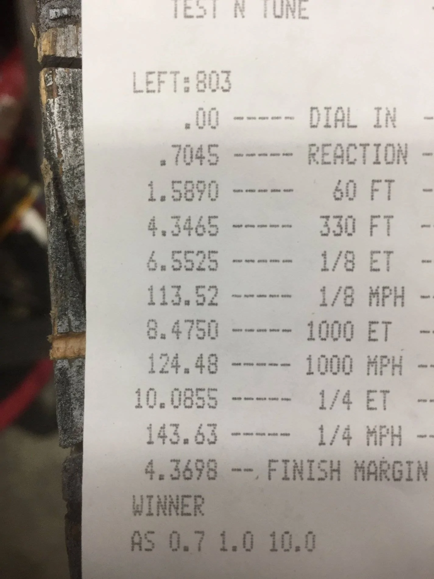

    D35D7D9F-17AC-4C33-BF1D-F647355D45F5.jpeg I’m running a stage 2 Whipple with E85, catless headers, 1050x’s with a dw400 and BAP. First time to the track with E85 but last pass of the year(busy with work trips -_-) with around 2100 DA, I went 10.08 @ 143.6mph on a 3.875 Pulley. Hoping in the spring I can get in the high 9s. This is with the stock drive shaft too. Ordered a QA1 CF Driveshaft for it so should be able to hit it 100%. Final goals to do to the car is maybe go down to 3.75 Pulley and add a return style fuel system for safety and that’s it. Fast enough for me already lol. Would like to post the video of me going down the track but it’s too long to upload -_-.

    It’s crazy to see so many cars at the same et but wildly different mph’s

    Crazy right ?
    I am assuming it’s the transmission tuning?
    Not really crazy about my current tune but my best ET of 9.7 was only at 140 mph . Fastest trap is 142 mph but without traction so only ran 9.8.
    I know my car a PP is heavy (at least 4300 lbs with me and full tank I always run) , different tracks /DA but I am bummed that others have trapped higher than I have with much bigger pulleys than my 3.25 .
    it also looks like my 02 sensors have kaput again so going to replace them and then get the car in the dyno to see how much power it’s making .
    If it’s down time for a compression test . Already looking at short block options . I would prefer a long block but this shit is getting too expensive !
    if the motor is good then it may be time to swap tuners .
