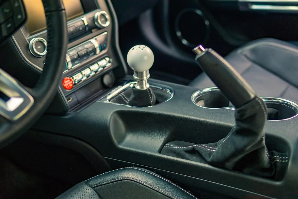

I have the brushed silver Barton. I actually replaced mine because my stock one was starting to disintegrate. It actually fell apart on the trip to JPM. It's really easy to get the trim ring off, just pull from the coin tray and work your way around. I did it at the same time as the JPM boots (had them do it since they were very close). Only tip I can offer is if you ever replace your boots, DON'T cut the threads like CJ says to do, cut the actual boot in notches (very short) and go longer to get the clearance you need, as if you cut the thread eventually it will unravel according to JPM.
here's a pic of my AM knob and the Barton lockout.

^^^^ thanks man. do you have to cut the stock boot to replace the rerseve lockout like CJ states in their vid? totally want to do this.

i would assume so. He just cut about 1/8 inch notches around the boot and slowly added small amounts of length to those cuts until he was able to squeeze it in.
