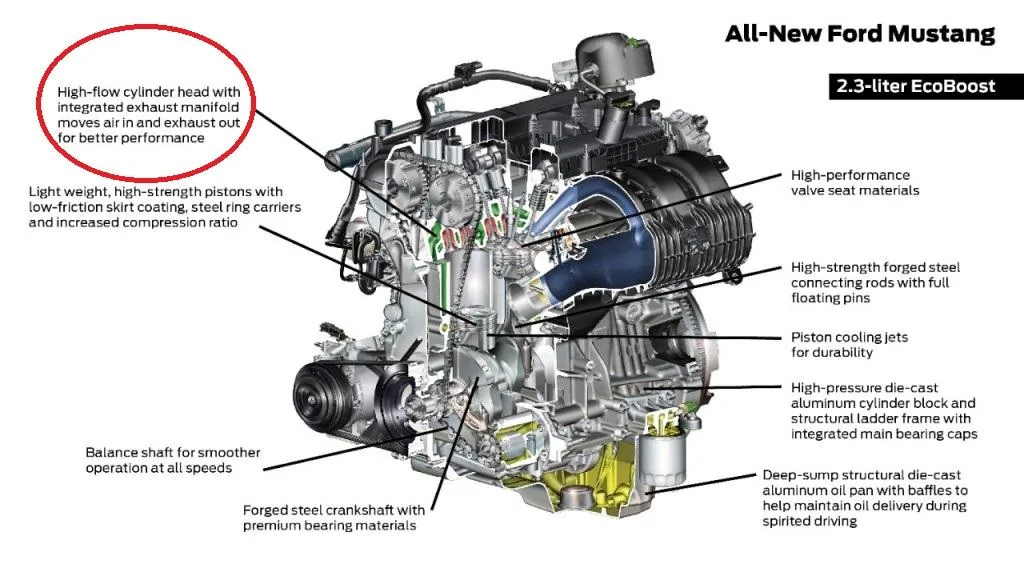

I just like the way it sounds. Would like it better if you could hear the turbo a bit though.

The integrated manifold isn't the reason it sounds the way it does. The entire 4 cylinder EcoBoost line sounds the same. Just comes down to chosen firing order.

Guys it is a combination of things but the most notable is the equal length exhaust header in the cylinder head. An equal length header is required for a twin scroll turbo to function properly (spool up fast with minimal lag).

SRT-4 had an integrated exhaust manifold and I think they sounded quite nice.
