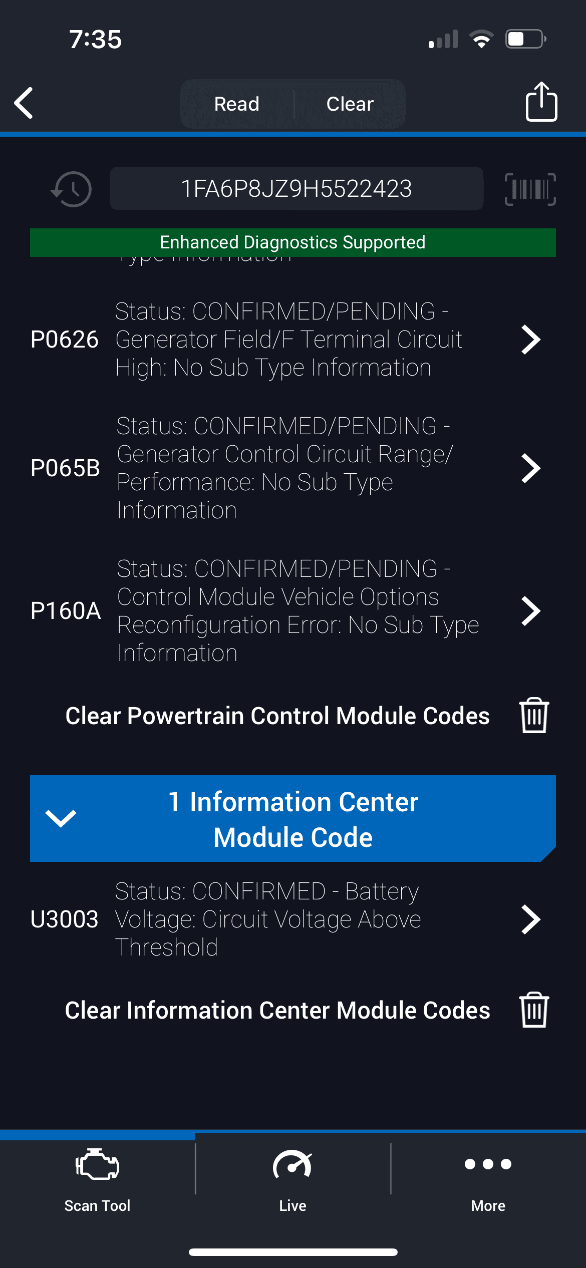

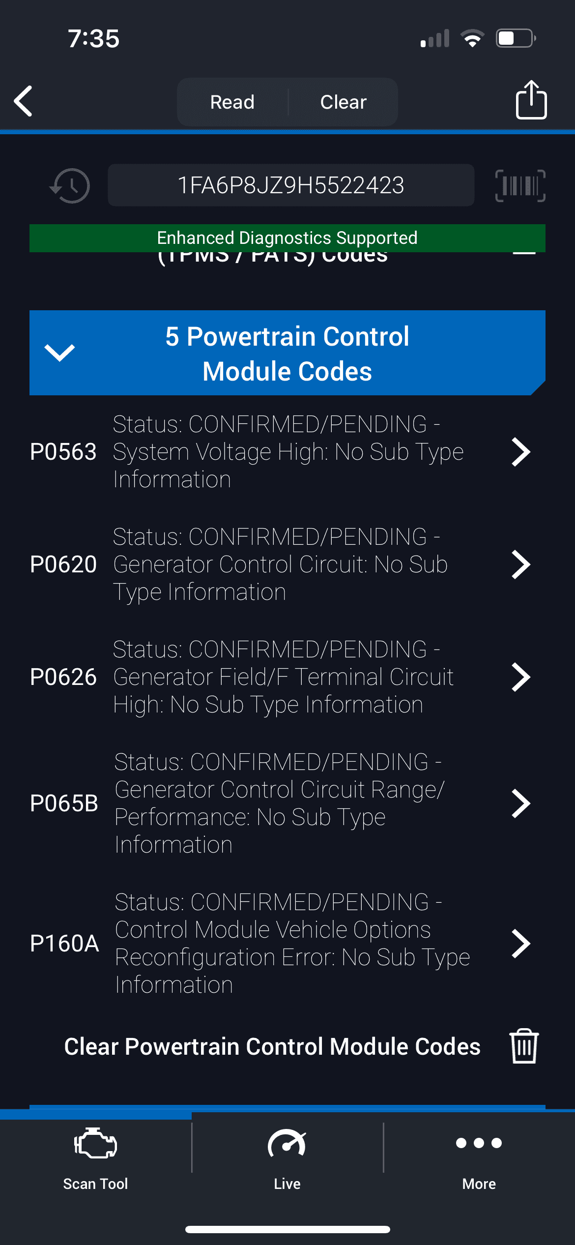

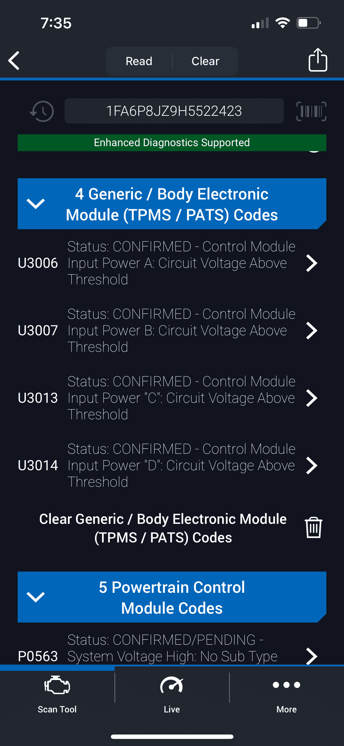

I’ll pull the codes when I get home from work

The code will tell us what it is but i bet on the wiring

Here are the codes I pulled. The connectors make sense. I’ll order that and replace it. I really appreciate everyone’s help! Thank you.

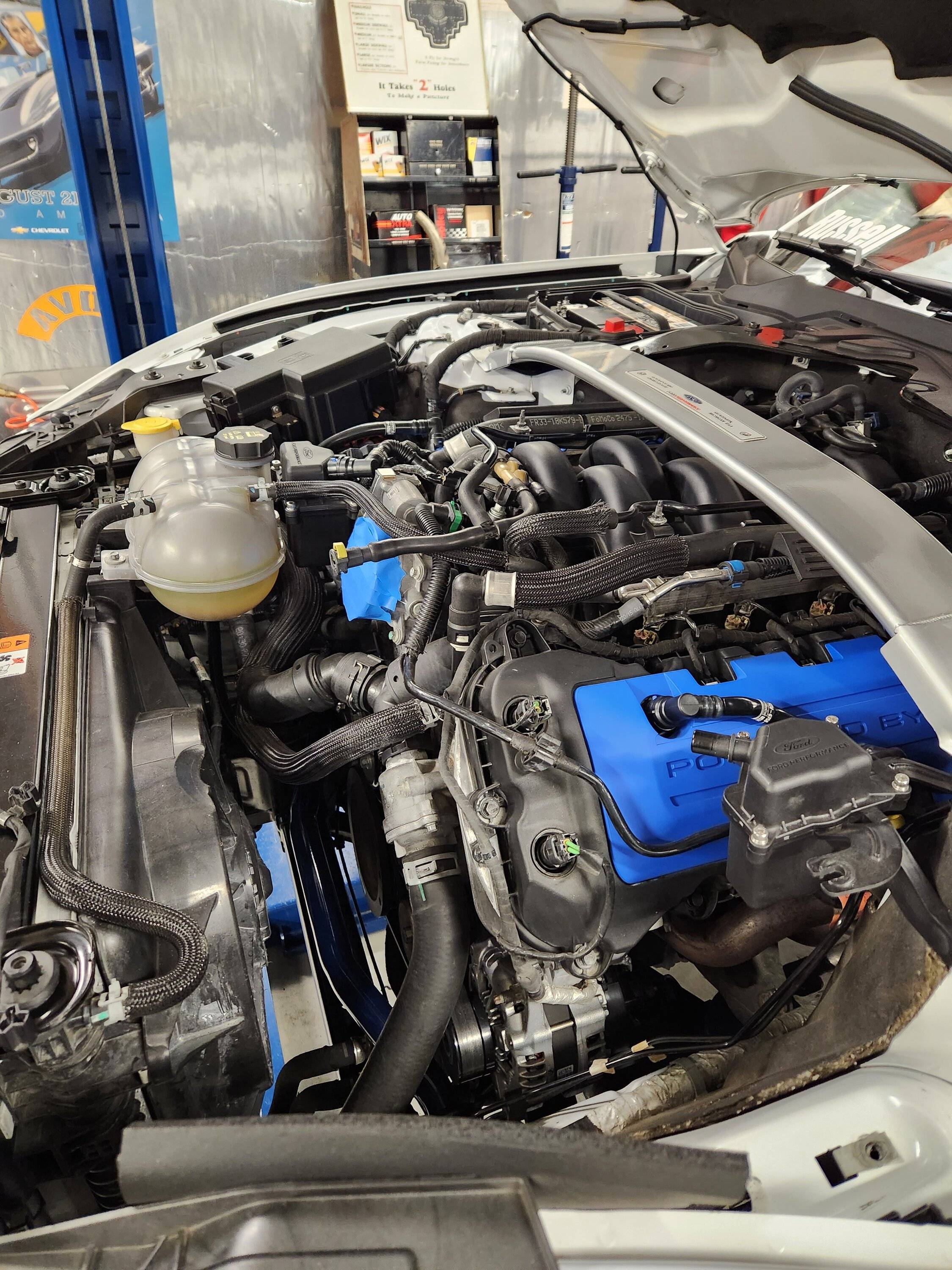

Yep - I just did mine. Pretty much as stated above - there are a couple additional steps, like pulling the serpentine belt tensioner (that's a single bolt) and the alternator (generator) body acts as a clamp, so you'll need to pry it gently towards the driver's side to get it to release. Once everything is disconnected and unbolted, it's then a matter of fishing it up and out (all the work is done from above with the intake tube and airbox removed).
Note that if you have a larger aftermarket sway bar, the bar and the bracket will make it a bit more difficult to fish the alternator up and out of the engine bay. I have the Ford Performance sway bar and it was so close I thought it wouldn't come out at first. It's just a matter of getting it clocked the proper orientation and then pushing the lower radiator hose enough to get the clearance needed. The whole thing can be done in an hour or so and I'd rank it very low on the PITA scale.
Here's a pic of the engine bay with the intake tube and airbox out of the way - still a tight fit.
