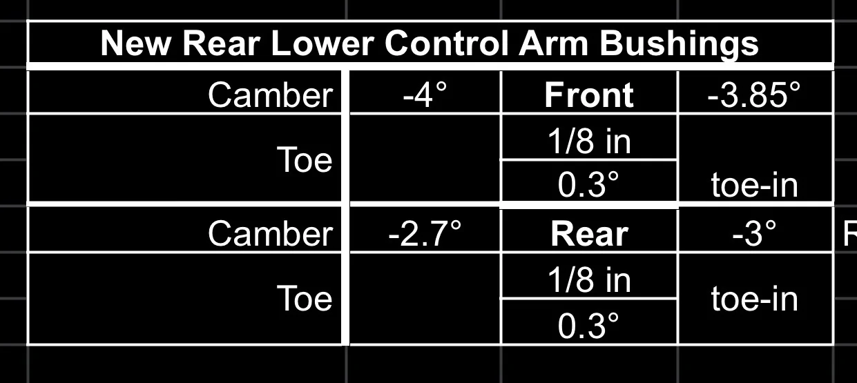

I do my own alignments, I have access to an alignment rack and everything. I have done camber before and you can get a bit past -3 camber without plates. Thank you for the info, I got some new camber arms for the rear and some poly bushings and was thinking about better alignment before the next autocross season
