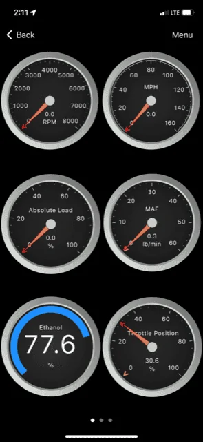

Yes, exactly...to look at the inferred alcohol percentage derived by the car's computer. I also monitor short and long term fuel trims, knock retard, etc. My usual routine is to bring up the app when I fuel up about 8 miles from my house. When I get home, I look at the phone to see what the alcohol percent has locked to. The fuel trims are an indication the inferred alcohol is close (the app also records min/max values so I can see what those have been throughout the drive). The knock retard parameter gives me a warm fuzzy that timing isn't being pulled.
Clearly this isn't like testing E85 at the pump or using an ethanol sensor in the fuel line, but it gives me a good idea about the computer's guess for the ethanol percent.

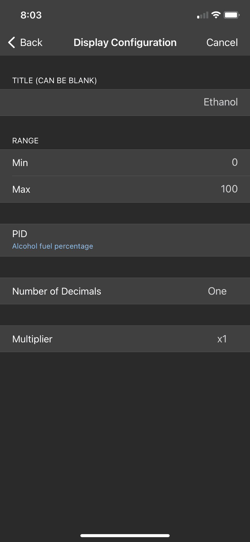

Could you explain or walk me through how you would set that up on the OBDlink mx+? That’s really cool that an OBD scanner would tell you the alcohol percentage. I’m interested in the item!

Here is a screenshot of the display configuration screen. All you need to do is click on the "PID' area and select "Alcohol fuel percentage" as shown.
If your tuner is using Ford factory values for the Low AFR endpoint and lock parameters in the flex tune, your ethanol reading on this gauge will lock to about 78% for ethanol content above 58% (after flashing or refueling, and a 10-15 minute drive). The tuner can use different values to allow the computer to infer anywhere from 0-100% ethanol, so your ethanol percentage may actually read all the way to 100%.
