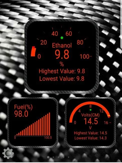

So since flashing the flex tune an ethanol % guage has appeared in the torque app. Cool!

It is pretty neat. I use the app every day pretty much. It takes about 2 miles of driving to adapt to a significant change in ethanol. Vary speed and load, try to keep the engine above 2000 rpm even if at a cruise.

For 93 I almost always see 9.8%. AFR seems ballpark correct for the indicated ethanol from what I see. My current tank is 48% E and it sits around 12:1 AFR, and low 10s when I have a full tank of 'E85' (78% E). On a tank of 93 it's around 14.1-14.2, so that's correct for E10.

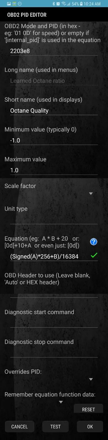

What is the OAR pid and formula? I would like to add that. I have added knock.

OAR only works on the ecoboosts. It never changes from 0 on the 5.0 so I'm assuming the 5.0 ecu doesnt have that function/tables or it's just disabled because it isn't needed.

So OAR does indeed work on the 5.0 flex tune. I stand corrected.
If you drive in drive mode at low rpms / high load the OAR will adjust itself pretty quickly.
Petro 94 mine is sitting at 9.8% ethanol / -0.34 OAR.
I would ideally like to see -1. Also it seems like the OAR will only readjust after a fill up of a few liters or more. Last fill up it set at -.08 so it's working it's way in the right direction.
Seems to operate the same as ethanol %. It adjusts after a fill up and then doesn't change until the next fill.

I know in the Focus ST (presumably in Ecoboost mustang as well) the OAR is just a multiplier. You have a timing table that will add/remove timing based on the OAR. It basically is just a learned knock value that adjusts over time.
