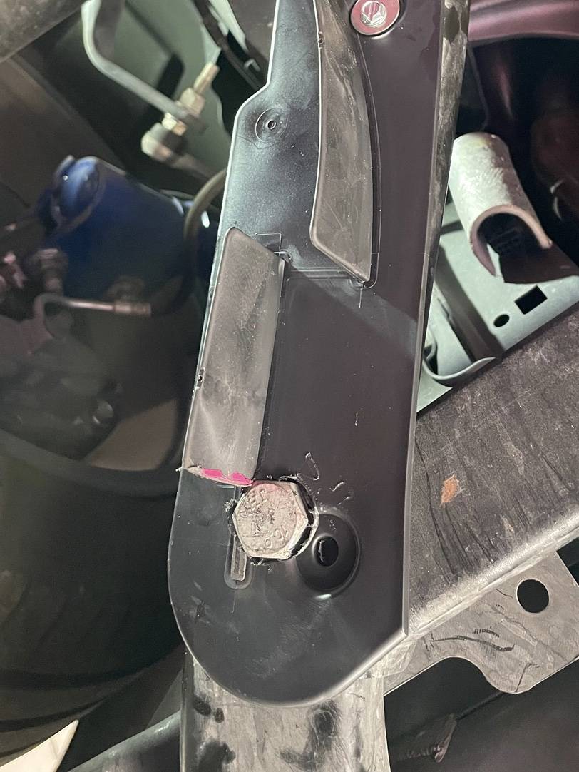

I’m going to steer we’ll clear of the aerodynamics and rpm discussions, but I am interested in this (and those two pictures) :
Although Steeda initially posted they work with the g-trac brace, but there is some mild modification needed. I have seen 2 installs where guys were very resourceful and trimmed the strake to fit around the g-trac, but after discussion with our 2 shop mechanics, we came up with a much better solution,
Is it possible that you / the mechanics could have fitted the item a little further forward ?
Other than Steeda’s comment, what prompts me ask the question, is the position of the original rear most mounting hole (the one you didn’t use) :
Unless it’s a trick of the camera angles, it looks like if you fitted it in that position but without the two point brace, that back hole would be in fresh air - or at the very best, in the side wall of the subframe ?
Would it have been possible to mount it further forward A) giving you less to trim or drill, and B) allowing the original rear mount to be used ?
I’m interested, as fitting this part got on my radar as soon as I knew about it :like:
Cheers,
WD :like:
It is forward as you can go, there is another subframe bracket that comes down and attaches to the k-member and blocks it from going any more forward. I have seen pics of two other installs, one trimmed the strake around the g-trac and one sandwiched the strake between the g-trac and ran the bolt right thru it (didn’t want to do that because I don’t want any flex there, the strake would act as a abs washer). The strake follows the shape of the k-member so you really can’t adjust it much. I know the pics are kind of deceiving.

As some of you have already seen, Ford is now installing air strakes on the k- member on the new gen7 performance stangs. I installed these today on my 22 GT Premium and from a functional aero view they should improve downforce by evacuating air faster from below the car (if it didn’t help Ford would of never spent the extra cash). Although Steeda initially posted they work with the g-trac brace, but there is some mild modification needed. I have seen 2 installs where guys were very resourceful and trimmed the strake to fit around the g-trac, but after discussion with our 2 shop mechanics, we came up with a much better solution, chalk mark where the g-trac bolts are and bore a hole thru the strake the same size as the bolt head with a dremmal and mount the strakes right over the bolt (see pics below). I would not recommend to even install the bottom screw in back, as it would go through the bolt washer, really no need as there is already a side fastener screw in rear as well. Overall very easy install and hoping to see a slight improvement in downforce. I will report back after some higher speed pulls. Btw, bought through Levittown Ford, considerably cheaper than the typical after market suppliers, saved around $45 😎

I forgot to mention there is a side mount fastener that you can not see in the pic that mounts to the side of the k-member where the bolt is, so it is pretty solid right there. The part # on the packing slip from Levittown Ford is PR3Z-9916A315-A.

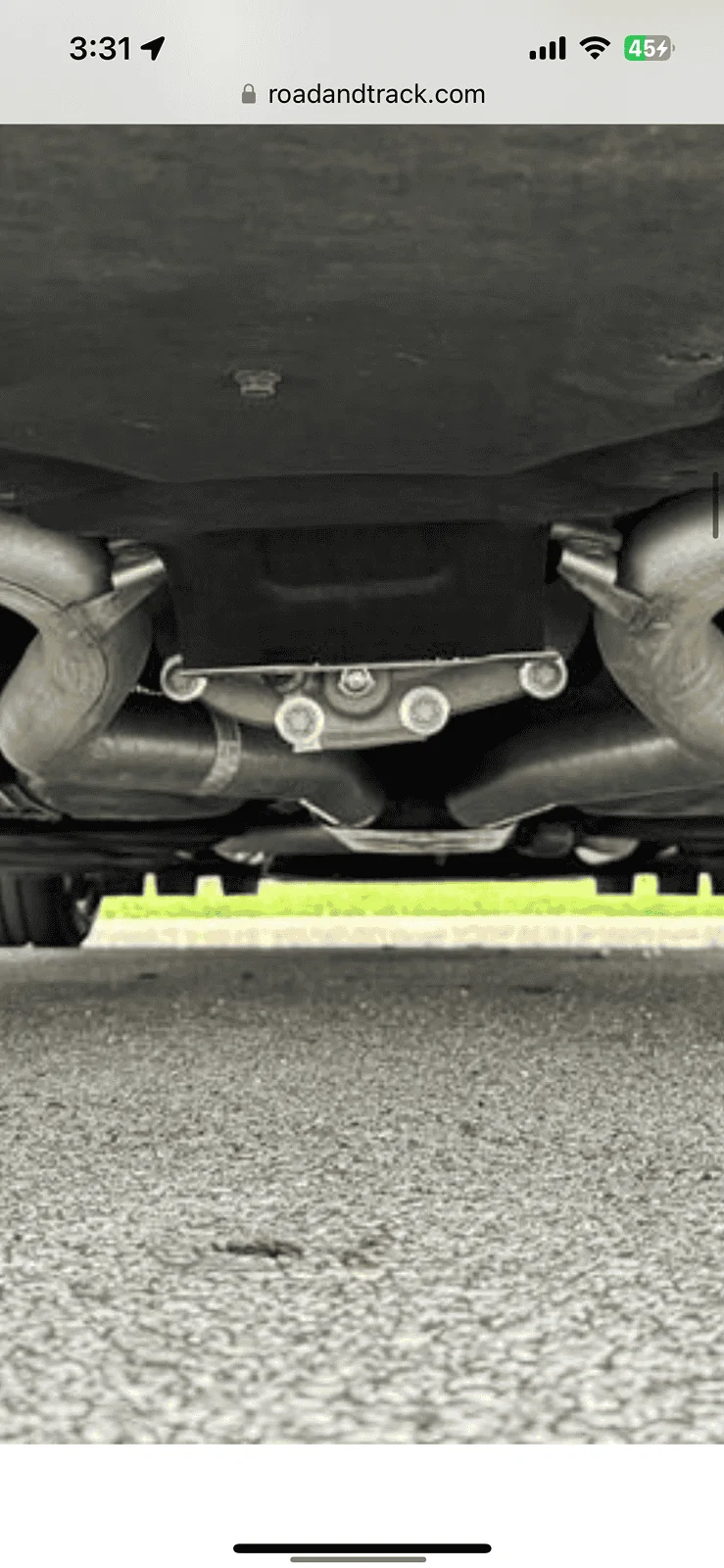

This is an interesting pic. Is it an optical illusion or is there some sort of cover on the rear diff
