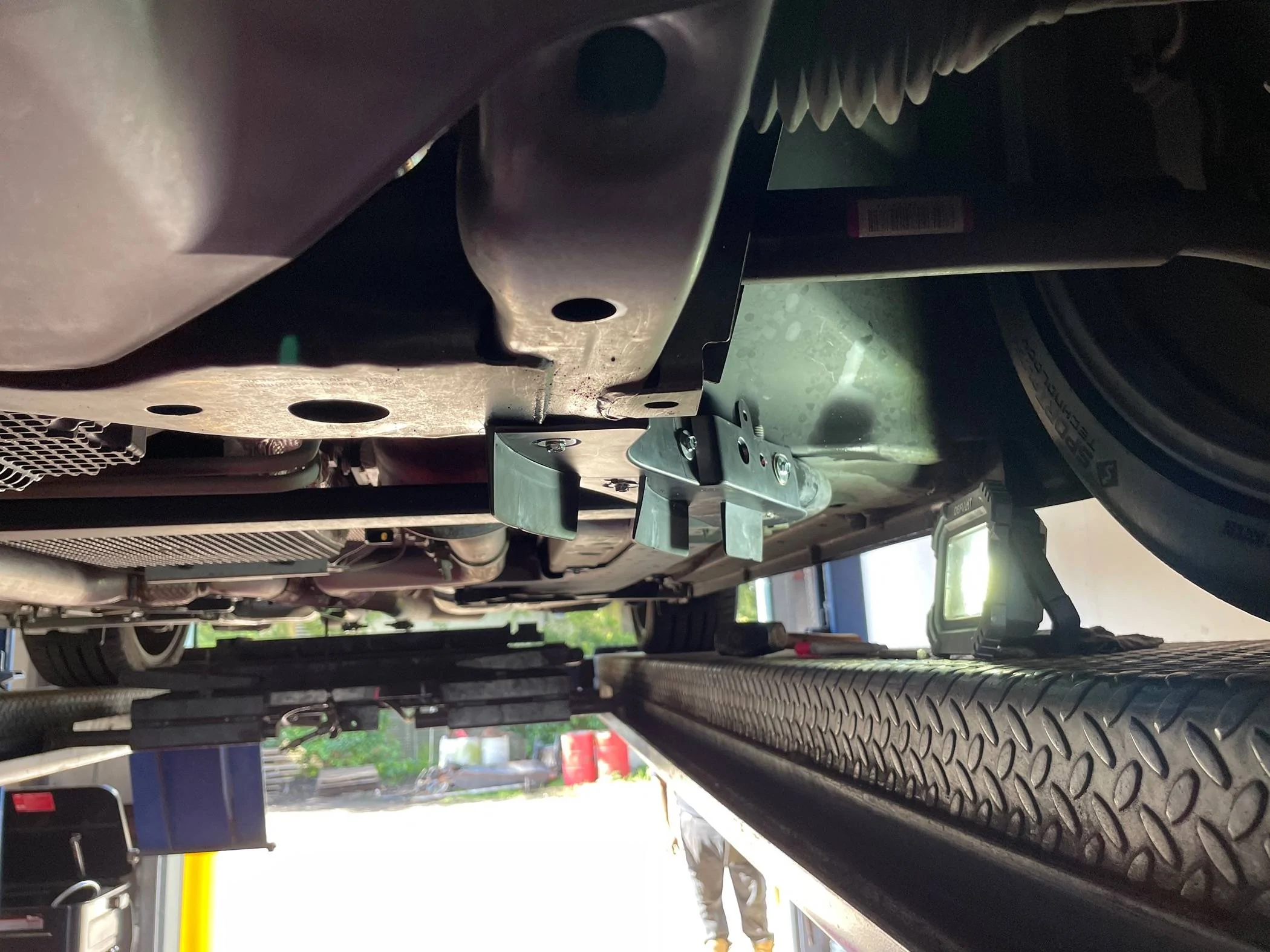

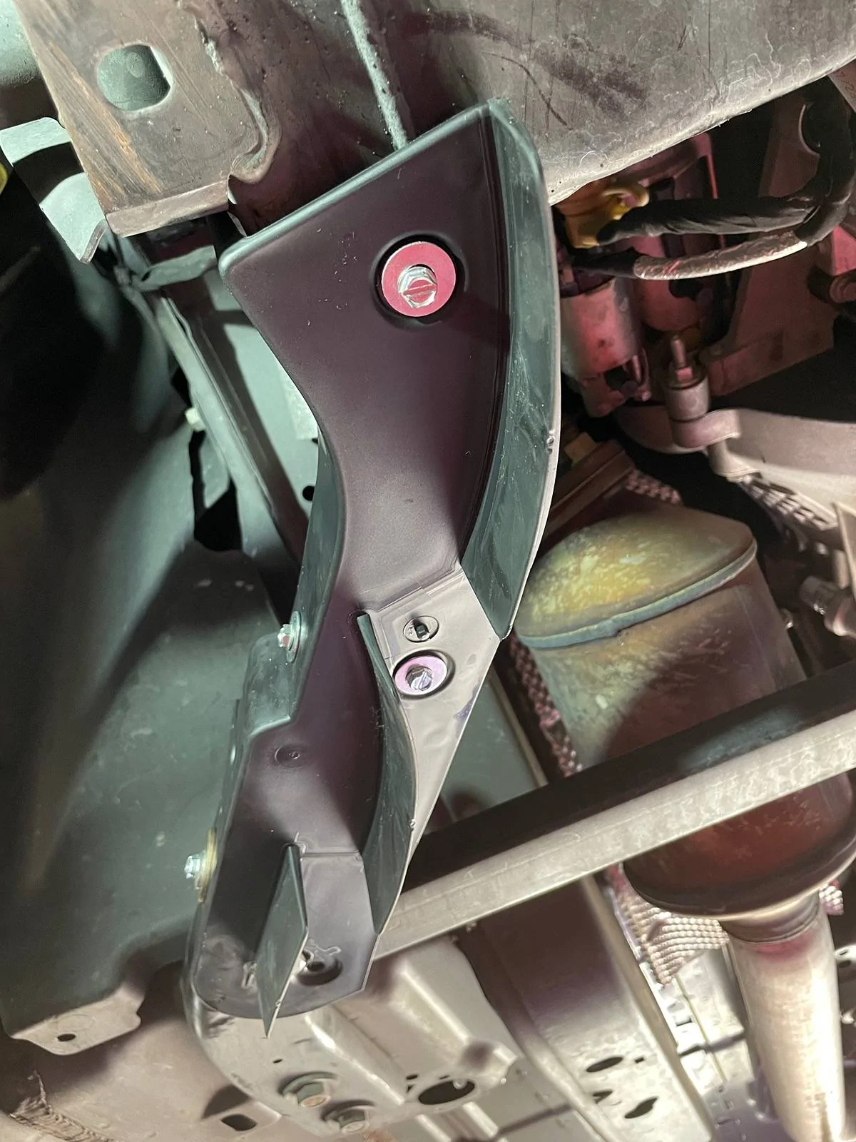

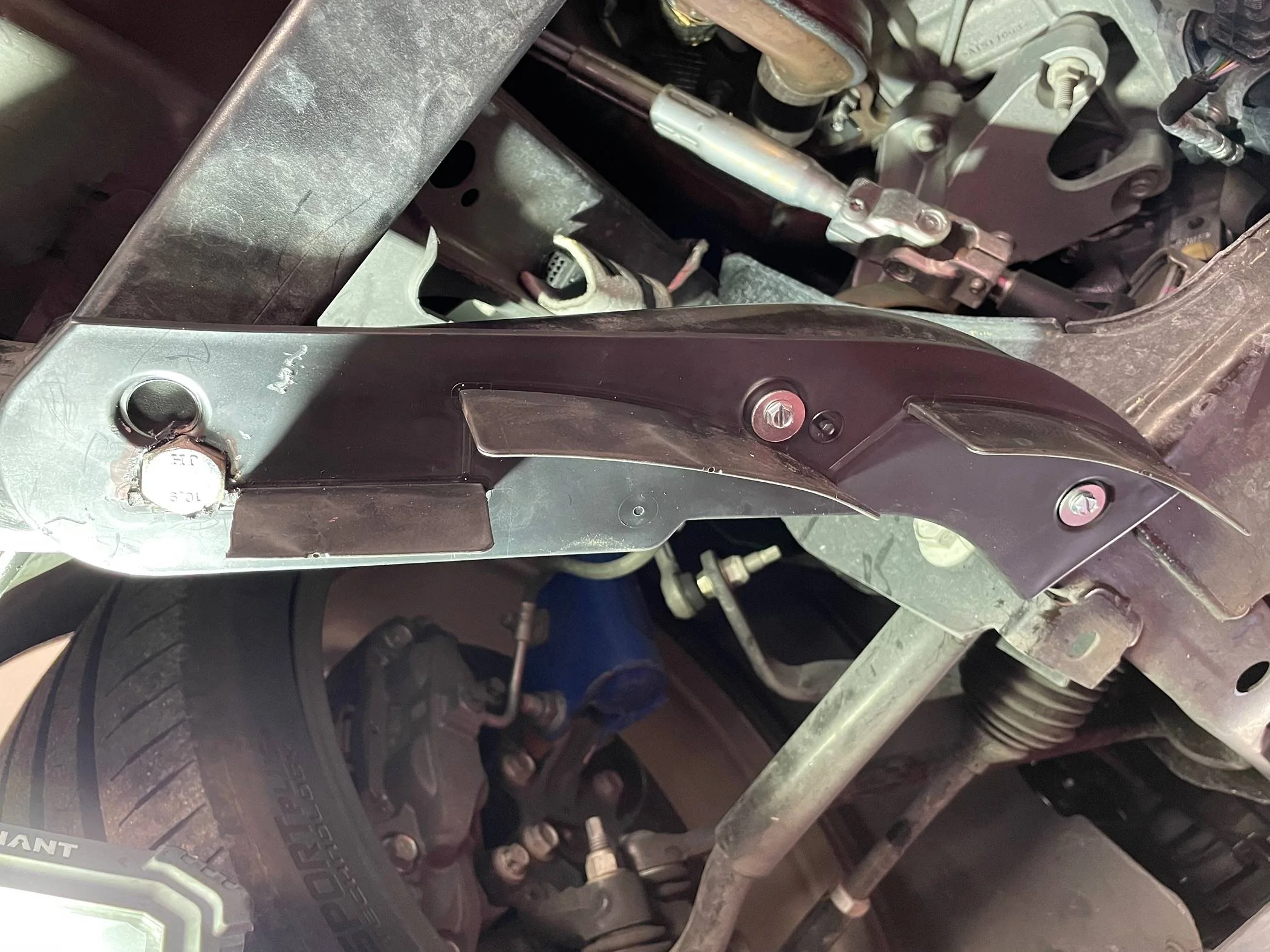

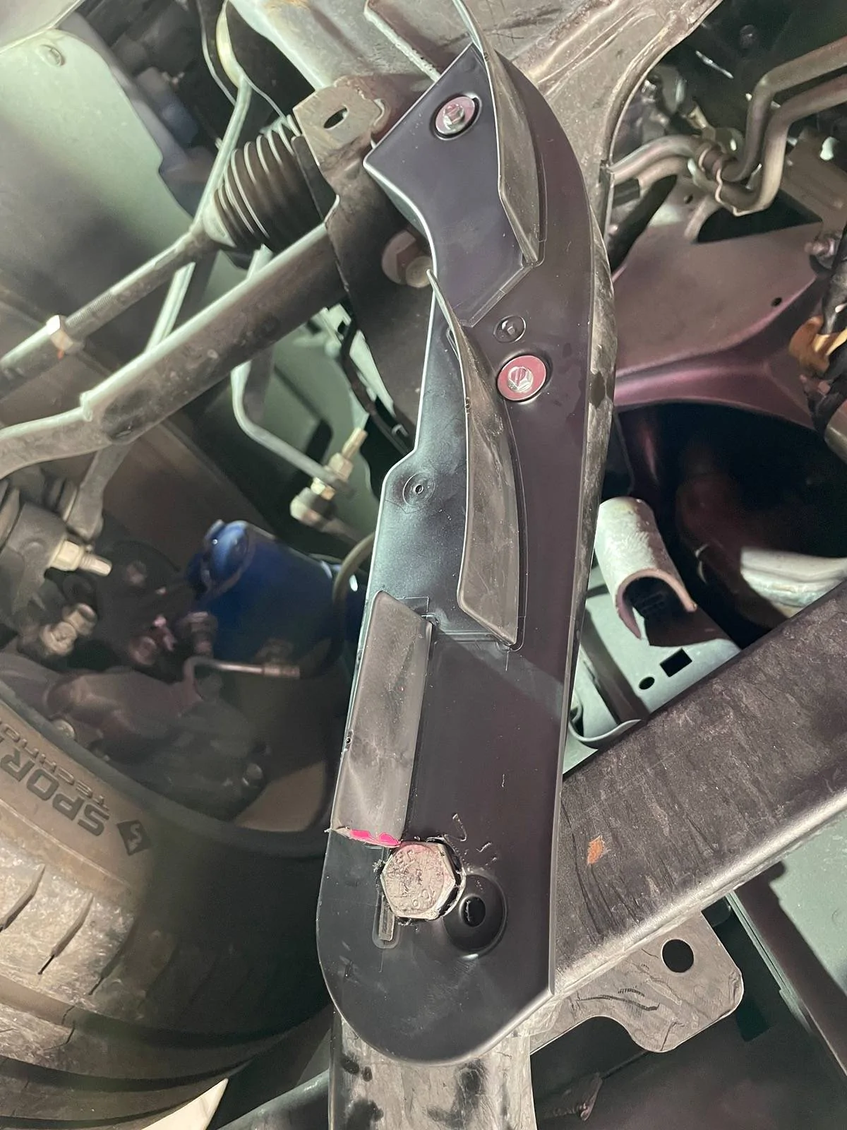

As some of you have already seen, Ford is now installing air strakes on the k- member on the new gen7 performance stangs. I installed these today on my 22 GT Premium and from a functional aero view they should improve downforce by evacuating air faster from below the car (if it didn’t help Ford would of never spent the extra cash). Although Steeda initially posted they work with the g-trac brace, but there is some mild modification needed. I have seen 2 installs where guys were very resourceful and trimmed the strake to fit around the g-trac, but after discussion with our 2 shop mechanics, we came up with a much better solution, chalk mark where the g-trac bolts are and bore a hole thru the strake the same size as the bolt head with a dremmal and mount the strakes right over the bolt (see pics below). I would not recommend to even install the bottom screw in back, as it would go through the bolt washer, really no need as there is already a side fastener screw in rear as well. Overall very easy install and hoping to see a slight improvement in downforce. I will report back after some higher speed pulls. Btw, bought through Levittown Ford, considerably cheaper than the typical after market suppliers, saved around $45 😎

This is mounted on an s550, the k-member is the same. My ride is lowered about a 1/2”, they do sit about 1/2-3/4” lower than the belly pan, but they are made of a flexable rubberized material that would just flex on a speed bump.

Without the g-trac brace, no alterations needed at all, fits perfect on the factory k- member on s550 and s650s. The work around with g-trac brace is fairly simple as described in the opening post.
