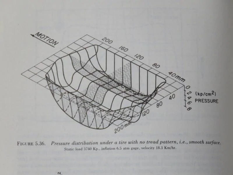

Less contact patch area isn't exactly the issue - it's things like the uniformity of loading on the contact patches (which can vary considerably from being uniform), and over-inflation tends to focus contact patch loading more toward the center of the tread.

There's also the fact that higher inflation pressure effectively makes the tire treads stiffer, which reduces the amount interlocking that happens between the tread surface and the roadway's aggregate surface roughness under vertical load. This is one of the components of overall tire grip and ultimately slip angles while cornering.

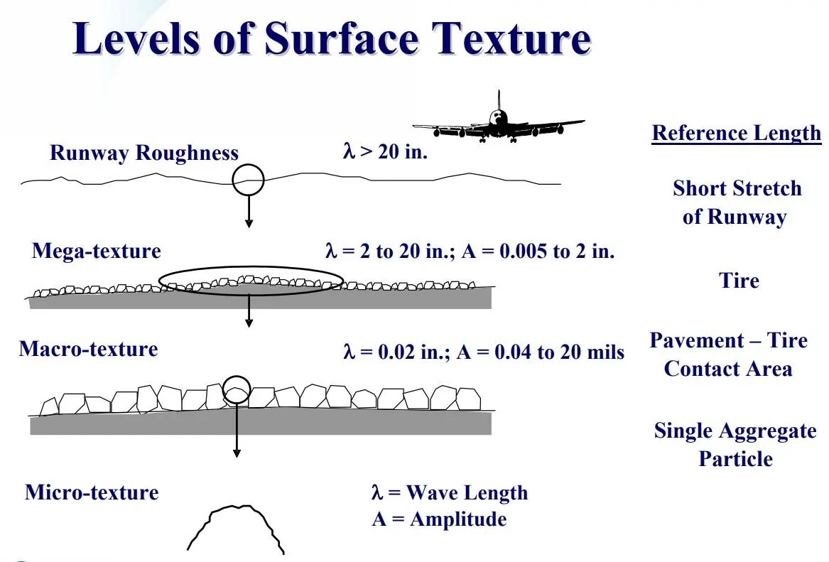

The Cliff's Notes hints regarding pavement roughness would be to consider autocrossers' comments regarding concrete vs asphalt lot surfaces in the dry or talk to any motorcycle rider who ever had to lay his bike down on the low side. Or any kid who skinned a knee falling off of a bicycle or skateboard.
Best picture I could find right away - just substitute street or track surfaces for runway.

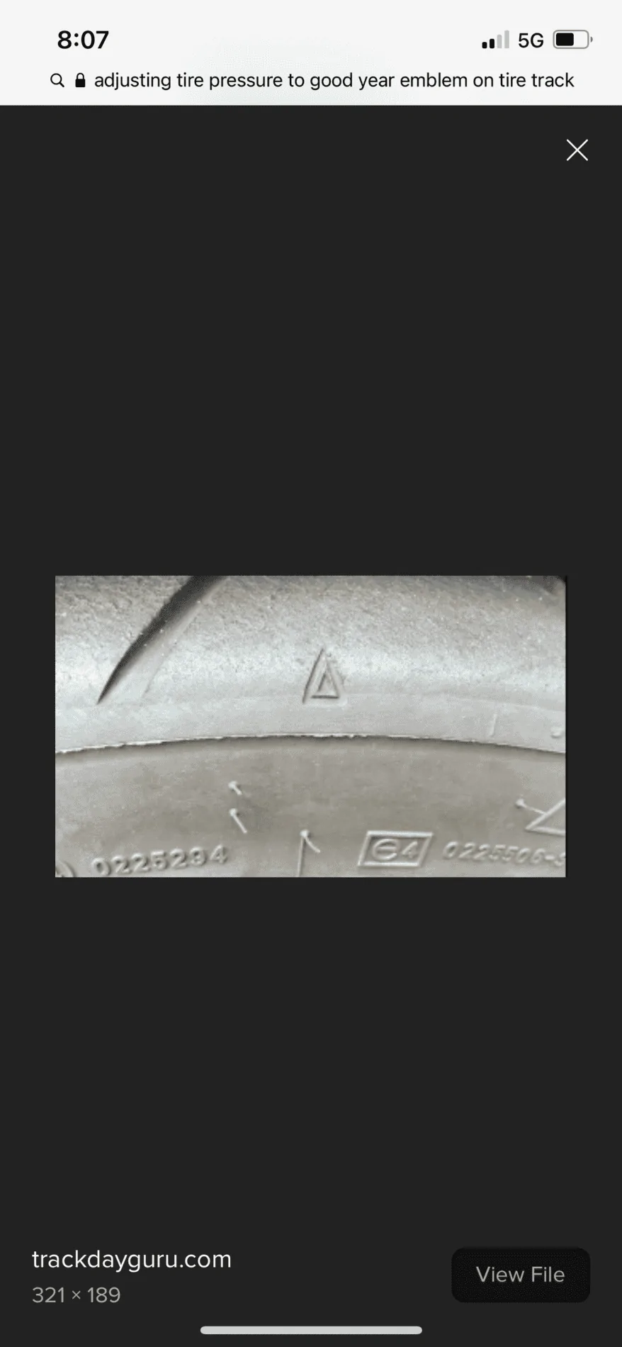

I don’t think I’ve ever seen it mentioned online, and I had no idea, nor did my track buddy that’s been tracking his 911 for 13 years. Until my last instructor showed me.
So he showed me a neat little trick on my GoodYear SuperCar3’s….there is a GoodYear “wing” emblem, on the side of the tire. For track, you adjust your pressure on each tire until you’re scrubbing the tip of the wing.
So I checked Michelin’s - same deal, there is a marker, but it’s a little “balloon man”.
This seems so very simple to me, and last track day after adjusting the first session I was spot on, and the car felt amazing.
Not sure if this is just common sense that everyone knows, but it sure seems like it’s a really good starting/reference point for anyone adjusting pressure for track.
My instructor said tire MFG will also put an “arrow”, I just googled it, and this looks like he was correct.

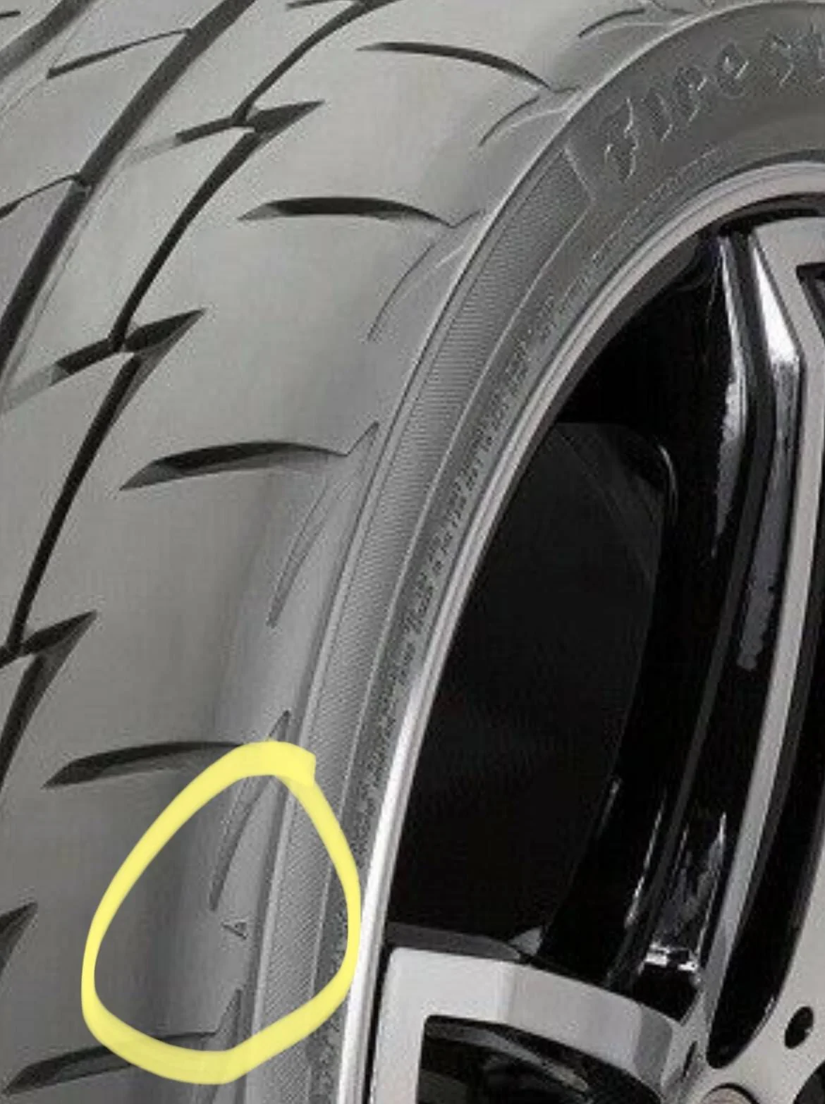

Is every tire like that? I have Firehawk Indy 500s.

I’m pretty sure most any “summer performance” tire would be. Run out and check :-)
