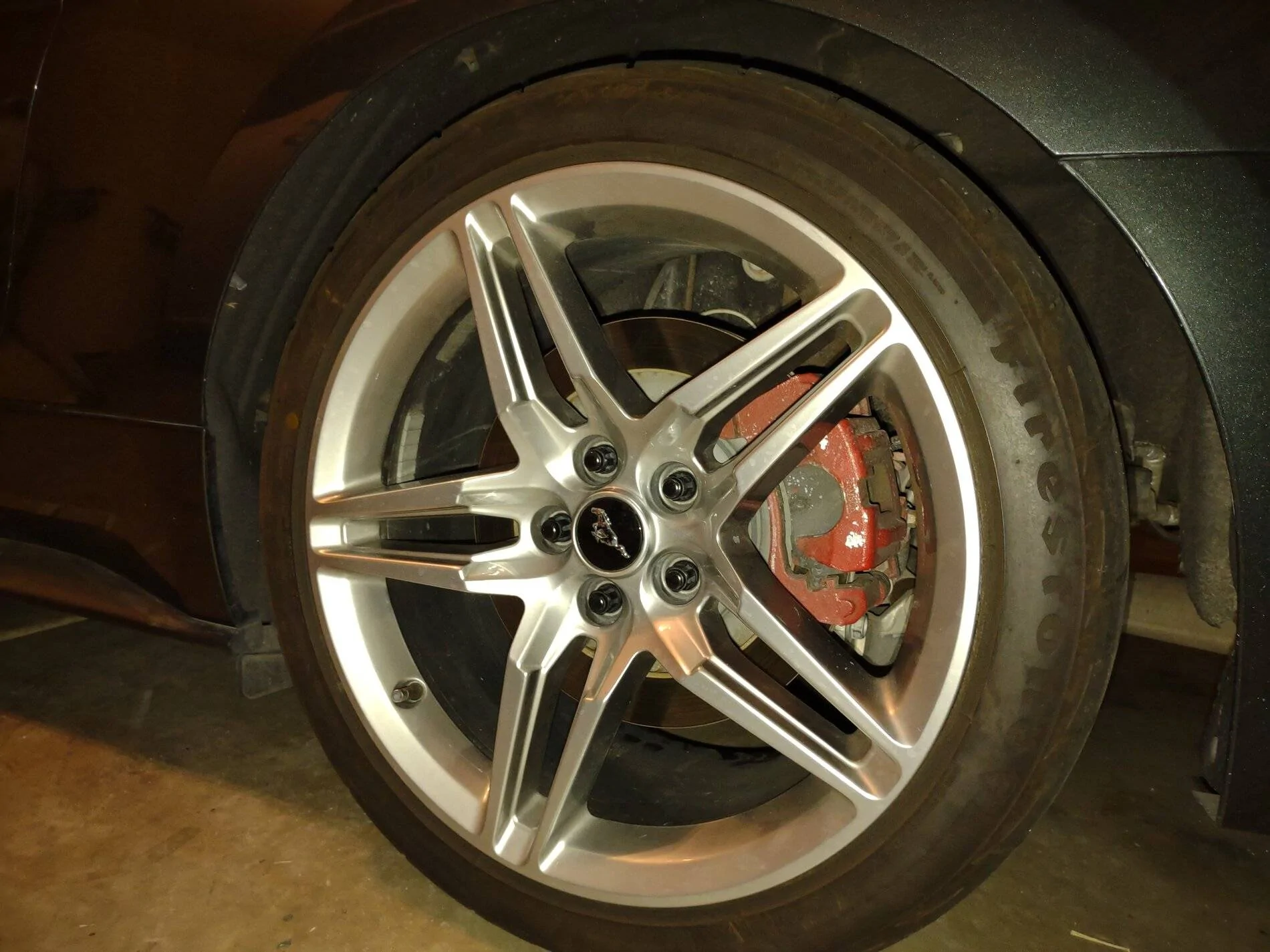

To run them that low. Won't they run off the beads?
If you don't have camber, you'll go a whole lot lower on the sidewall than those markers.
You'll be fine, stop worrying. Aim for 38psi hot, get some camber eventually, and you're good to go

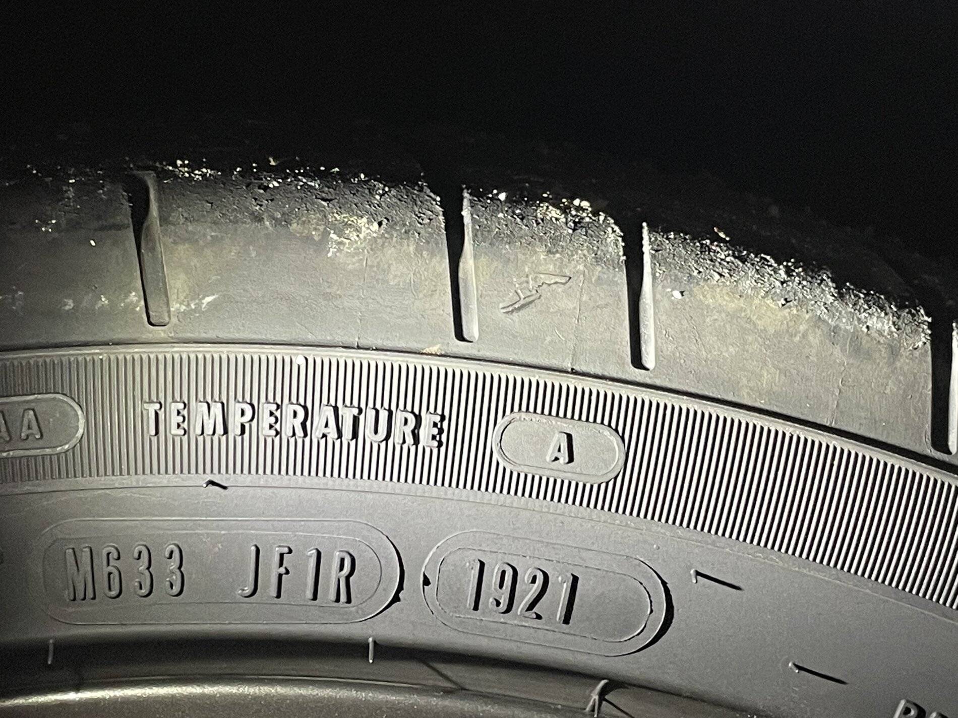

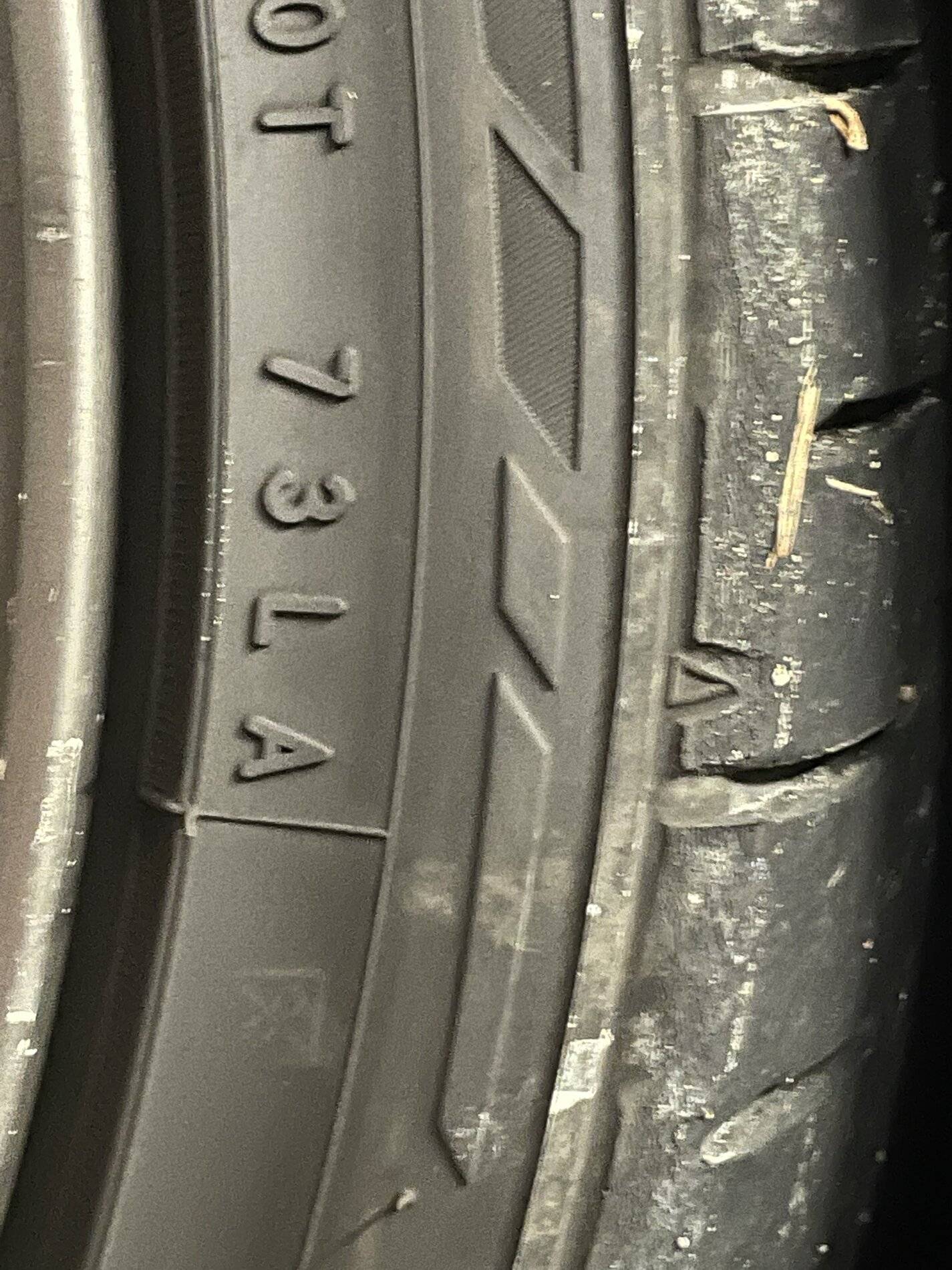

I don’t think I’ve ever seen it mentioned online, and I had no idea, nor did my track buddy that’s been tracking his 911 for 13 years. Until my last instructor showed me.
So he showed me a neat little trick on my GoodYear SuperCar3’s….there is a GoodYear “wing” emblem, on the side of the tire. For track, you adjust your pressure on each tire until you’re scrubbing the tip of the wing.
So I checked Michelin’s - same deal, there is a marker, but it’s a little “balloon man”.
This seems so very simple to me, and last track day after adjusting the first session I was spot on, and the car felt amazing.
Not sure if this is just common sense that everyone knows, but it sure seems like it’s a really good starting/reference point for anyone adjusting pressure for track.
My instructor said tire MFG will also put an “arrow”, I just googled it, and this looks like he was correct.
Your instructor is both right and wrong
Yes, tires do have a reference mark that you don’t want to go over but tire pressure is not the only reason why you would go over or not
The other main and even more importantly factor is camber
Let’s say that you don’t have enough negative camber in front and the tire is rolling over the symbol, jacking up the tire pressure to solve this issue is not only the wrong way to correct the issue but could also increase understeer by reducing front traction
