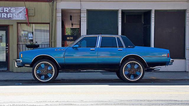

Too aggressive? :D

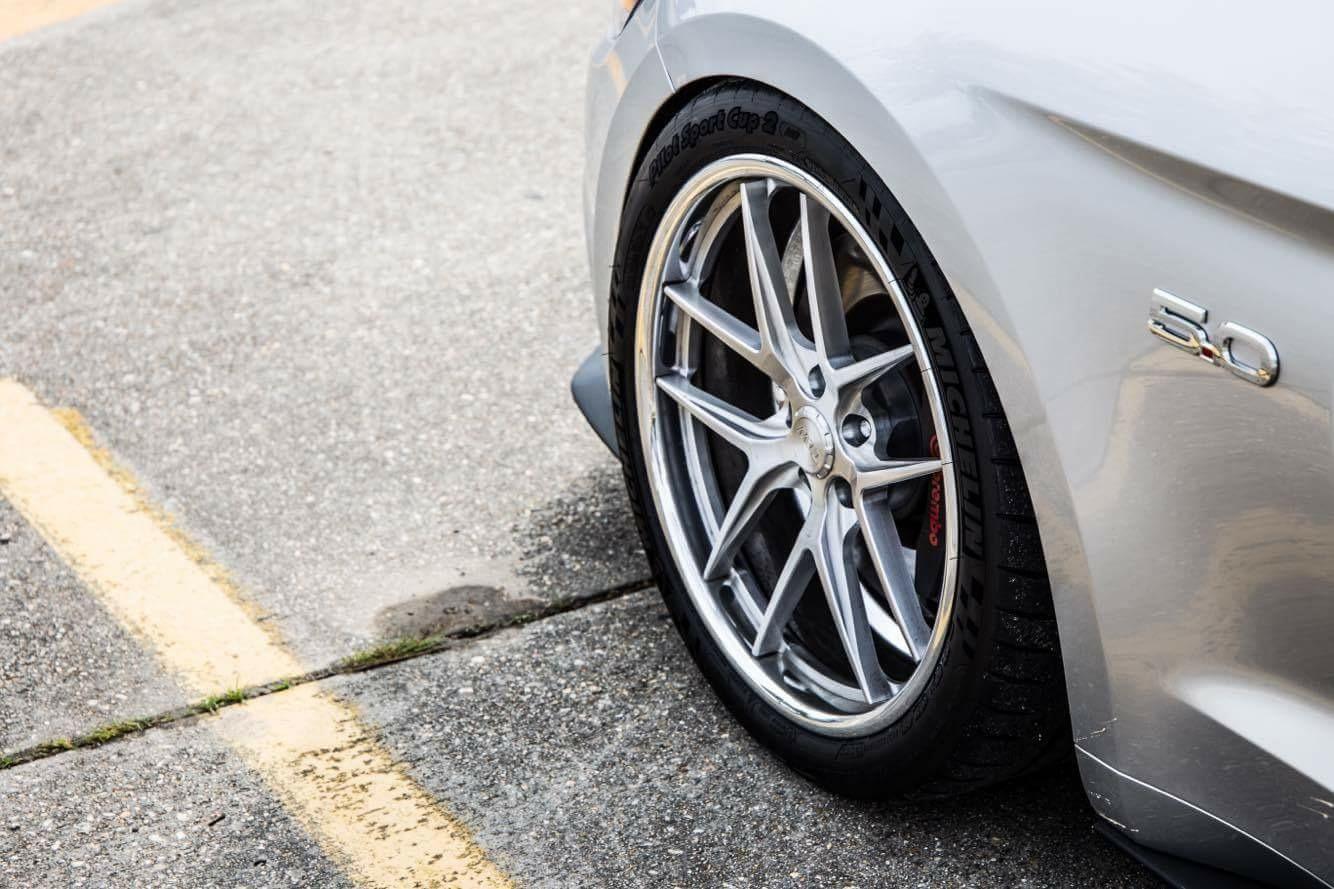

Steeda ultralites and CCW DS 570s 20x9 +25 and 20x10.5 +48. Fit as flush as possible.

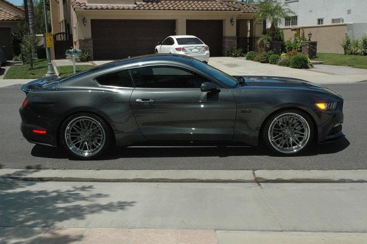

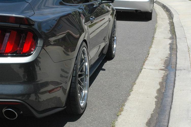

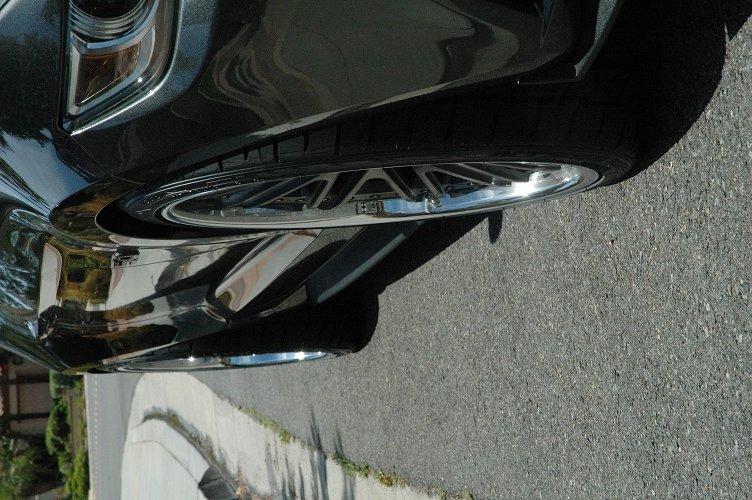

Individ Concepts step lip with titanium brushed centers
Fronts 20 x 10 Nitto 555 g2 275/30
Rears 20 x 11 Nitto 555 G2305/30
Wheels look great, nice choice!
