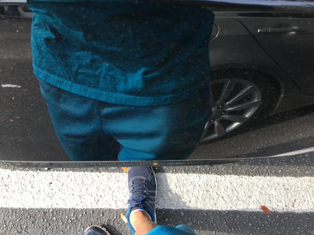

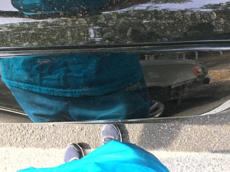

Back wheel pokes 5mm or so. +30 with 275 would be flush in the rear.
Picture of the rear poke on mine.
Front is flush.

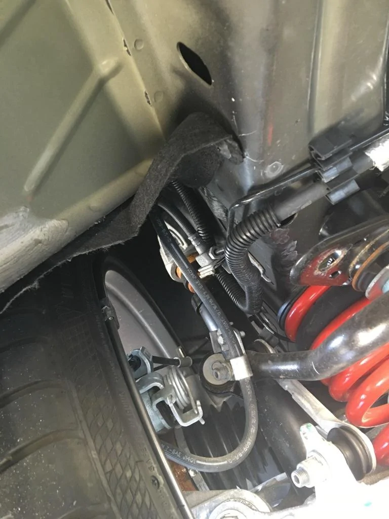

How much inboard clearance do you have?
The rears I have from my 2013 sit almost 20mm more inboard at the face, and over 30mm more inboard at the back end... thinking I might need a 15mil spacer for them
The fronts are almost exactly 20mm inboard overall.

Almost 4" inboard room in the rear measured at the wheel. Tires are stretched a little so should be more room at them but hard to measure because I'm so low in back. 20" Wheel clears the shock mount easily being this low so it's a non issue for me.

Holy shit! These cars have a lot of room to grow, apparently!!
Thanks, man. :) Test fit on stock suspension is going to be fun, I think!
