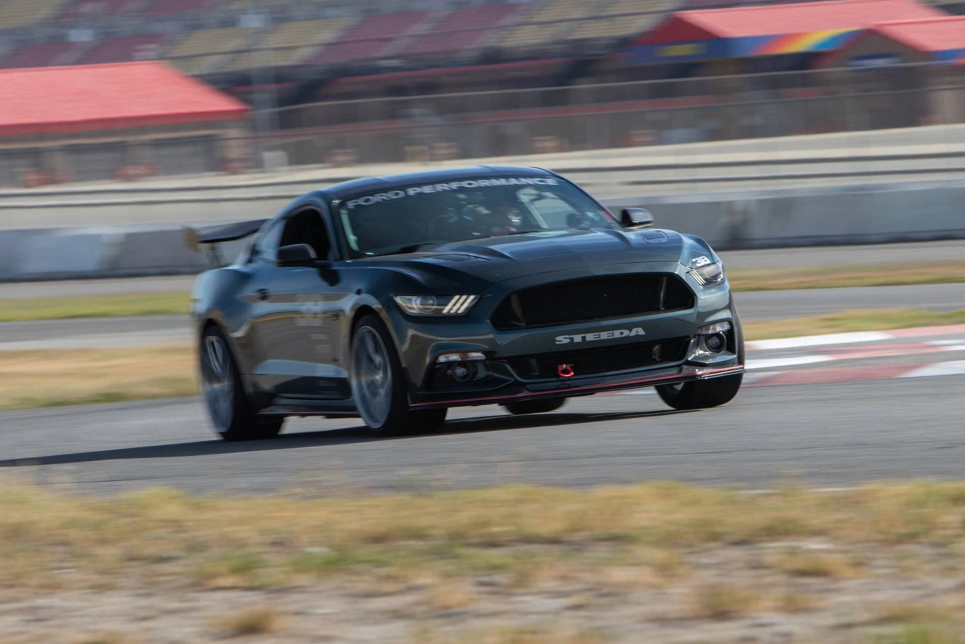

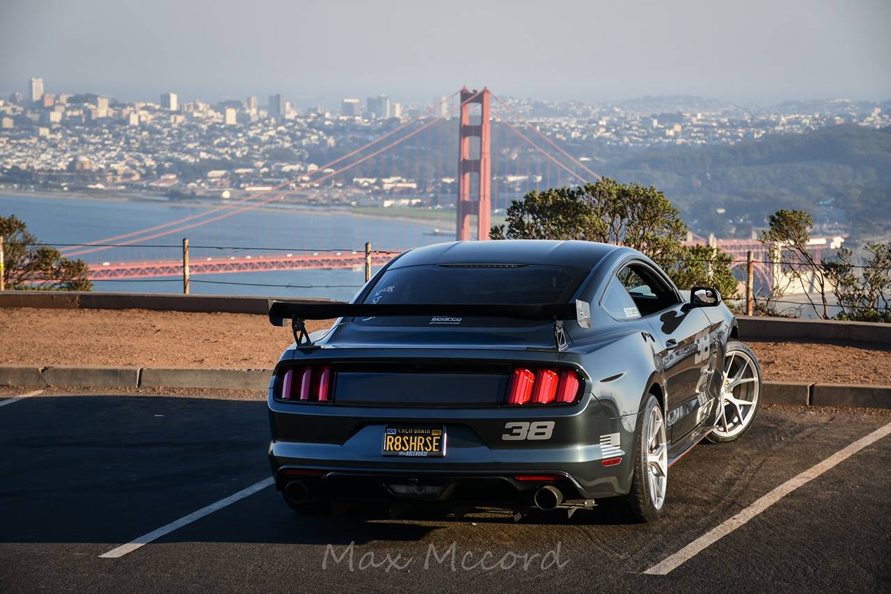

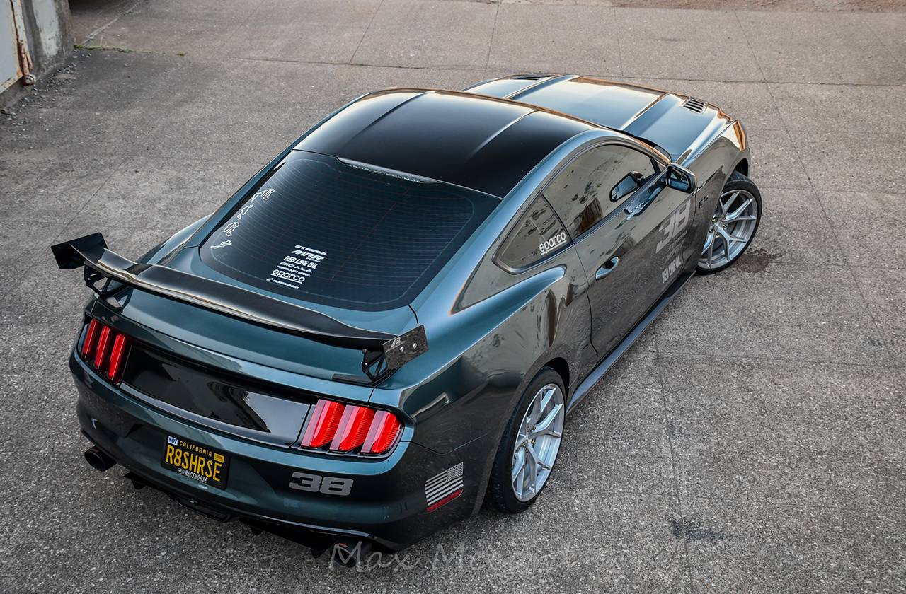

2morrow
DesignR/DriveR/RiceEatR
Nov 15, 2015
58
6,500
6,120
NorCal Bay Area
Todd
'16 Mustang GTPP
Wheel specs? Is that guard?!!
The wheels are 19x11 +52 square. The fronts require a 25 mil spacer and I usually run -2° to -2.5° depending on what track I'm at.
And yes it is a guard car. :like: lots if content on my IG in my signature if you're interested.
