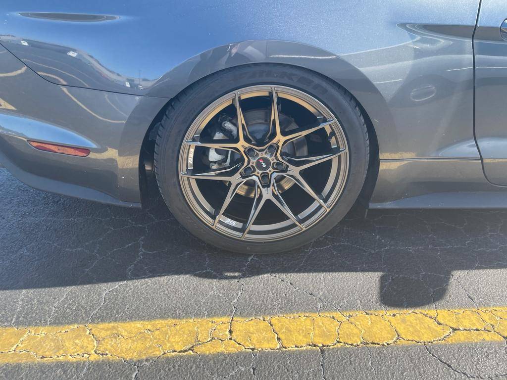

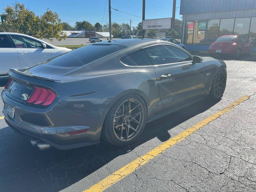

Shout out to vibe for hooking me up with these Savini wheelsLooks spot on! Thanks for sharing

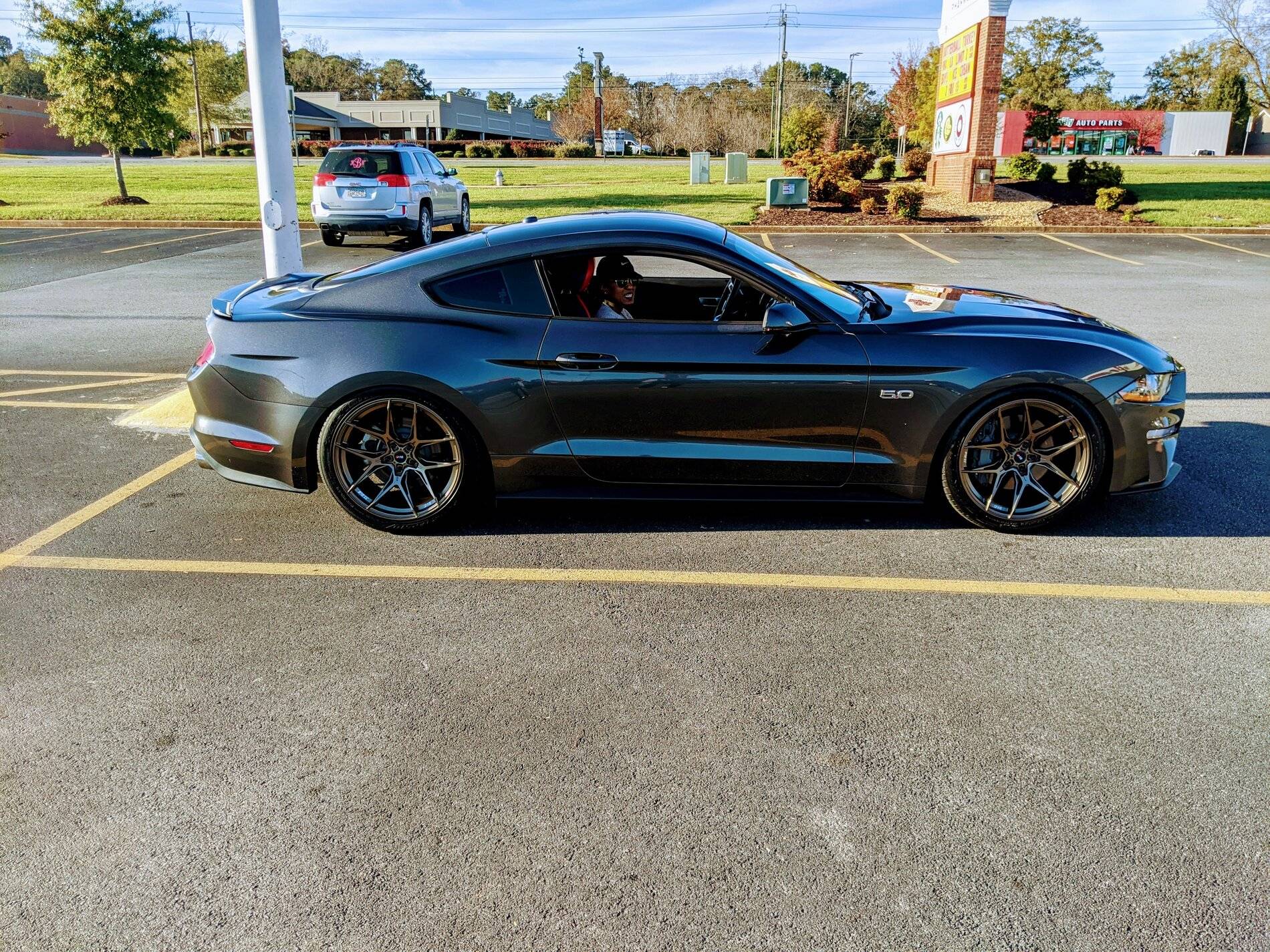

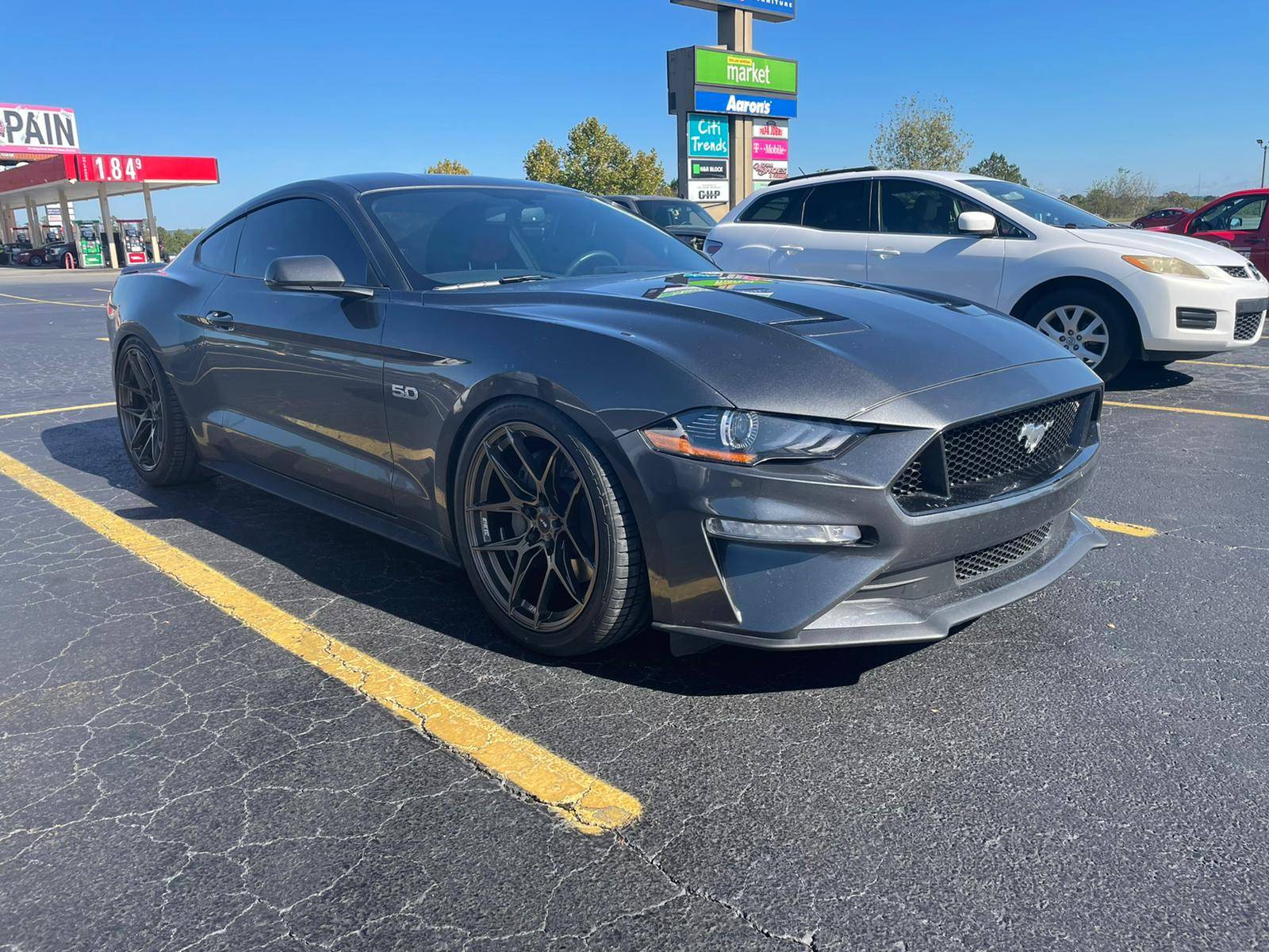

I'm running camber. These wheels are more concave than they look and the front required a 3 mm spacer to clear this ride heightNot sure I'd consider those an aggressive fitment. Everything appears to be tucked in the fender wells.
They are SAVINI SV-F5 They just came out this year around March, but I just got mine a few weeks ago. Matte Bronze

Lol salt10" wide square is done on S550's all day long. Not really considered an "aggressive" fitment.
