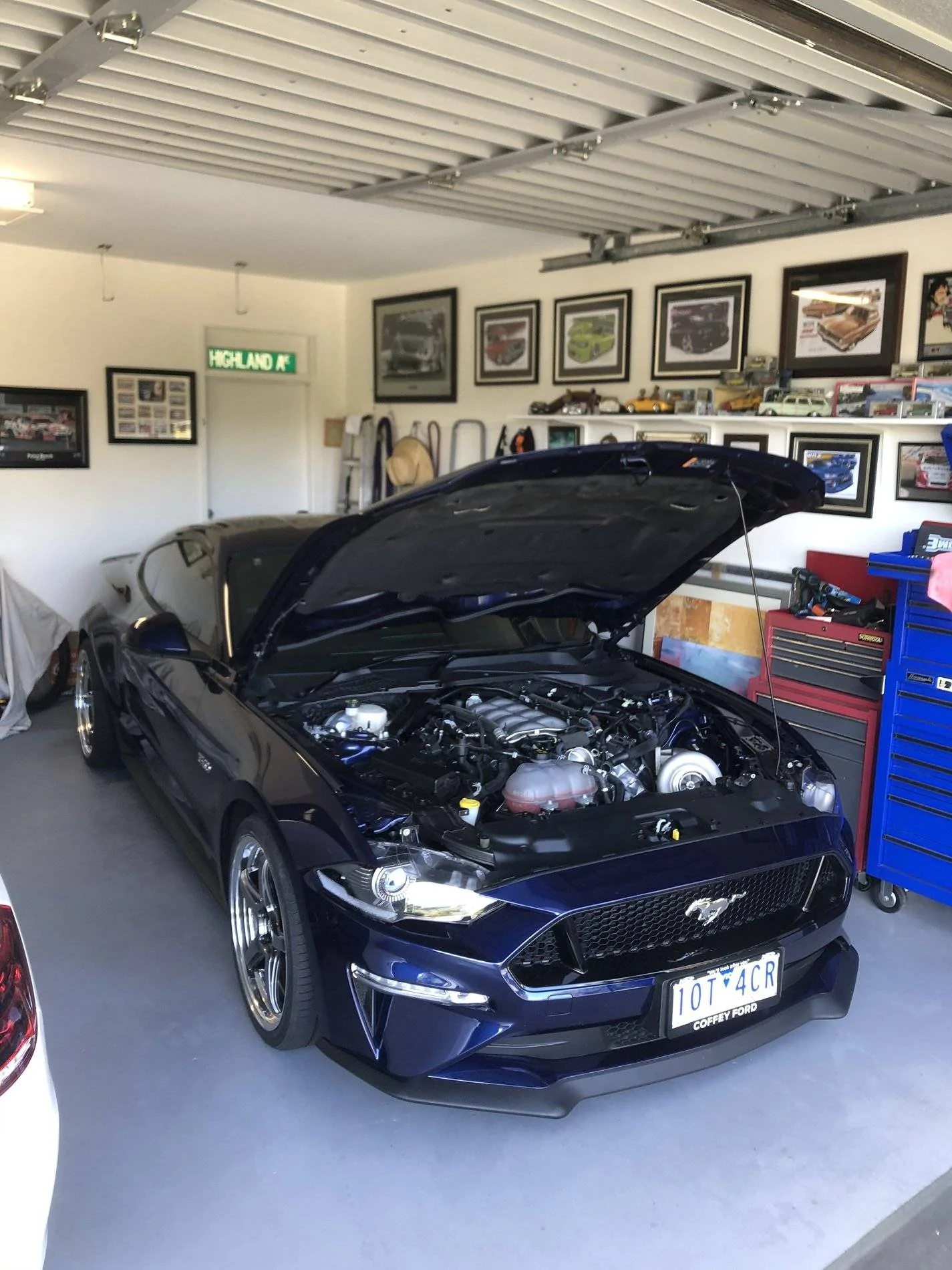

Tim
2018 GT
Work T5R 2pce

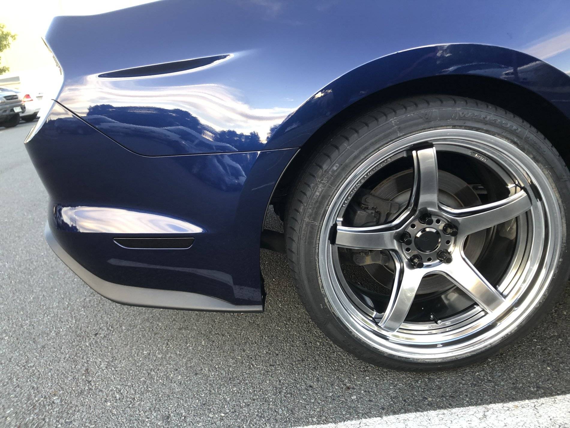

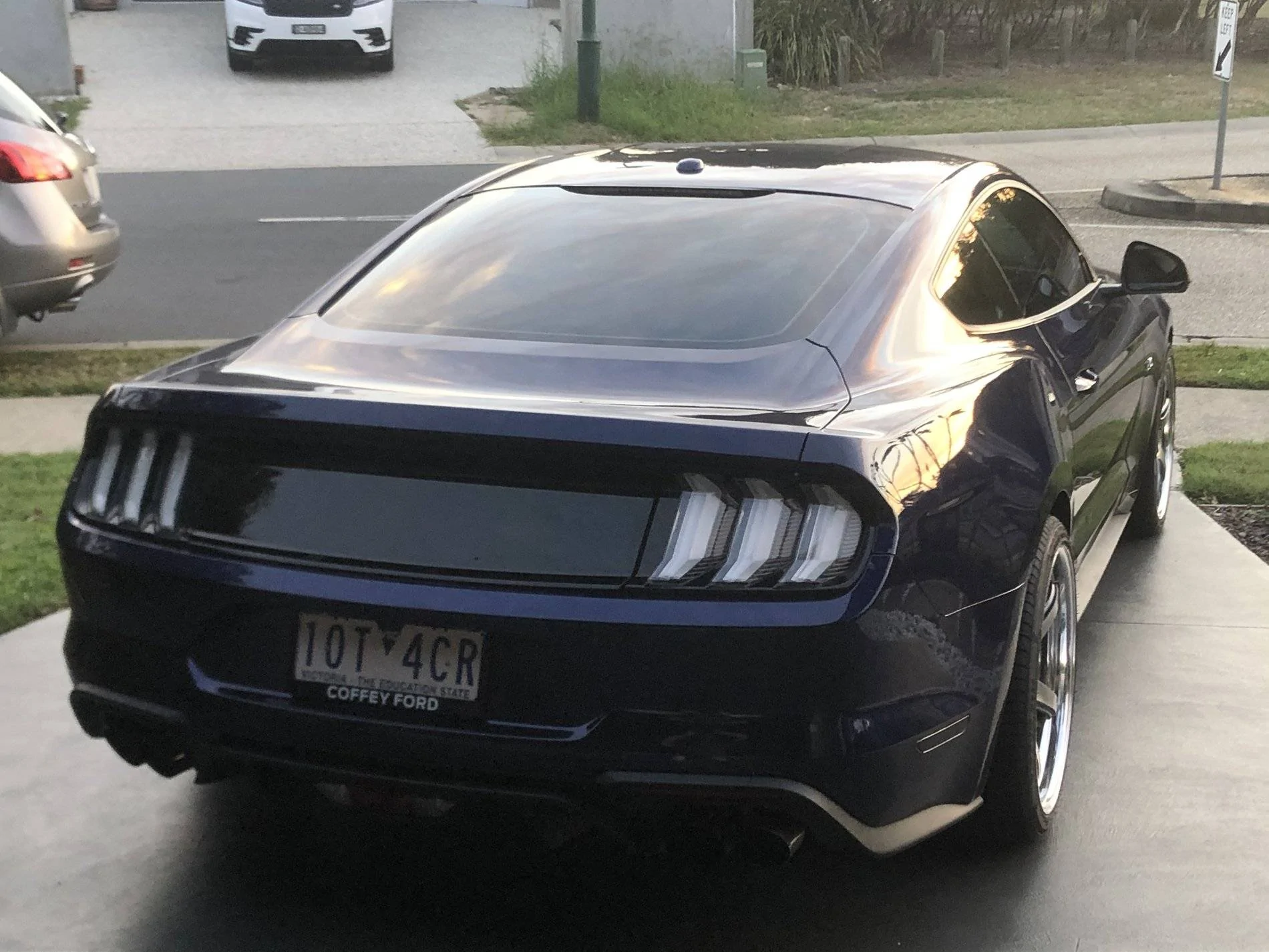

front 20x9 +30 255/35R20 upgrading this week to 275/40R20 for a bigger tyre.
(15mm front spacer) so +15 current offset (soon to be a 21 or 22mm spacer) with camber coming soon.
rear 20x11 +41 295/30R20 upgrading rear tyres this week to 315/35R20 for a bigger tyre.
still on factory suspension. In 3 weeks it will have BC coilovers. And will update then

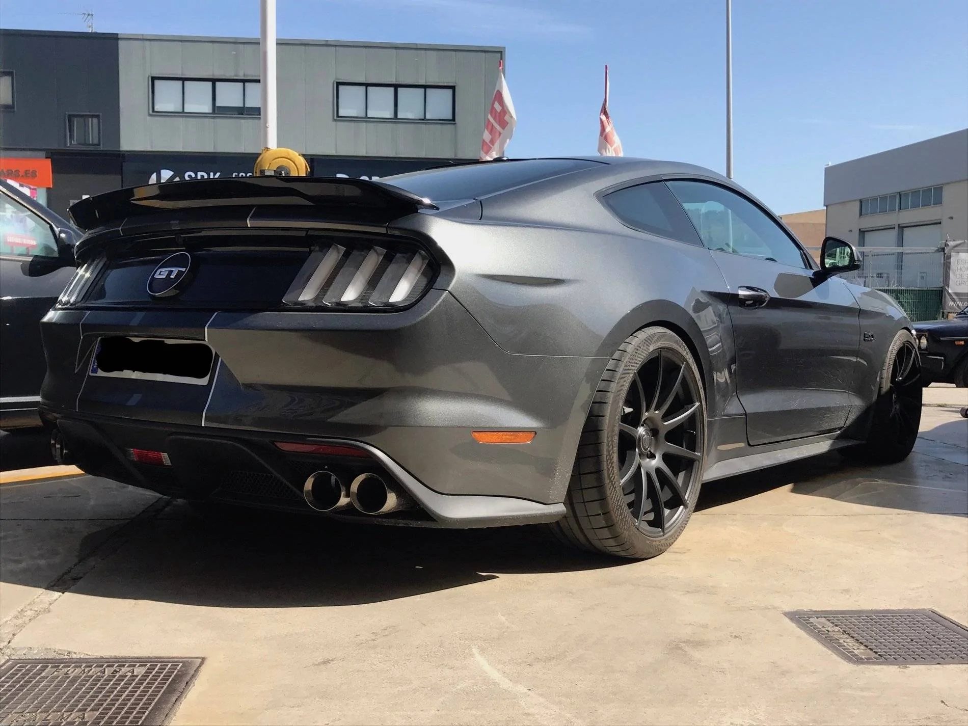

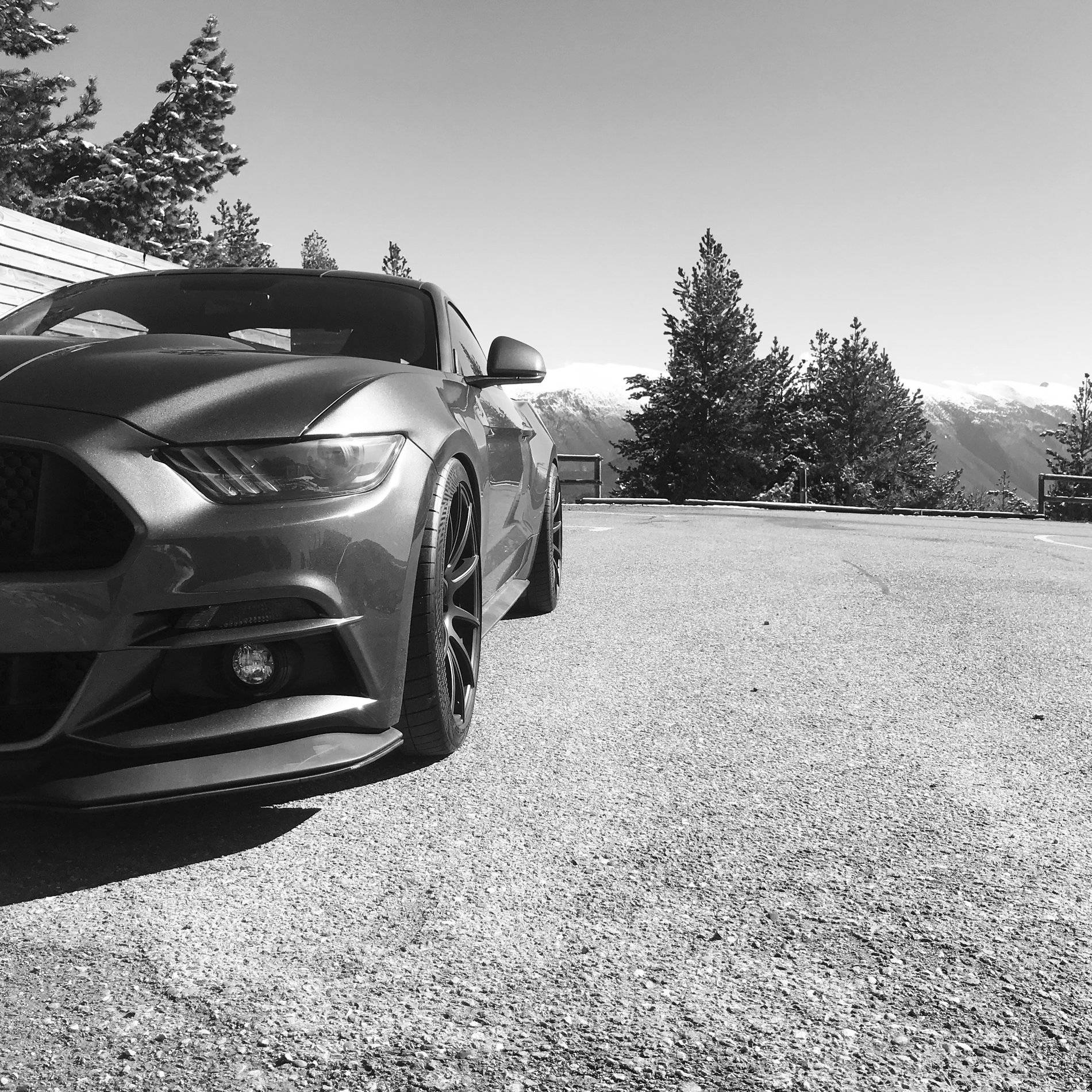

Didn't realise i hadn't posted here yet.
Forgestar CF10, 20x11 et30 front and et45 rear, with 305/30 Vredestein Ultrac Vorti R on all four corners

I'm currently running 305/30 on all 4 corners, but you have convinced me to trade up to 315/30, they look awesome on an 11 inch wheel!! Have you got any more pics?

Hey I tried to run a similar combo no dice up front rub city with H&R super sport springs. Can I ask what your running for lowering springs. I ended up having to run a 285/30/20 tire

Im running KW V3 coilovers. No rub, and tire sits about 5mm from the strut.
