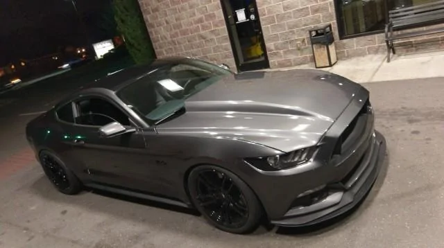

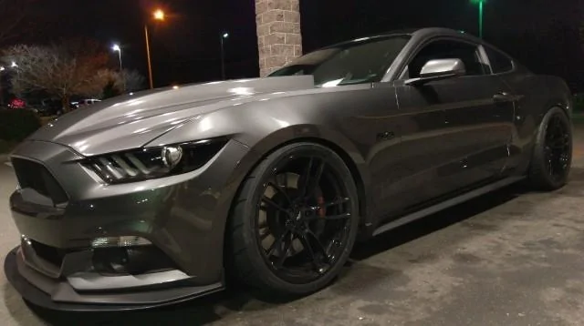

20x10 & 11. Toyo R888r tires 285 & 315. Steeda springs, struts.
Thanks buddy!
Looking great
I have the same wheels sizes on order but I will be running a bit milder than you on the tire side of things aiming for 275/305 (315 is tempting though)

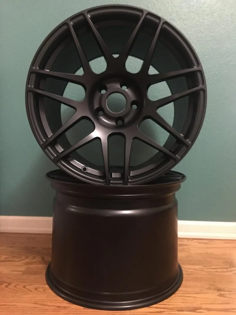

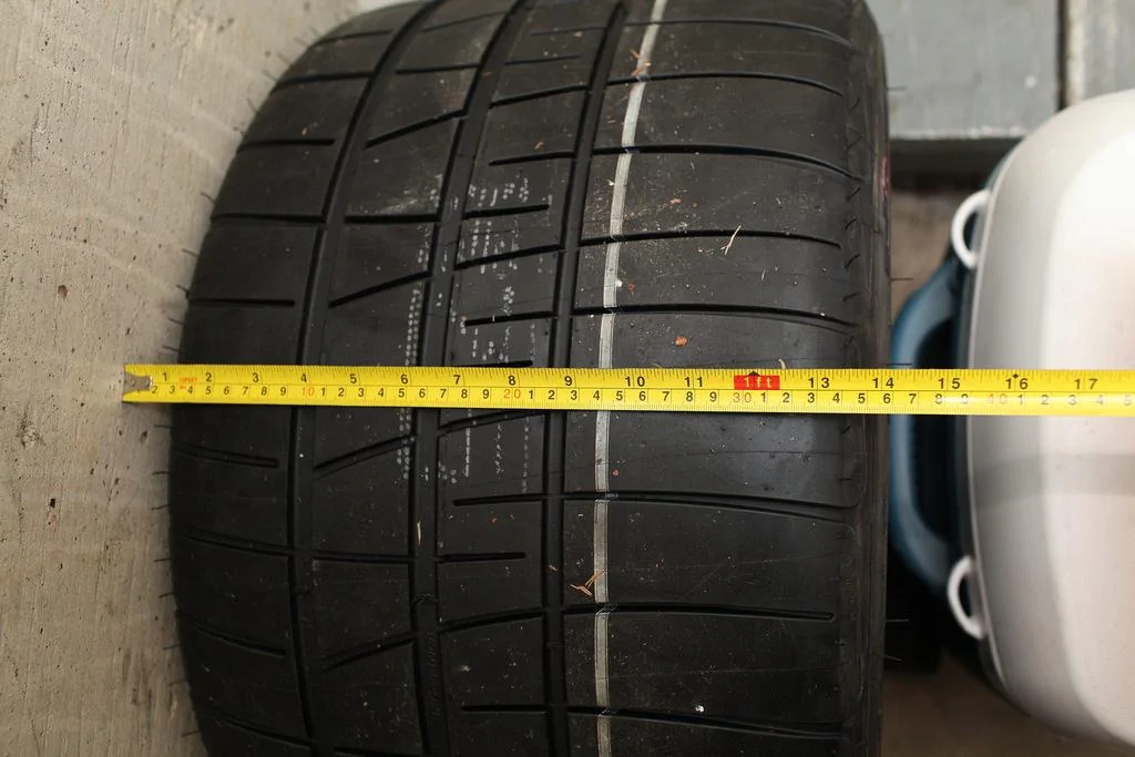

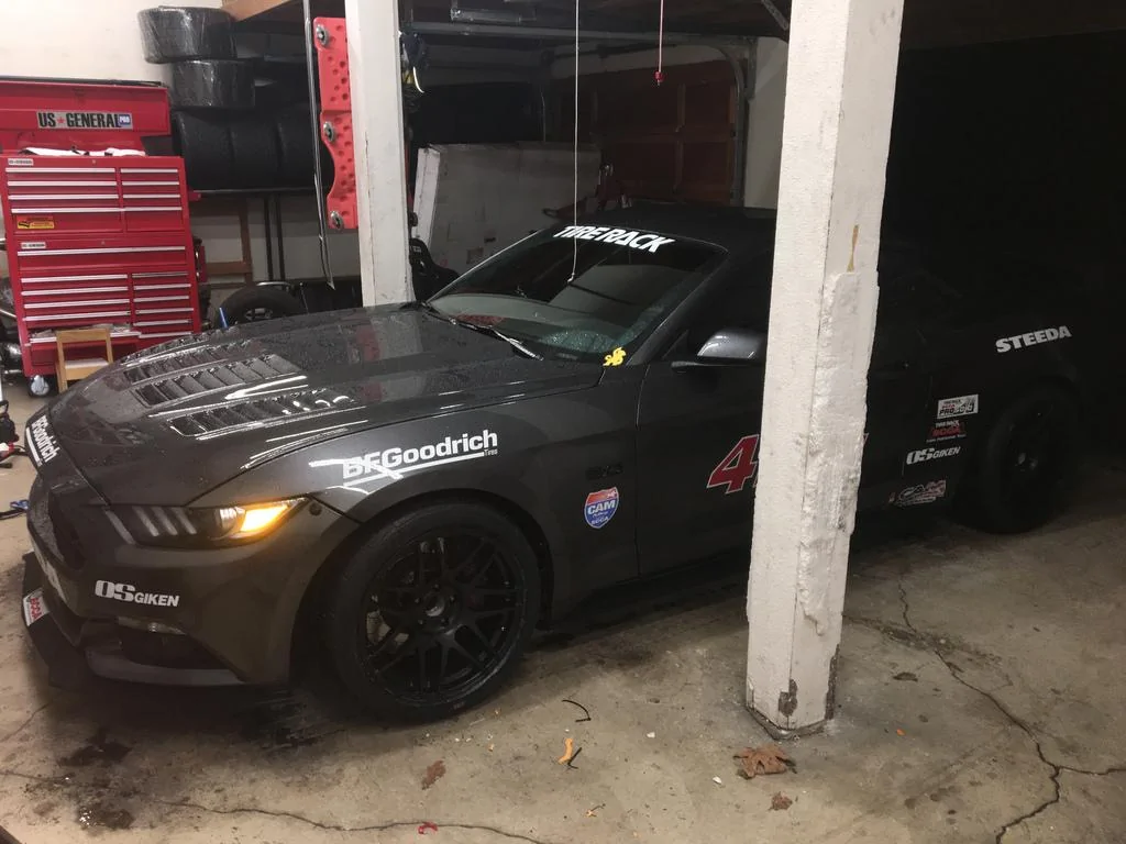

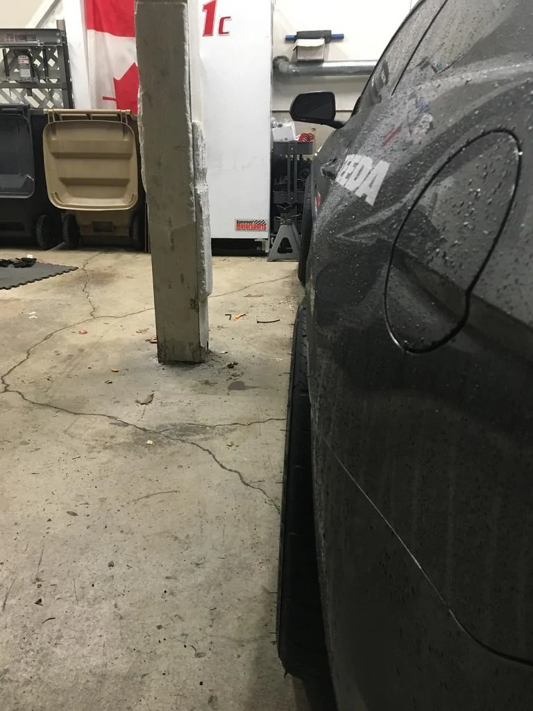

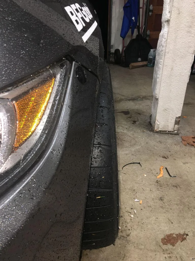

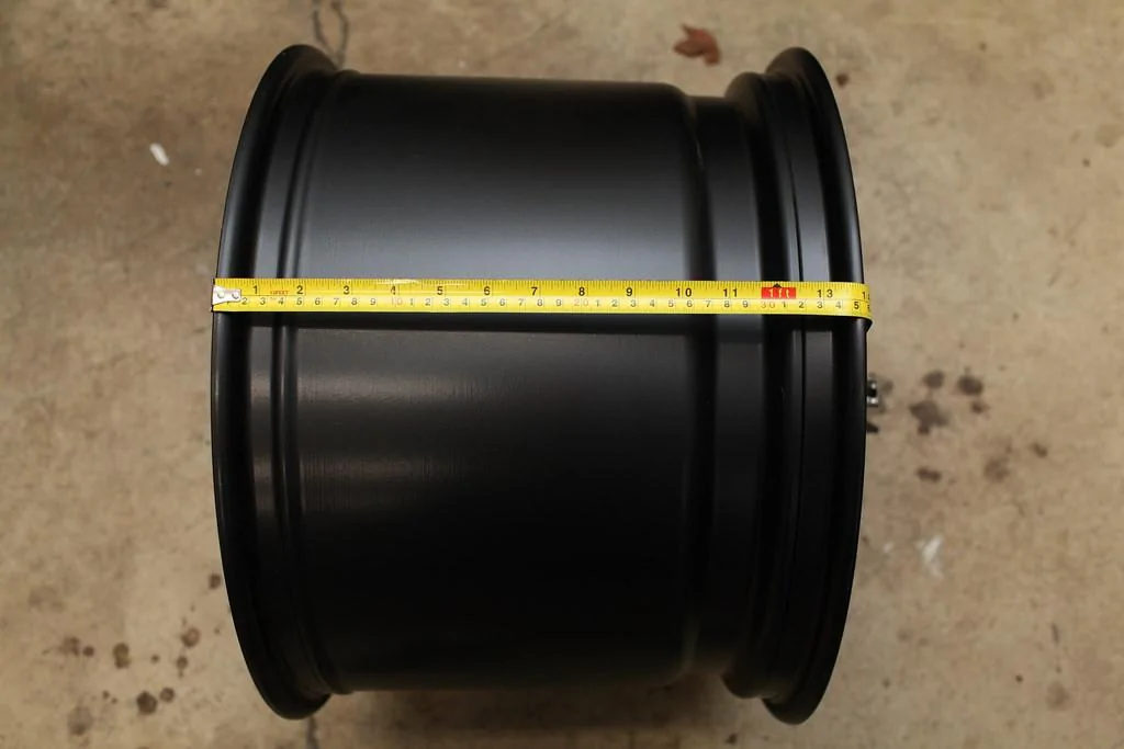

old and busted setup: 18x12/335. square.
new hawtness: 18x13/335. square.
stealthy potato quality pics for your pleasure. you'll be seeing legit competition shots of my car with this setup in the very near future, stay tuned :)

Good lord I'm into this. I'm a child and don't understand suspension dynamics, but how does this thing not rub?

Your rear quarter panels are going to hate you.

check my build thread for some additional information. tl;dr it's not a bolt on and go setup :)
nah - moved from an 18x12/335 combo (that didn't rub) and put almost all the additional width inboard with some creative parts relocation. fenders are rolled and pulled too. i've still got a little bit of room outboard at full compression, if you measure in mm ;)

:eyebulge::headbang: So much awesome happening there!

I was talking about sand/rock rash.
