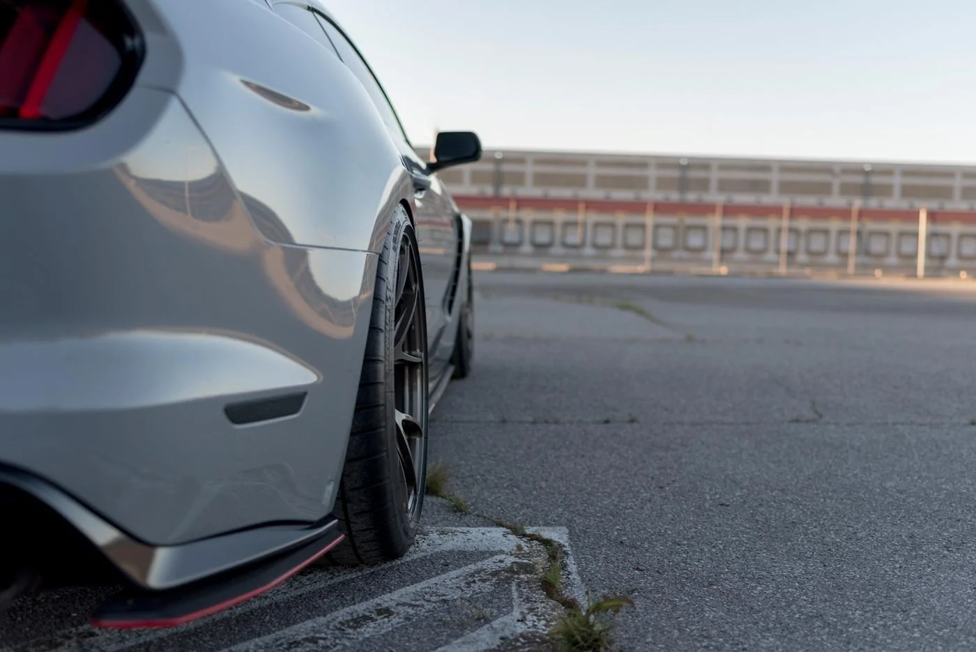

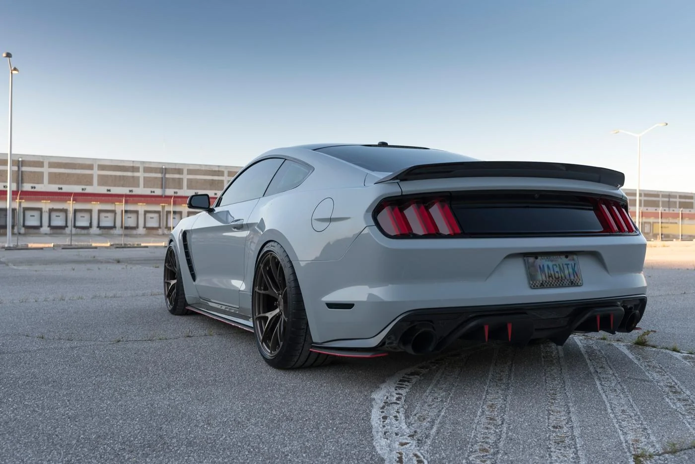

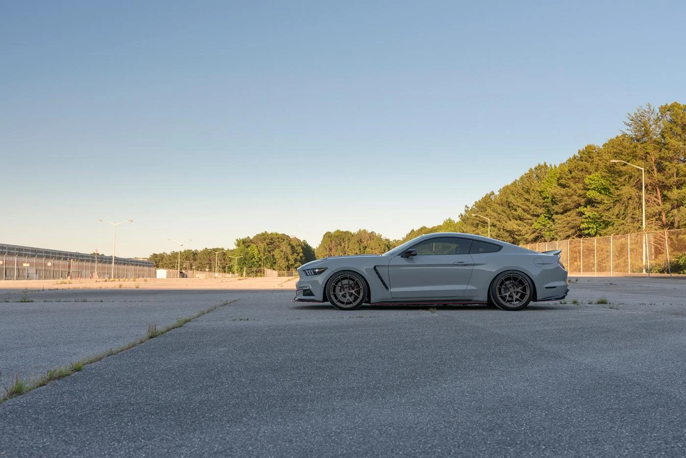

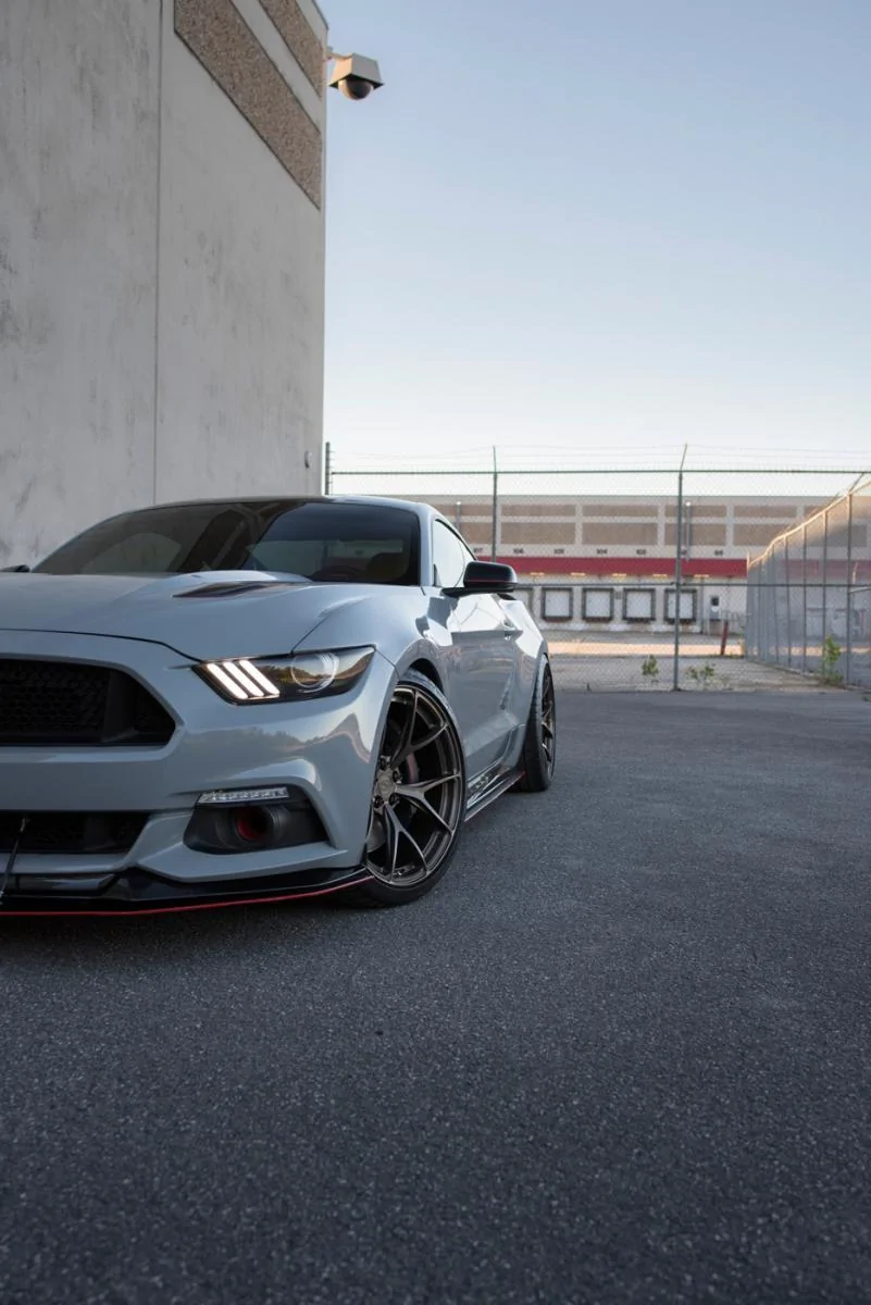

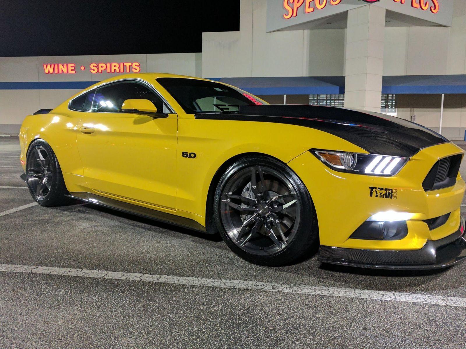

Wanted to share my setup as all the above info helped me in my process would like to contribute back.
Signature Wheel sv104
20x10 et25 mpss 285/30
20x11 et45 mpss 305/30
Steeda Ultralite Linears and Steeda pro-action adjustable shocks
DB83
Granny Shifter

Thank you
Congratulations Chris. You win. Is that a tape on the trim? If so what width please.
Thanks, yes it's Avery red reflective tape 1/4" on the lower trim
Wow, that looks incredible. Do those front fenders allow you to run more tire width?
Thank You. Yes anderson advertises 0.4" or ~1cm but it might be less if your really low because of the "rolled" portion isn't as rolled/folded like the factory it's more "v" like if that makes an sense but does allow more room for sure. Also i have the steeda struts which allow some more room inboard aswell

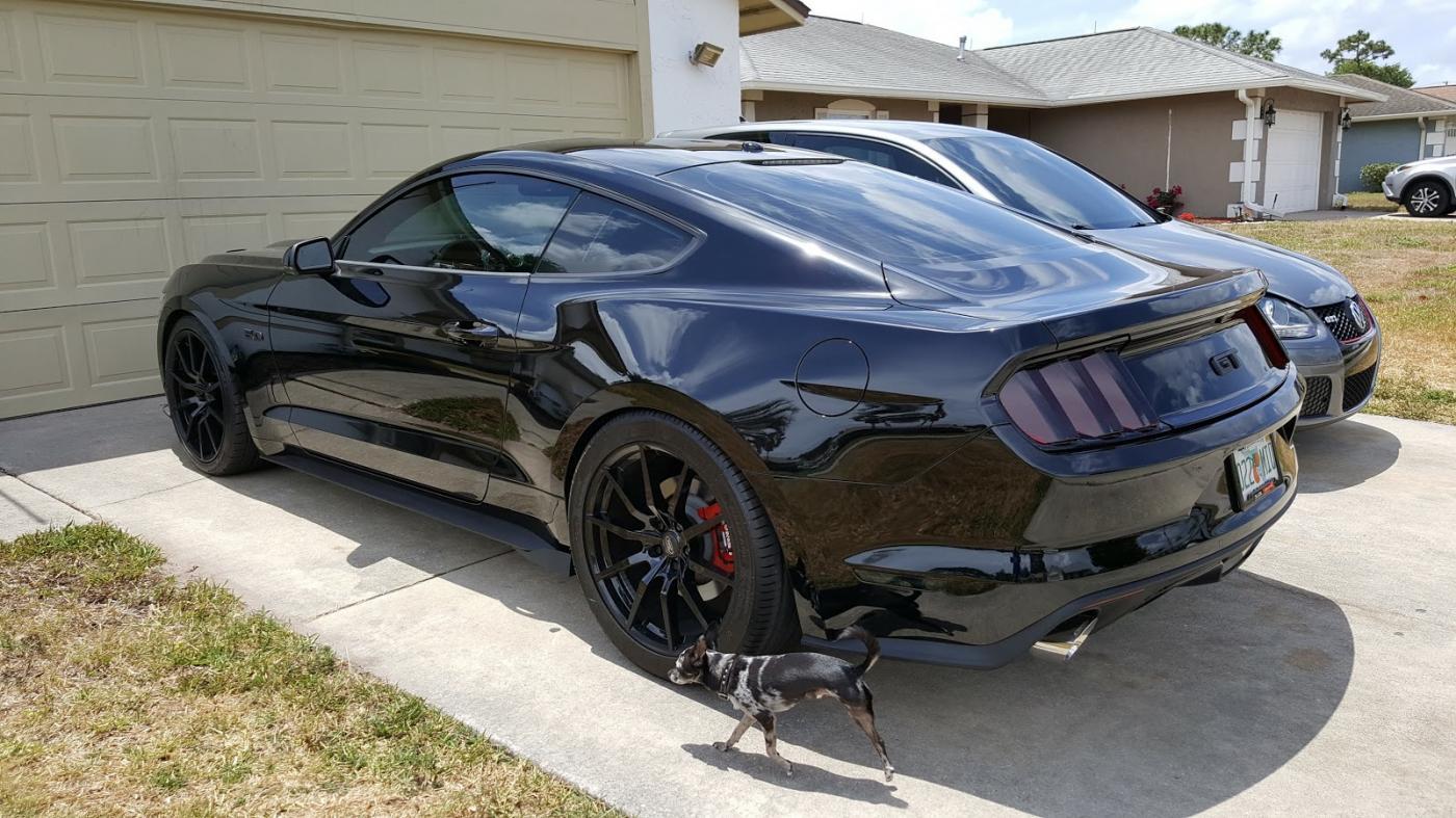

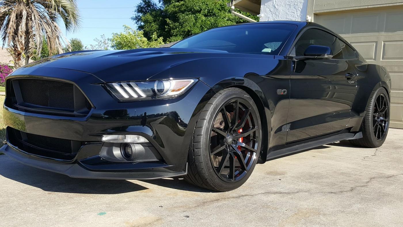

2016 Black Mustang GT PP

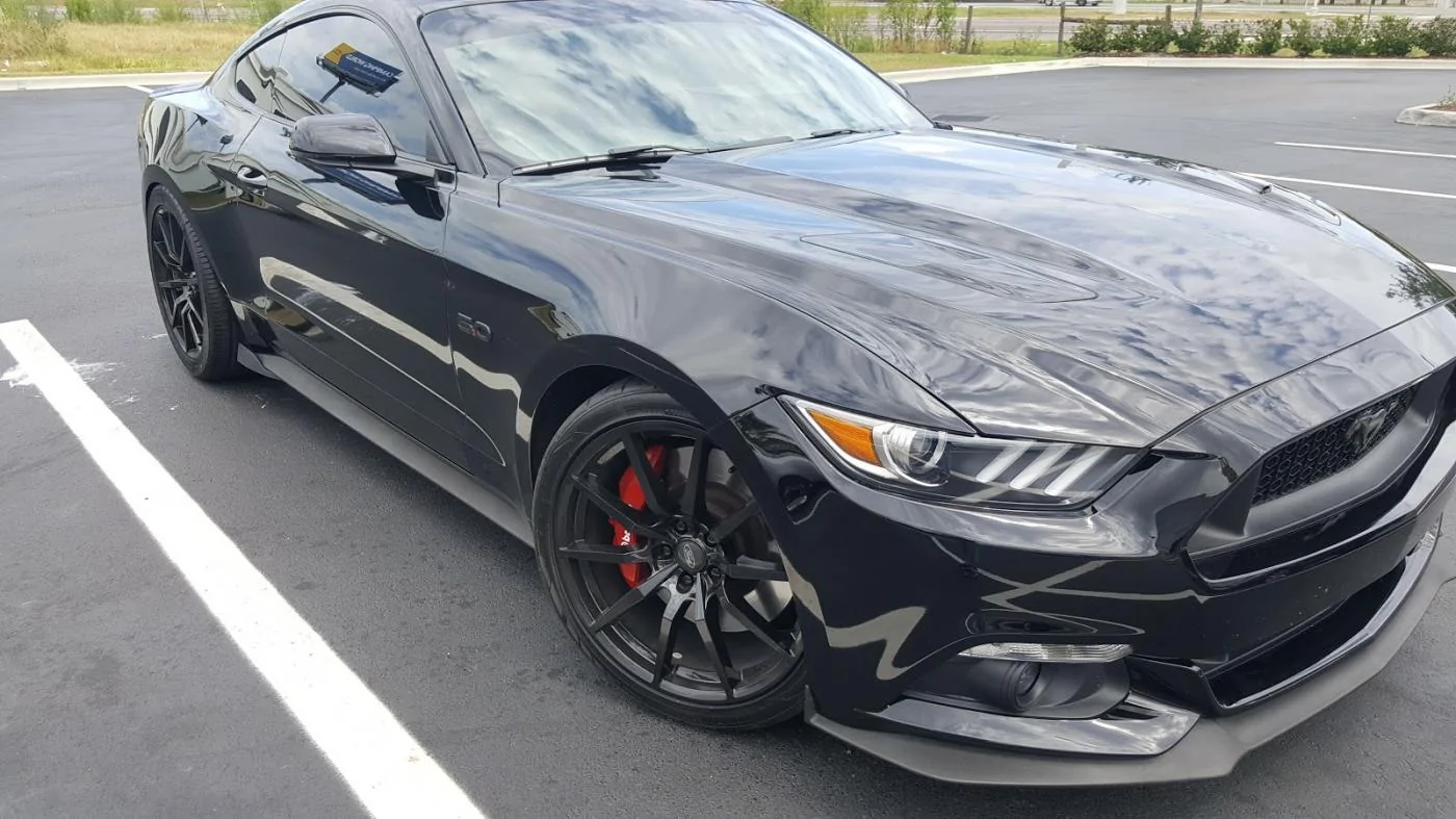

MMR GT350 20x10
MMR GT350 Front: 20 x 10 with 275/35/20. Rear: 20 x 10 with 315/35/20
on Steeda Progressives
bobbyh
Apr 17, 2014
293
56
NE Ohio
2015 Mustang GT
Great looking set-up.
1) Do the rear wheels rub at all on top?
2) Is that a 3-legged dog (cat maybe?)in the last photo? :D
shelbywannabe
Dec 3, 2015
1,526
314
Orlando FL
Robert
No rub at all. I have 11 inch Forgestars with the same size rear tire and no rub with those either
Yes thats Rocco my tripod buddy, great companion. He loves hanging out with me while I work on the car

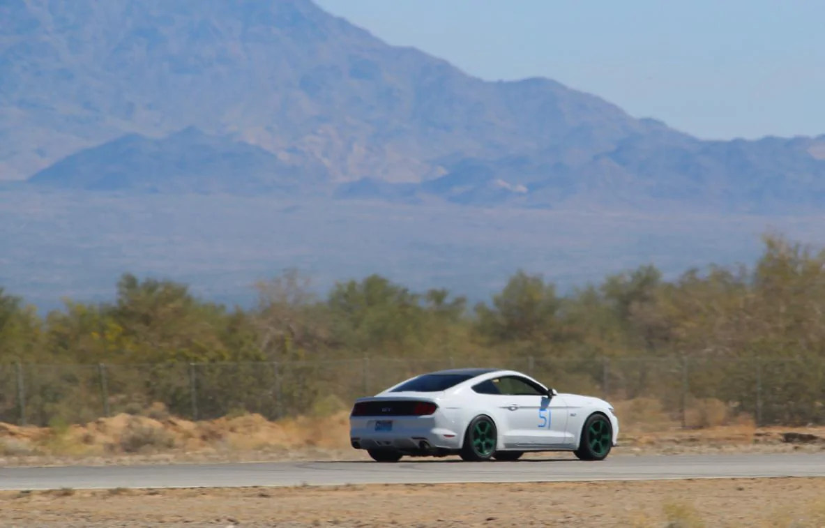

c_reber
REB3R
Oct 30, 2014
30
536
161
LV, NV

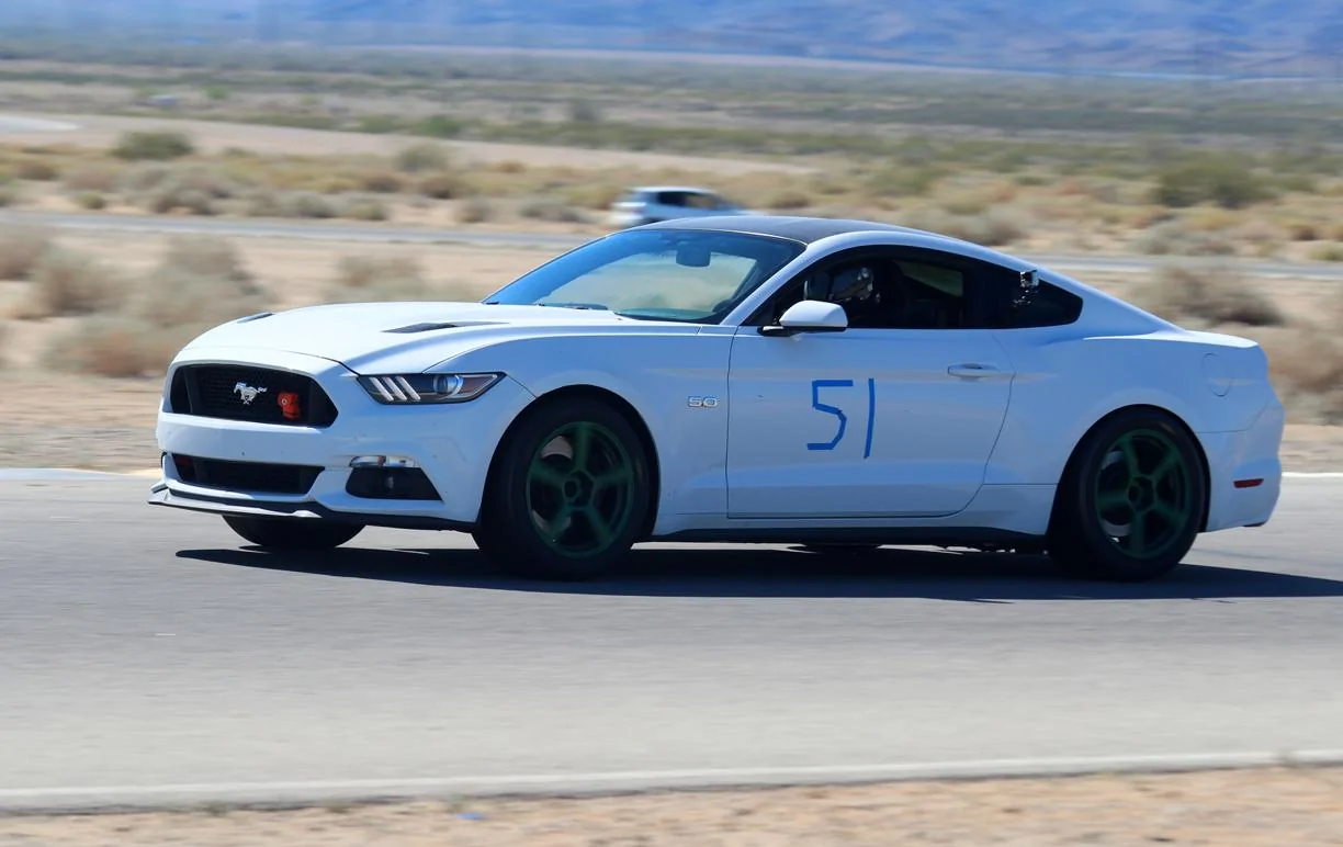

Chris
`16 Mustang GT (PP), `15 X5 50i
TSW Panorama RF 18x10.5 +27. Pirelli DH slick tires 305/680/18. Rubbed a little on the fender (chipped the paint a bit on the front :doh: ).
