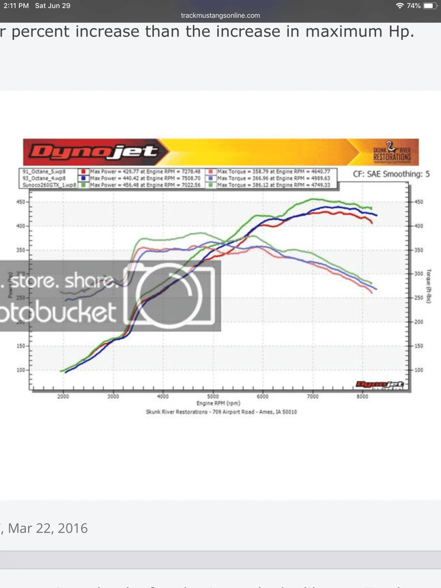

There was a rumor floating around that the GT350 computers are actually tuned up to 98 octane. Based on a thread some time ago where a guy dynoed 93 vs either 98 or 100 back to back and the car picked up like 20 rwhp just from the octane increase.

Looks like there’s some data to back up your statement, found this on another board. 16 rwhp and 20 rwtq from 93 to 98 octane. You might pick up even more since E85 cools it a little. The 98 octane graph looks a little less smooth and makes peak at lower rpm but I would assume that’s just the car adjusting the timing to a point it’s never been before. Excited to see more data on the Proflex. If you guys have a tuner try data logging before and after and we’ll look at the timing and Lambda throughout the rpm.

yep race gas/torco will make power on a stock pcm because it can leverage the extra octane in the fuel.
That is why folks are making power with the AFD kits, many other vehicles you may not make much. Can't wait to try it myself but still waiting on a shipping notice.
