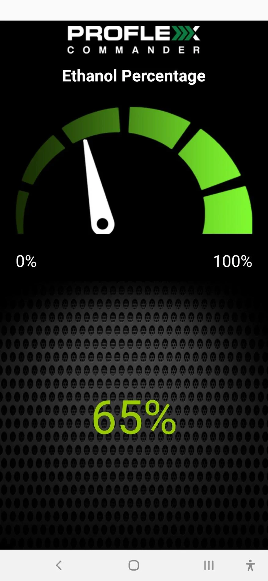

app showed...
i went with 20% 91 octane left in tank. i filled up to fill with e85, so about 80% e85. that came to 65% ethanol content after driving around for 15 mins.
note: the app has a glitch right now and i dont know when they will have a fix. you cannot see e% while engine is running; you have to turn off the engine but power on.
havent tried cold start yet. here in so-cal we dont get freezing weather so it should be ok for me overall. use some more regular 91-93 octane gas when the weather gets really cold. but even in our weather today of 85 degrees, the starting was slightly more rough.
