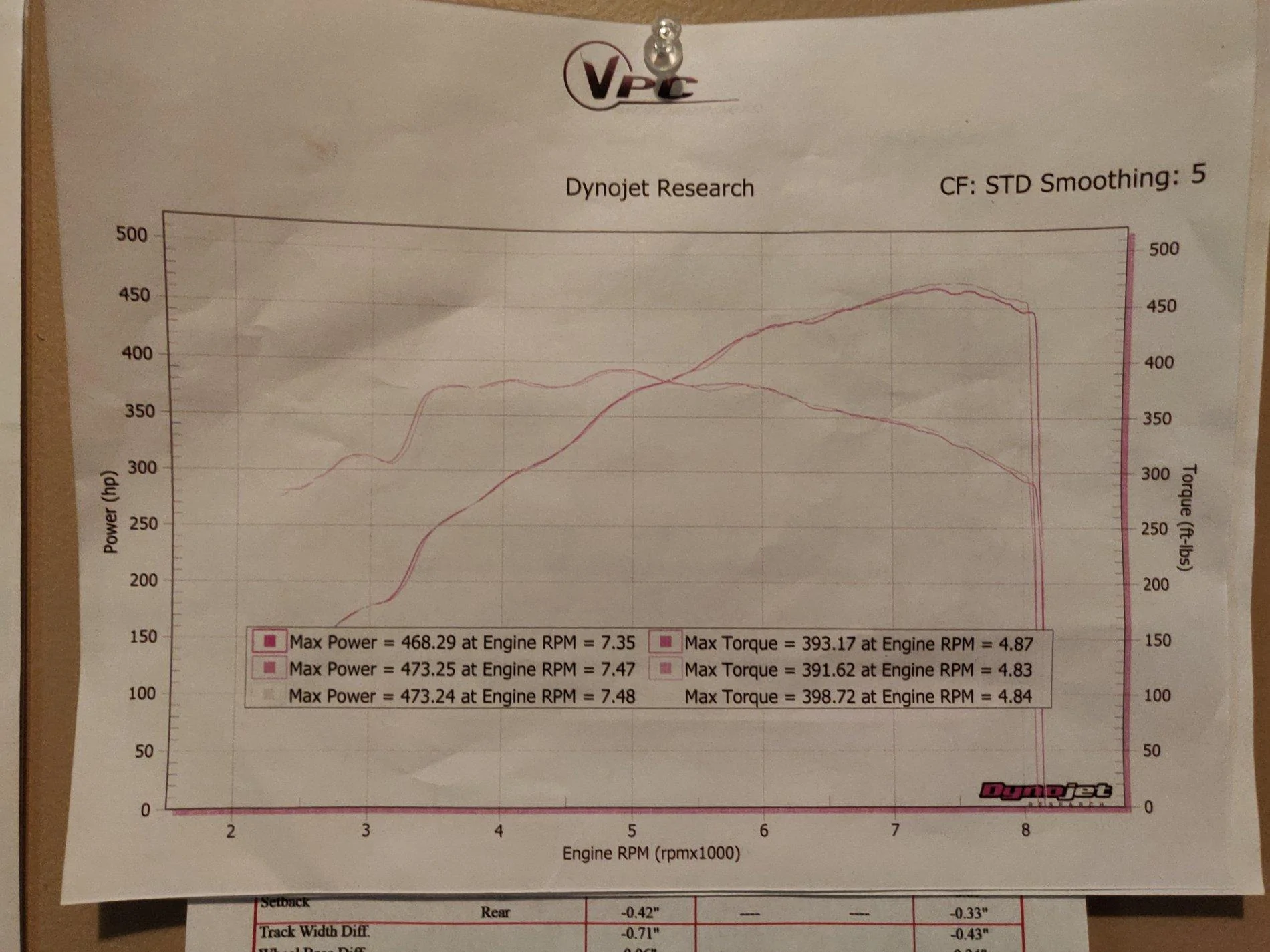

Just to add, had mine for about 2 month and love it. No issues, I also had my gt350 dynode. To add my e85 percentage was 68%. I found a better pump with 72% but not sure it will make much difference.

Sasha, your smoothing is set on STD, so SAE power thats just right around 460hp. So Is that dyno run WITH e85 or 93? Doesn't seem to have made any additional power, atleast compared to my baseline run.

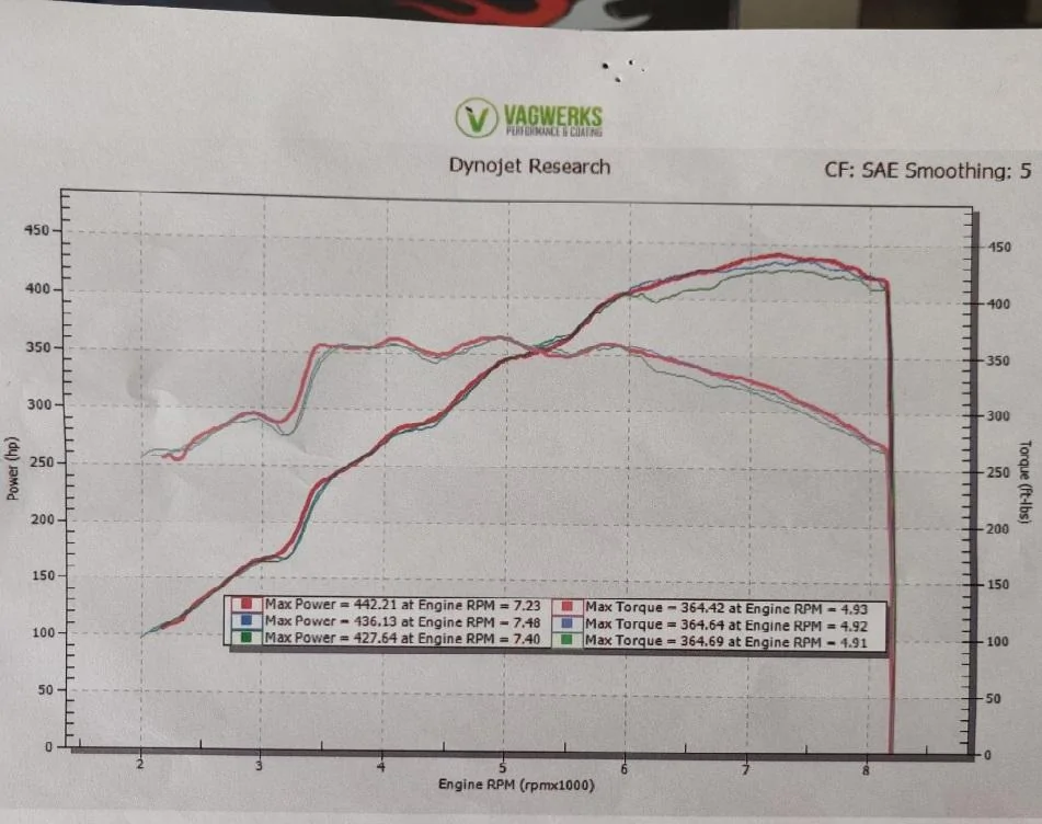

I probably should have explained it better, my fault. It is e85 with 68% percent ethanol. It actually did make power, I should have posted my baseline dyno pull. Also to note it was the same dyno and the weather is almost the same. So you were probably right that it made 460 hp but compared to base run I made some power.

Nice! Thanks for posting the baseline. How did you feel about the overall drive ability not doing WOT?
